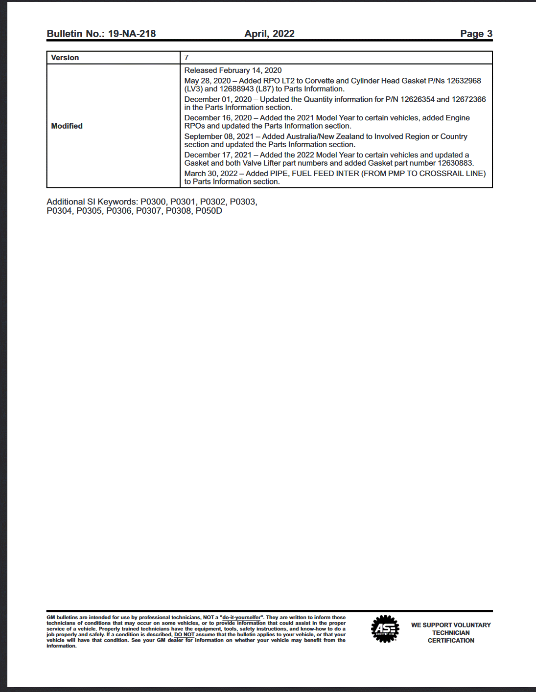

Yup. Right at 9:19 in the video. They call it a memo, then later a bulletin - dated June 1. I could not find the bulletin. But they say this particular issue is noticed at cold starts - first initial start. So it does not sound like what the OP describes which is later and occurs at specific RPMs while driving. I did find a very similar bulletin dated April 2022, that seems to describe what they said in the video - almost exactly the same verbiage: "Some customers may comment that they hear a ticking noise coming from the engine when cold.⇒ This ticking noise will mainly occur during the first initial start in the morning." And it lists the same cars up to 2022. Maybe there is a revision to it that has later date that covers up to 2023.
