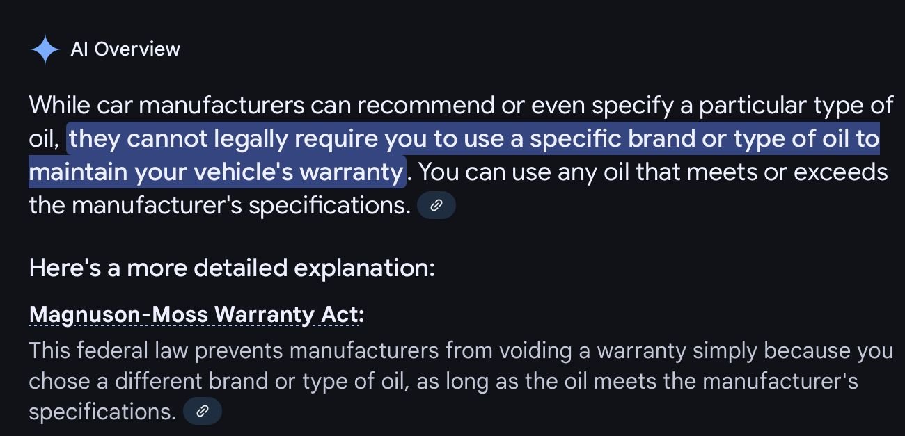

Meeting or exceeding the manufacture's specifications are the key words in the above statement. As far as I know, the Valvoline DCT fluid doesn't claim it meets the FFL-4 specification (whatever that is), it says it is recommended for use where FFL-4 fluid is required.
I once used combination GL4/GL5 gear oil in a transaxle that required GL4 oil. The manufacturer said it was suitable for both GL4 and GL5 applications. My gears immediately started grinding during shifts. I switched back to a straight GL4 gear oil and my problems went away.
Personally I hope people continue to have success with the Valvoline DCT fluid. I think it is quite likely going to be a good alternative and I'll possibly use it in the future after any concerns about warranty are over. But I'm waiting to see the long term results to make sure there aren't any nuances with the Tremec DCT.

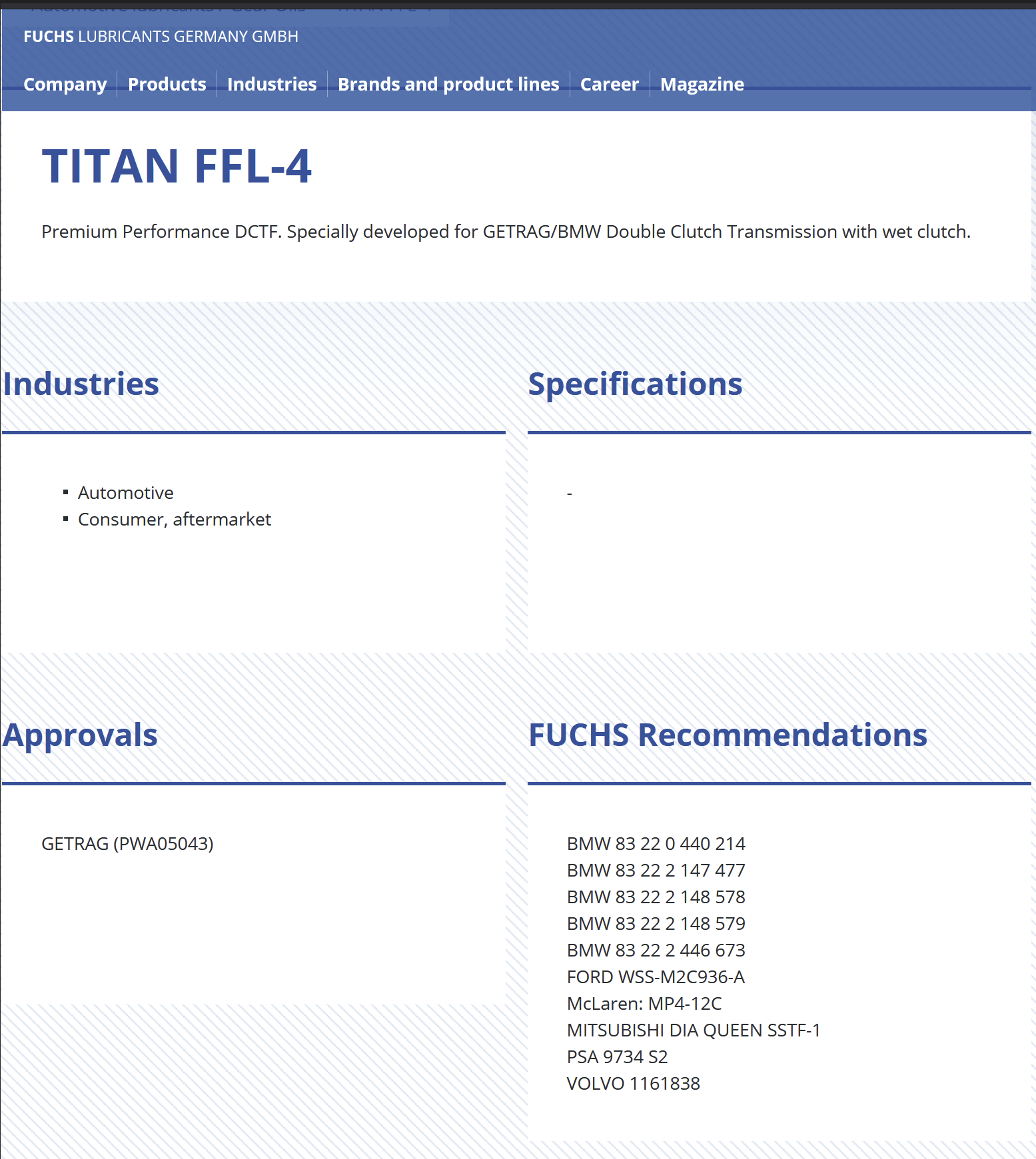

TITAN FFL-4 (Formerly PENTOSIN FFL-4) Premium Performance DCTF. Specially developed for GETRAG/BMW Double Clutch Transmission with wet clutch
is also made by FUCHS that makes ACDELCO one GM use

The Fuchs Titan FFL-4 product is listed by Fuch as having approvals by Getrag - but it never lists anything that say "meets FFL-4 specification". In fact, Fuchs lists approvals and recommendations but does not indicate any specifications that it meets. ......But when we see Valvoline, or Amsoil or other makes indicate that the fluid is recommended where FFL-4 is indicated, where is the specification for that product, and what agency evaluates the fluid against that spec to verify its compliance. I'm not saying those products are bad, only that the recommendation for use in the C8 is coming from the maker's own test of their product against some criteria - perhaps obtained by analysis of the Fuchs product, or .....?
Originally Posted by gsvette
.....See below for both Valvoline and Pentosin specs.....they are nearly identical.
I will say again that there is nothing mechanically "special" about any aspect of any Corvette that requires a "special" lubricant. The same applies to any consumer transportation vehicle.
Sure. I never said anything about special lubricant" or special mechanical features. Like you said " the lubricants and fluids used were spec’d from existing supplier products," and not an FFL-4 specification. I never said there is anything wrong with the Valvoline product. My issue is with the suggestion that any "FFL-4 fluid type" fluid type will be satisfactory, because FFL-4 is not really a specification. As you stated, Tremec recommends a specific brand of fluid. Depending on where you look, you can find Fuchs Titan FFL-4 and Pentosin FFL-4 listed by Tremec for that transmission. Depending on where you look in GM literature, you can find the same things - Pentosin FFL-4, Fuchs Titan FFL-4 (in the service manual), and you can find Declo DCTF FFL-4 listed in a GM tech link article. They are listing specific products. What you will not find is a statement saying "use a dual clutch transmission fluid that meets the requirement of FFL-4", because FFL-4 is not a specification. The owners manual does not even list or recommend a fluid, and never says "use an FFL-4 fluid type". It says see your dealer.
So, when one selects a fluid to put into their C8 transmission, how does one decide that a different brand from those listed is acceptable, equivalent, or even better? Its not because the name of the product has FFL-4 in it. Its because you have confidence in the reputation of the manufacturer, and its based on the manufacturer saying that their product is suitable for that a application. The Valvoline product is great example. It does not even have the term FFL-4 in its name. The way you know its ok to use is because the manufacturer says that FFL-4 is a "recommended application" in the product data sheet. You can also go on the Valvoline web site, and their product finder will recommend using their Dual Clutch Transmission Fluid in the C8. But it never says it meets or exceed an FFL-4 specification, because there isn't one.
The Amsoil Dual Clutch Transmission Fluid is similar- it does not have FFL-4 in its name - their product data sheet under "applications" lists "Pentosin* FFL-2, FFL-3, FFL-4", the specific product, but never says meets or exceed the requirements of FFL-4 specification, because there isn't one. And, if you use their product finder, it will recommend using it in the C8. Do you trust that recommendation? Some do, some don't. If you use it, you are basing that choice on the manufacturer's recommendation.
How about the Amalie "Universal Dual Clutch Transmission Fluid"? They don't have FFL-4 in the name. Their product finder recommends that for the C8. Under recommended applications, it says GM DCTF FFL-4. Anyone using it? Not saying its bad - only that if you use it, its based on the manufacturer's recommended applications.
https://www.amalie.com/wp-content/up...Sell_Sheet.pdf
Also, Product Data Sheets are not specifications- they include a list of test results for selected parameters. The specification for a lubricant is much more than a list of several parameters found in a PDS. PDS's also include, generally, recommended applications where they may list OEM specs, approvals (such as from Porsche, Mercedes, Ford, whatever), and specifications actually met. The Valvoline PDS has a long list of applications, but no approvals and no specifications. Amsoil is the same way. Even the Fuchs Titan FFL-4 PDS lists no specification met. It lists one approval from Getrag. And a long list of applications. But in the case of that product, its recommended by name in Tremec and GM documents (and it also recommended by name in the Maserati MC20 Owner's Manual - that uses the same TREMEC transmission) . The Delco DCTF FFL-4 product also does not list any specifications met.
Bottom line, if you choose to use Dual Clutch Transmission Fluid in your C8, other than those recommended by product name in Tremec, or GM documents, it is based on the recommendation of the manufacturer of the lubricant, and your trust in that manufacturer.
