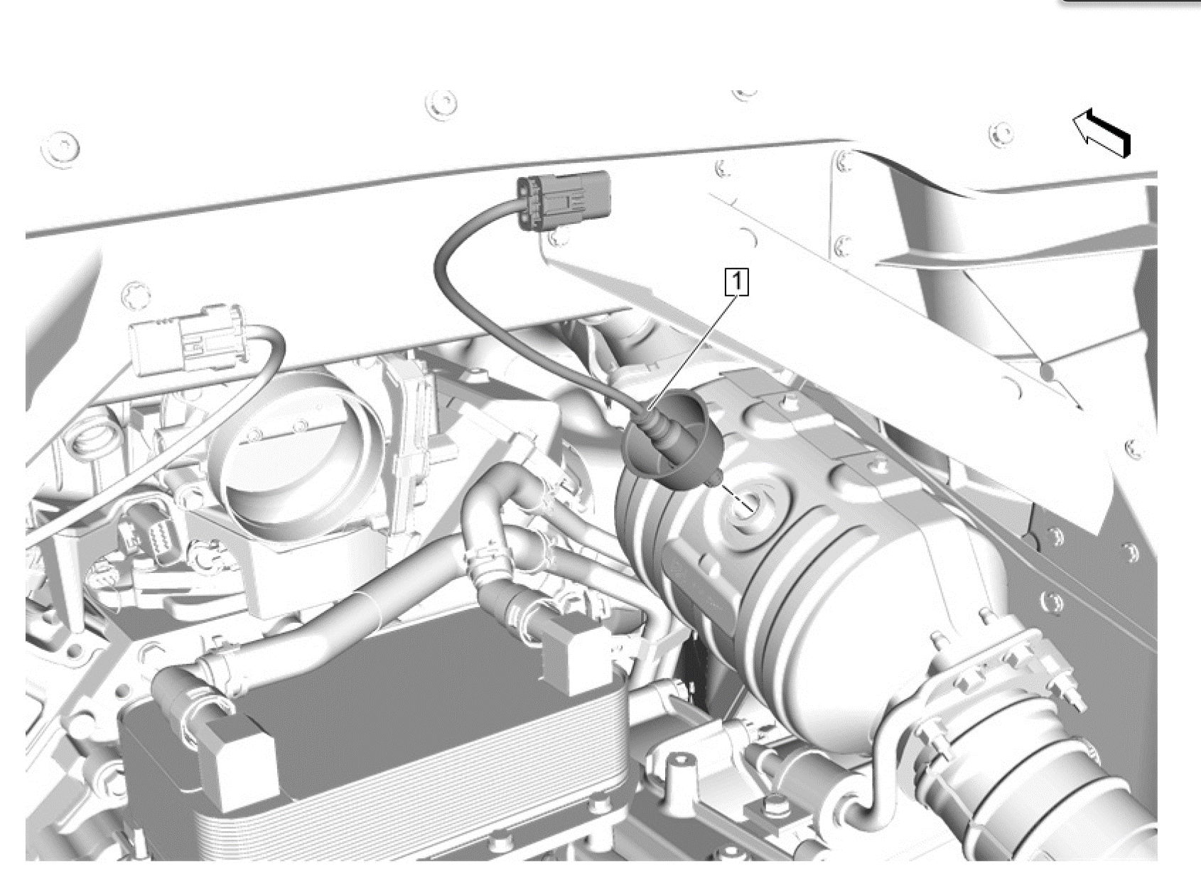

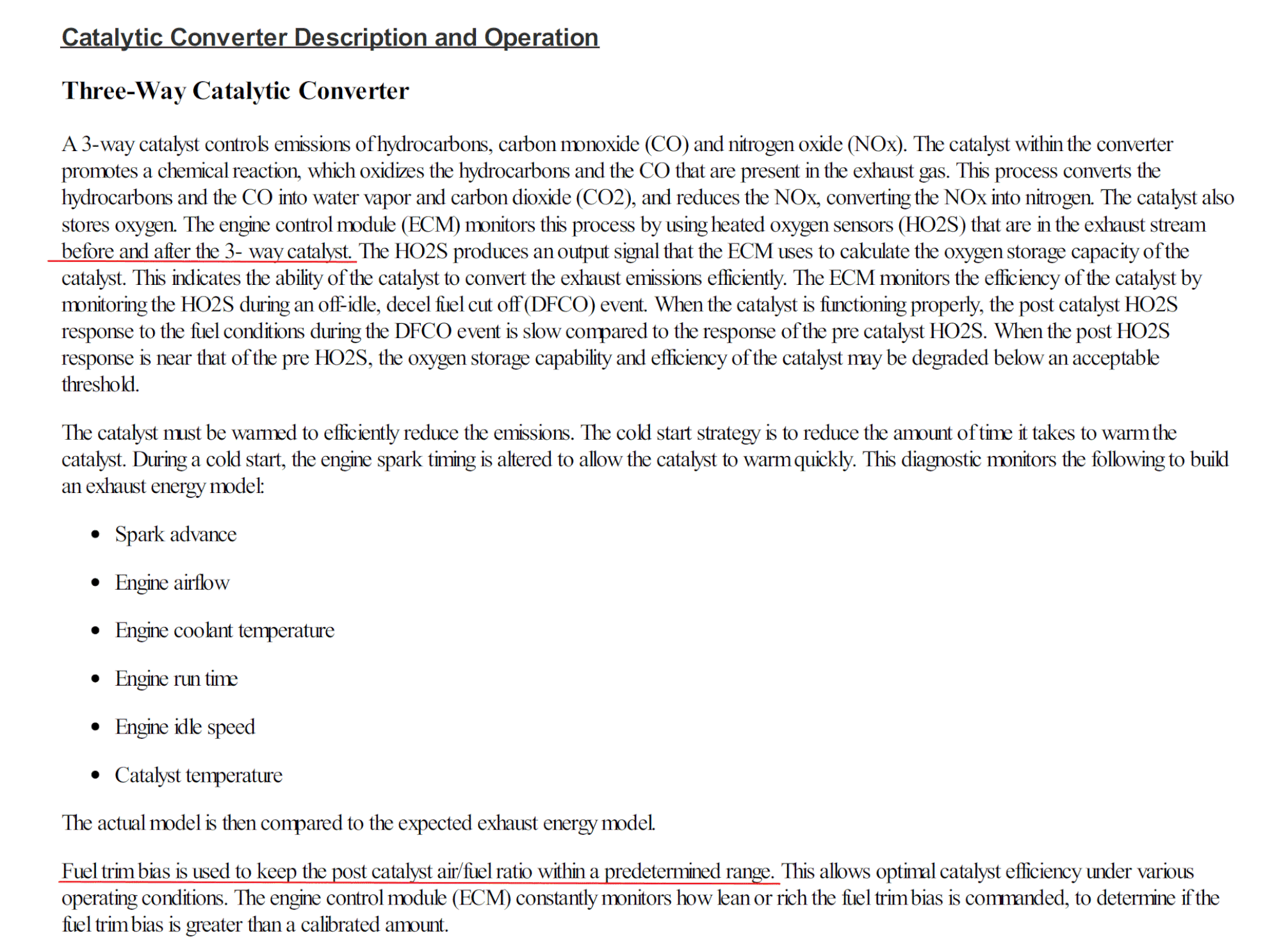

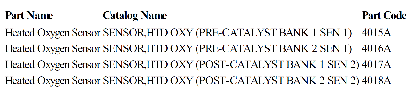

Here is what the Service Manual says about that. There are four heated oxygen sensors. Bank 1, Sensor 1 and Bank 2, Sensor 1 which are upstream from the catalytic converters, and Bank 1 Sensor 2 and Bank 2 Sensor 2 which are mounted at the Catalytic Converter, but described as "post catalyst". The description of how the ECM manages the catalytic converter operation appears to say that it monitors the heated oxygen sensor before and after the catalyst. And it adjusts fuel trim to keep the post catalyst air/fuel ratio within a predetermined range. This could be the basis for the dealers statement to you. It does not specifically say exactly how each O2 sensor measurement is used in calculating the fuel trim bias, but it does say the ECM measures all of them as part of the process for managing the operation of the catalytic converter. I have no comment on whether or not that could affect a warranty claim - other than I think there is some risk, should an engine issue arise.
