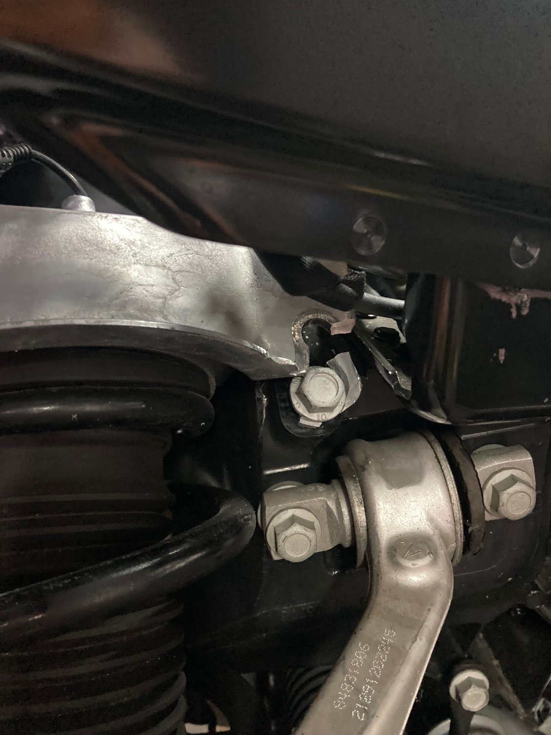

Old Jul 10, 2023 | 03:02 PM
ejs2283's Avatar
ejs2283
3rd Gear
Joined: Jul 2023
Posts: 3
Default Here is a photo
Here is a photo of the failure
Here is the failure
Old Jul 10, 2023 | 03:15 PM
ejs2283's Avatar
ejs2283
3rd Gear
Joined: Jul 2023
Posts: 3
Default More pics of shock tower failure
Different views
Old Jul 10, 2023 | 04:11 PM
Racer X's Avatar
Racer X
Joined: Jul 2000
Posts: 6,559
Likes: 4,501
From: North Dallas 40 TX
I have not seen a failure like that without an impact, like a curb, or pot hole. Was their wheel damage as well. It looks like the shock or spring would have to stack solid to do that.
Old Jul 10, 2023 | 05:10 PM
BADBIRDCAGE's Avatar
BADBIRDCAGE
Joined: Feb 2004
Posts: 11,039
Likes: 2,592
From: Del Boca Vista FL
That’s a definite shear. Something caused a massive impact load to do that.
To front shoch tower failure
Old Jul 10, 2023 | 07:05 PM
X25's Avatar
X25
Sr.Random input generator
Joined: Jan 2008
Posts: 7,803
Likes: 2,232
From: Sammamish, WA
Looks like an easy fix. Something will always fail first after a high impact, and glad to see that cheap hat fails before the chassis/frame mount!
Old Jul 10, 2023 | 08:24 PM
Guard Dad's Avatar
Guard Dad
Joined: Nov 2013
Posts: 1,528
Likes: 495
From: Southern California
If there was no large impact maybe a defective casting.
Old Jul 10, 2023 | 10:06 PM
Mitchell_B's Avatar
Mitchell_B
Joined: Feb 2023
Posts: 1,362
Likes: 1,129
This is not the first such failure.
