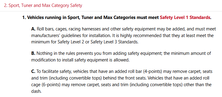

im trying to do some scca time trials this year in sport 1. Do they allow a c8 to add a front seat bar? I’m new to road course. I don’t know how to interpret the rules.
Sorry you're not finding the rules easy to follow.
1.A. - "other safety equipment may be added..."
