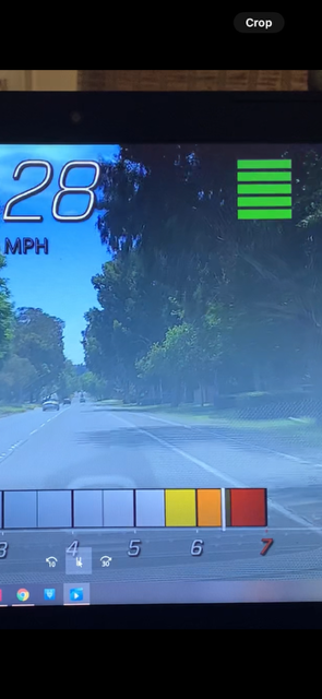

Hello ....hope I am posting properly. My c8 developed a hesitation on launch which takes approximately half a second off of a normal time of 2.8 or 2.9 seconds.
When reviewing PDR you can see and hear on bad shift the engine goes over the red line about 200 rpm were as a normal shift it is just below the redline about 100-150 rpm
Chevrolet can't find anything wrong. 2 dealers and 2 different "TECT" guys came out and said everything normal so therefore I am imaging the hesitation, BULL !!
yet they see it going over the redline and hitting rev limiter for a split second. GM is involved again and I told them I want someone in the Corvette dept. or team to review the images
videos and then tell me nothing is wrong even though they see it and hear it hesitate.

the first time I took it to the dealer they had 2 specialist "TACK"?? come out and they drove it for about 50 minutes according to my chevy app and it showed where they drove it. However they shut off the PDR.
They found nothing.
The second dealer I drove the car with the TACK technician and he did have the computer hooked up and took data while I did 2 launches and one was bad and one was "ok" but not perfect like before this
all started. He did his magic on the engine and they told me to drive it 8 cycles but nothing changed. I now have an active case but I have told GM that I will not bring it to the dealer as their mechanics do the same thing and say the same thing so I have insisted they send the 2 videos from my PDR to someone in the corvette engineering dept and give me an explanation to the obvious over revving and the hesitation you can hear.
I have played it non mechanics and my friends who know nothing about mechanics and they definitely hear a hesitation and a "manual transmission like shift"
