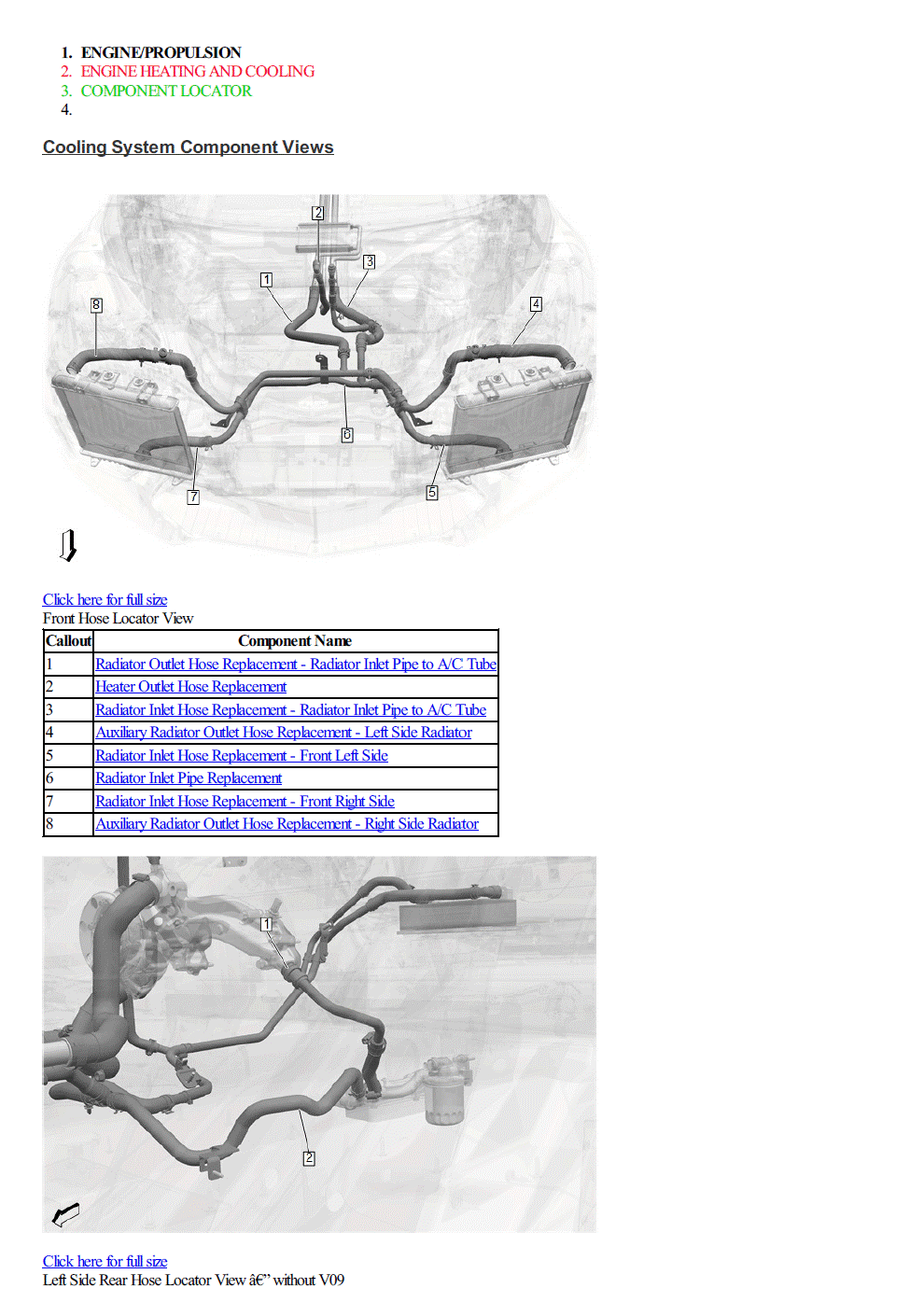

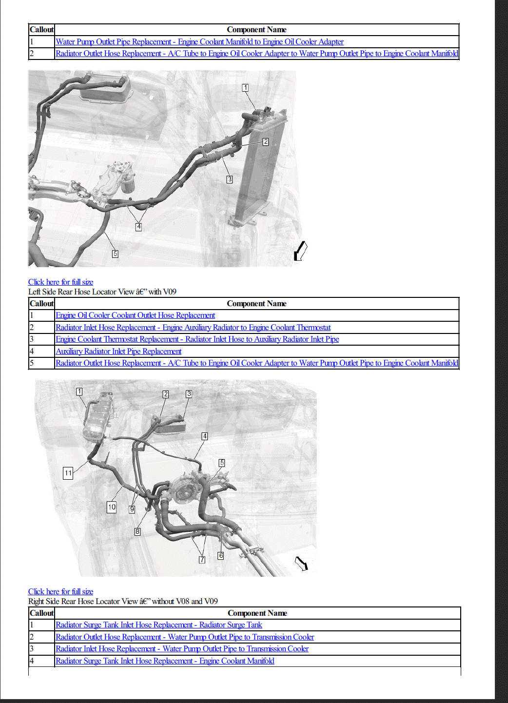

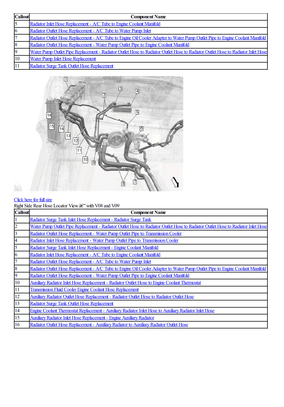

Anybody have a diagram of the Z51 cooling system Radiators, Fans, hoses etc?
Thanks in advance.

Old Sep 4, 2023 | 09:30 AM
Andybump's Avatar
Andybump
Joined: Mar 2007
Posts: 11,401
Likes: 8,561
Old Sep 4, 2023 | 11:51 AM
Wadejesu's Avatar
Wadejesu
Joined: Mar 2023
Posts: 402
Likes: 137
From: Center Hill Al
Perfect! Thanks Andybump

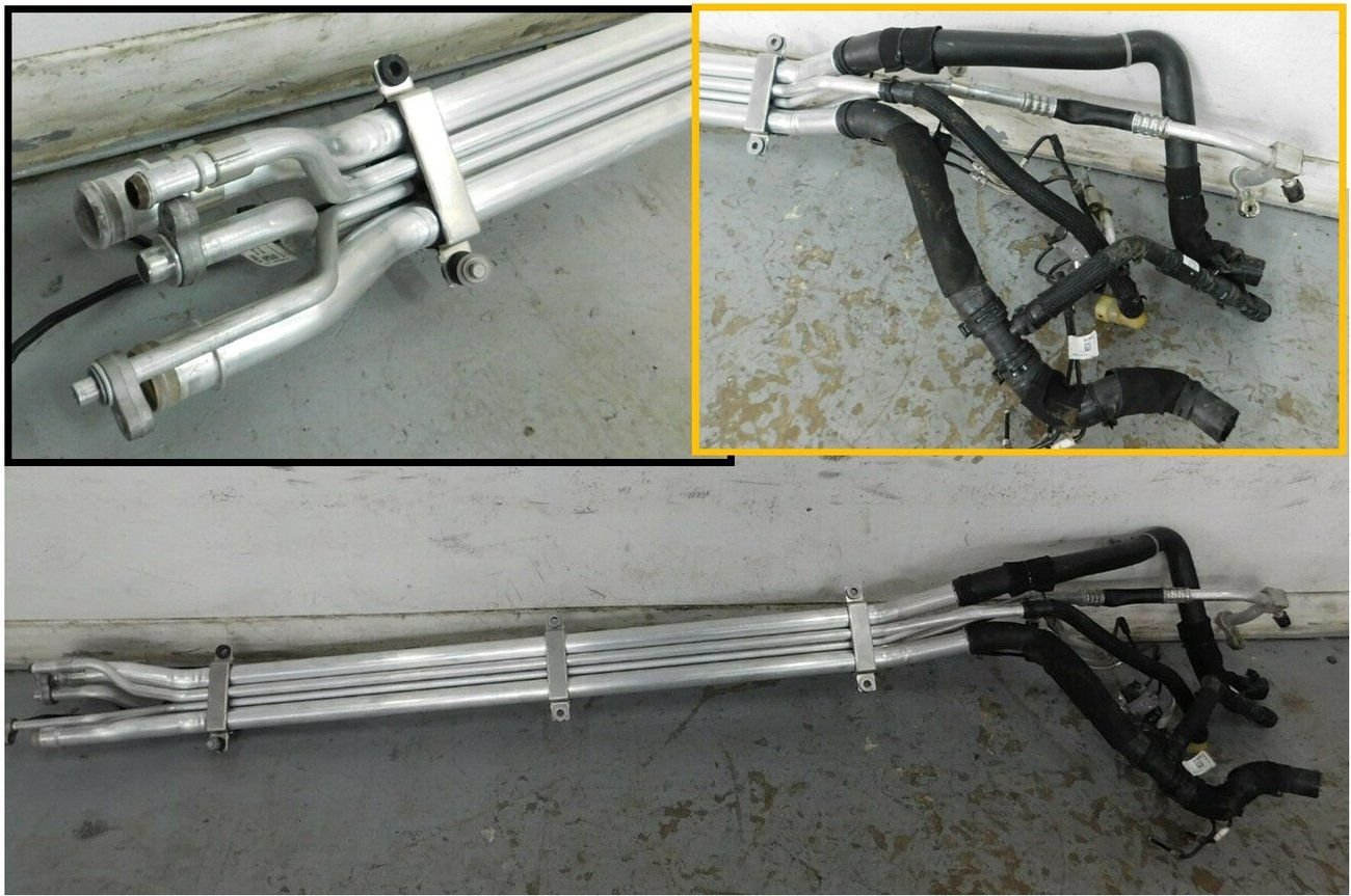

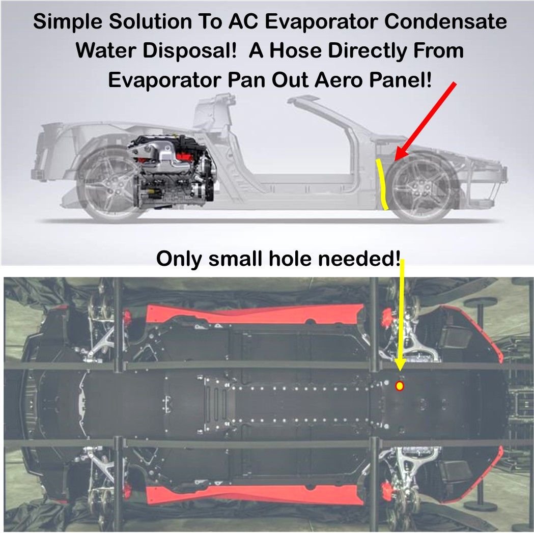

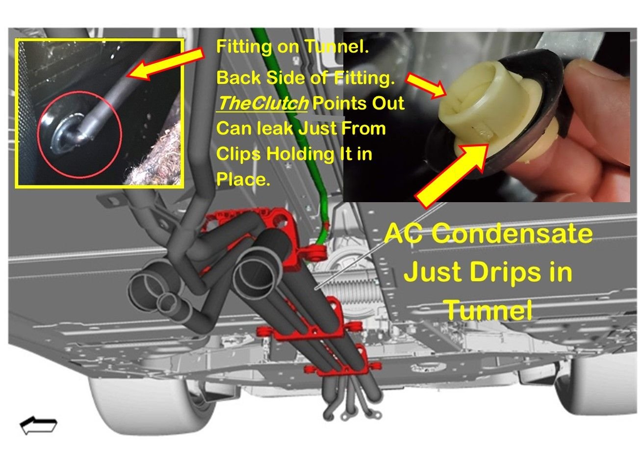

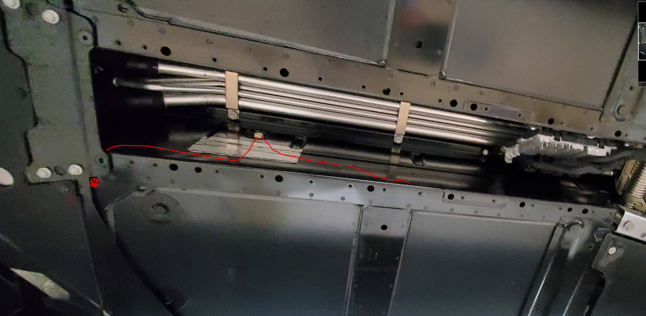

In addition to Andy's excellent pics from the digital Service Manual I'm wondering where all these coolant and0 AC Fluid pipes are that now go thru the tunnel in my planned E-Ray?? They have to be in with the battery.
Hope they are using my idea and just having in go straight down and drop thru a small hole in an aero panel!
Guess there is room above. BUT 180 degree water in insulated pipes when they are running cooling water thru the battery pack! If I recall correctly there is an ideal temp the high voltage batteries like to operate around 100F.

Originally Posted by JerryU
In addition to Andy's excellent pics from the digital Service Manual I'm wondering where all these coolant and0 AC Fluid pipes are that now go thru the tunnel in my planned E-Ray?? ....
@JerryU , here ya go! You can see 'em in there.

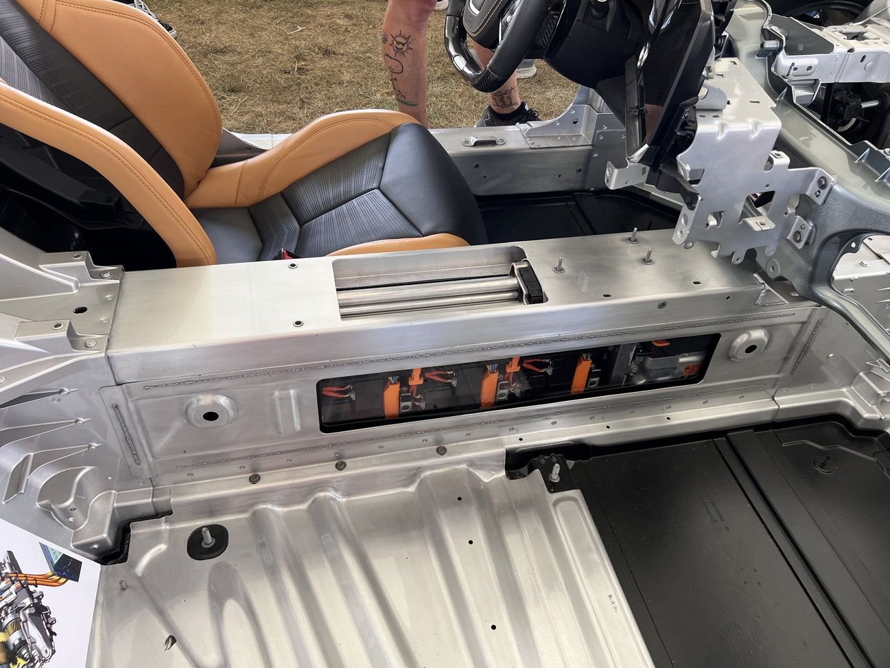

Old Sep 5, 2023 | 11:25 AM
Andybump's Avatar
Andybump
Joined: Mar 2007
Posts: 11,401
Likes: 8,561

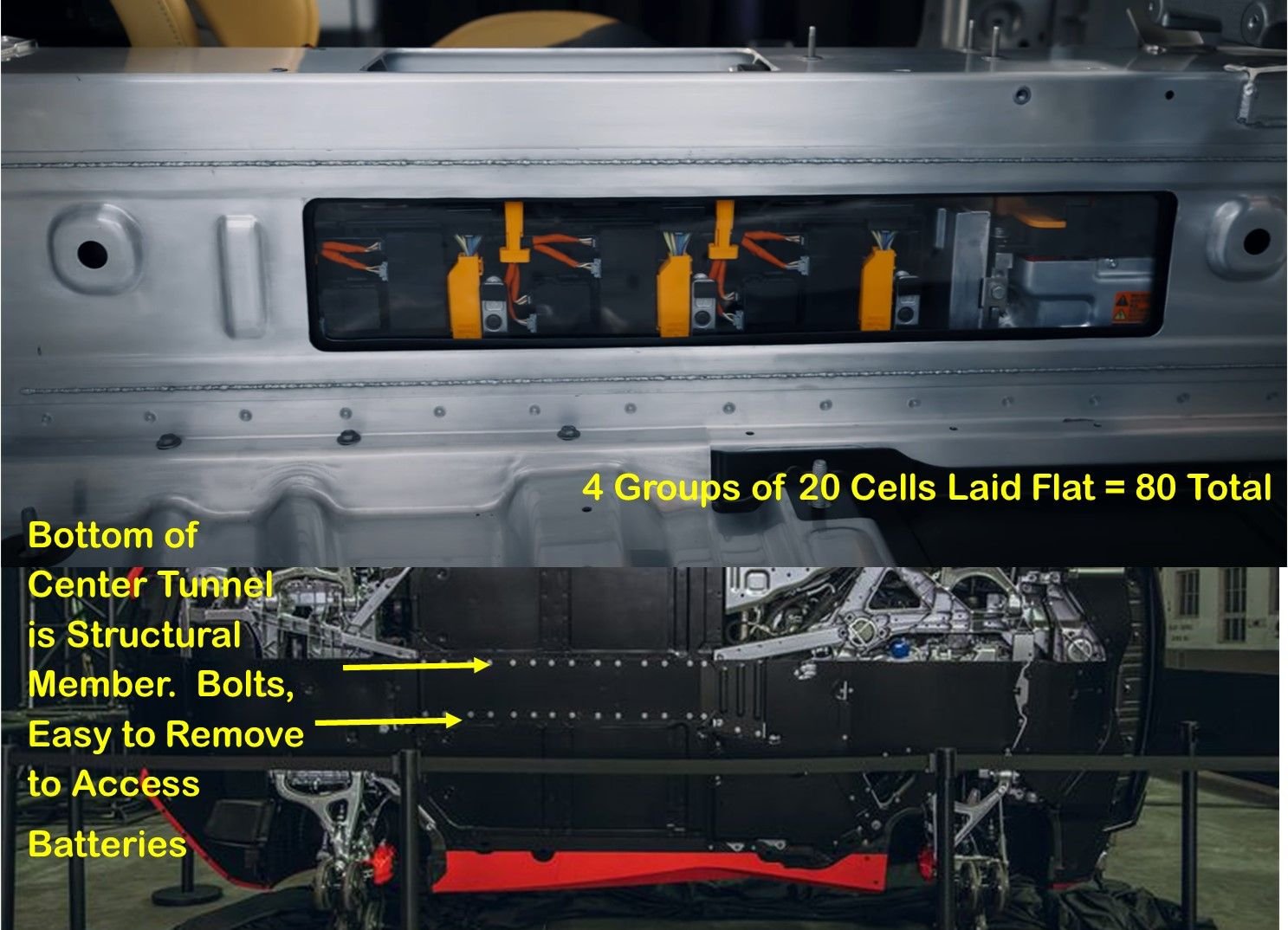

And here are some interesting pictures of the battery pack. They're on the E-ray subforum.
