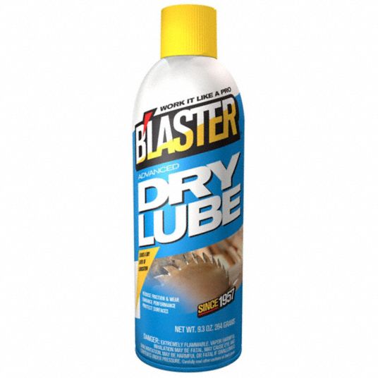

I tested dielectric grease all the way to the 1/100,000 ohm and found NO conductivity.
It was also black, full of carbon and nasty to deal with.
My recommendation would a dry lube like Blaster Dry Lube:

Hmm, the dielectric grease I use on my street rod BB and all outdoor lightbulbs is clear. Works great.

Mine is clear too.

Dielectric grease is non-conductive. It’s a common misconception that it is conductive because the name has the word electric in it. If it conducted electricity it would cause all sorts of issues with shorts especially when used in harness plugs with multiple wires.
Motor Trend has a good write up stating;“why is it sold in auto parts stores in the electrical section and included in almost every high-quality ignition or aftermarket electrical accessory you buy? Because when applied properly to electrical sockets, plug wires, or fittings with a good, tight mechanical connection, dielectric grease is a fantastic means to keep water and moisture out of your electrical system, prevents rubber gaskets from drying and cracking and seizing, and helps mitigate any dust or alkaline contamination that could cause corrosion and early deterioration of your wiring and connectors.
