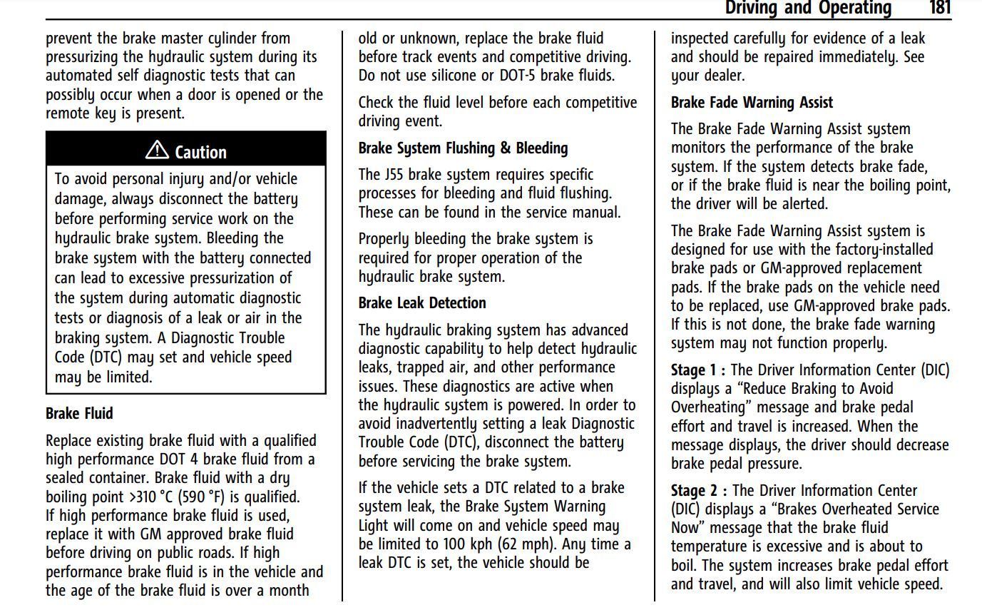

C8 Z51 Brake Bleed Disaster!

Anyone know why you can't use DOT-5+ is it because of the brake lines won't hold at that higher temp?
Brake Fluid from GM

DOT 5 is silicone-based while DOT 3, 4 and 5.1 are glycol-based. The two are not compatible.
