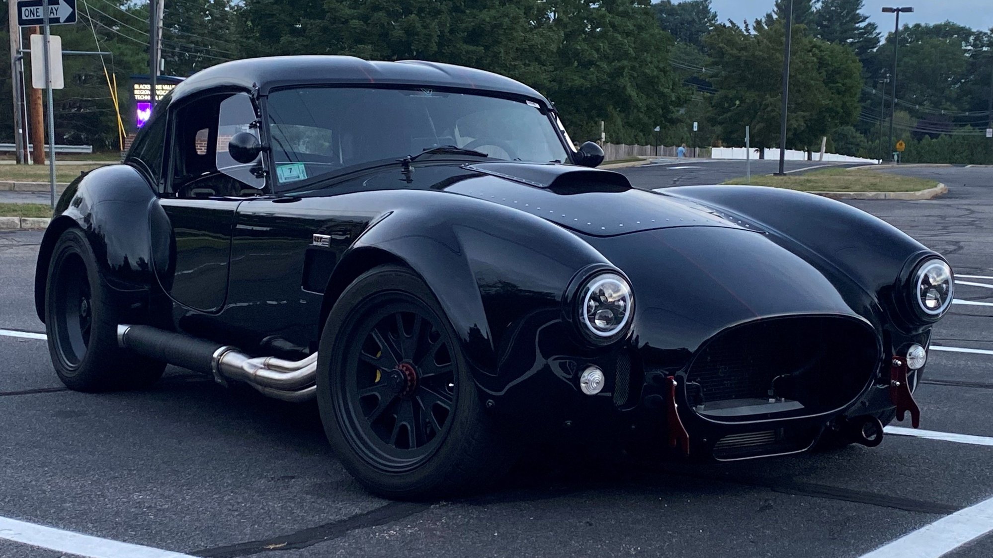

I am coming from a platform where I had to paint mark every bolt because they rattled loose. I am also a bit nervous just driving bolts into aluminum threads without some type of measured force.
This was my last ride that needed constant attention to not kill you
