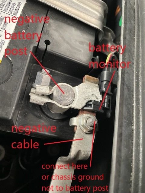

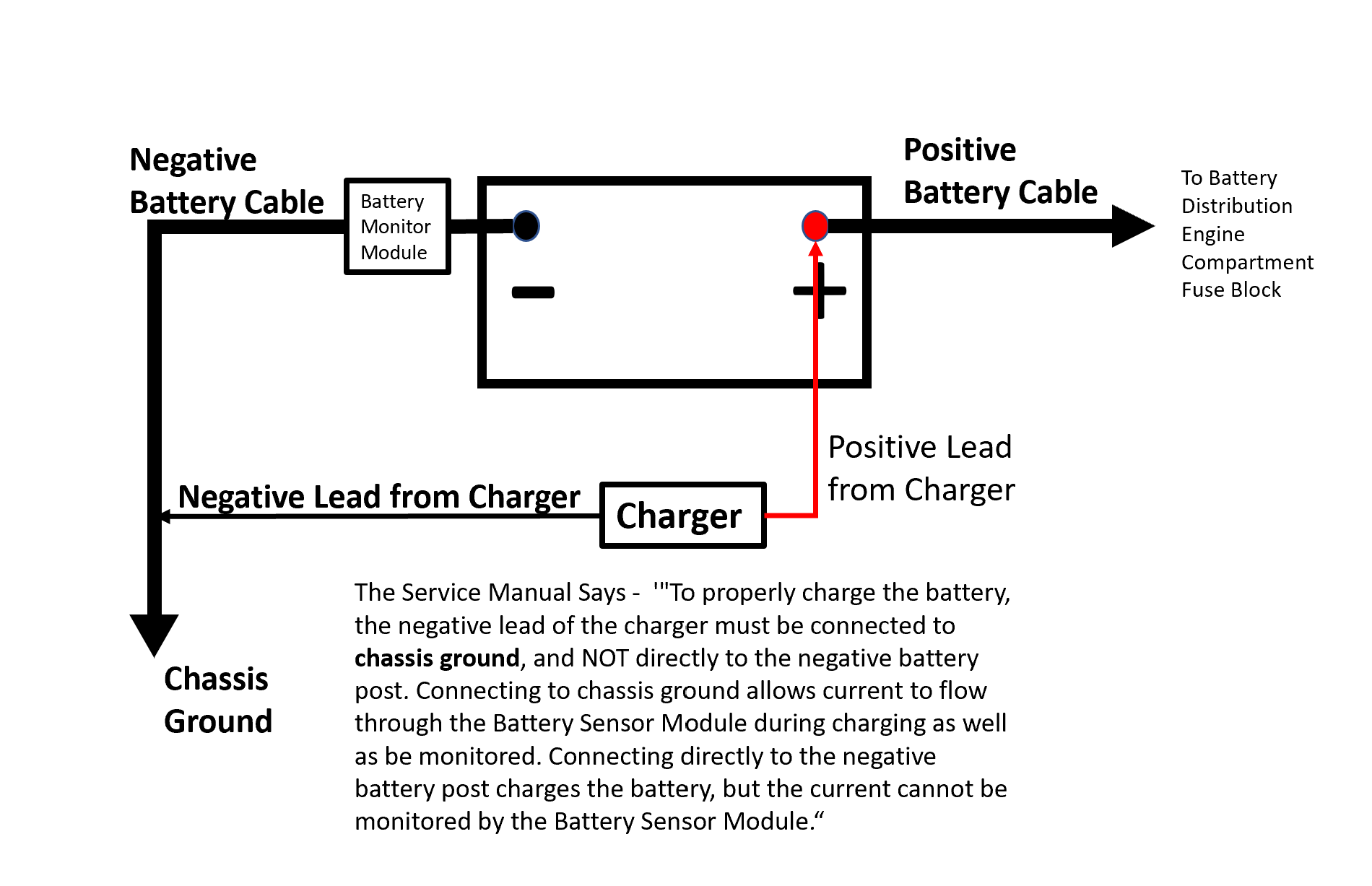

Old Oct 27, 2023 | 06:30 PM
Andybump's Avatar
Andybump
Joined: Mar 2007
Posts: 11,409
Likes: 8,568
Default According to the Service Manual
The following illustrations were created in accordance with what the Service Manual says about how to connect a battery charger. The text from the manual is included in the first illustration.

Old Oct 30, 2023 | 11:04 PM
Red Mist Rulz's Avatar
Red Mist Rulz
Joined: Sep 2016
Posts: 13,180
Likes: 10,527
CAN you? Yes. SHOULD you? No.
GM specifically warns against doing this because it bypasses the battery monitor circuit and results in the car not knowing the actual level of charge of the battery.
GM says the negative cable from the charger should be connected to a chassis ground, not the negative terminal.
What's wrong with using the socket in the frunk that GM put there specifically for this purpose?

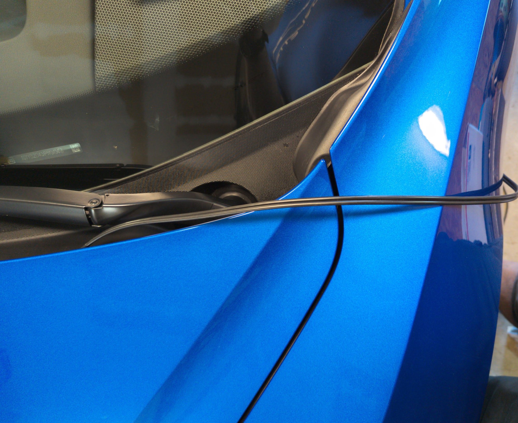

Old Nov 2, 2023 | 07:32 PM
Sleepynupe's Avatar
Sleepynupe
8th Gear
Joined: Aug 2023
Posts: 8
How do you avoid pinching the wire with the frunk auto close feature in 2024s?
Old Nov 2, 2023 | 07:53 PM
BJ67's Avatar
BJ67
Joined: Nov 2012
Posts: 3,163
Likes: 686
From: SUFFIELD CONNECTICUT
I have a 2021, but it doesnt matter, just lower the lid till it touches the latch and let it stay unlatched. Covered the car and zipped up the Car bag.
