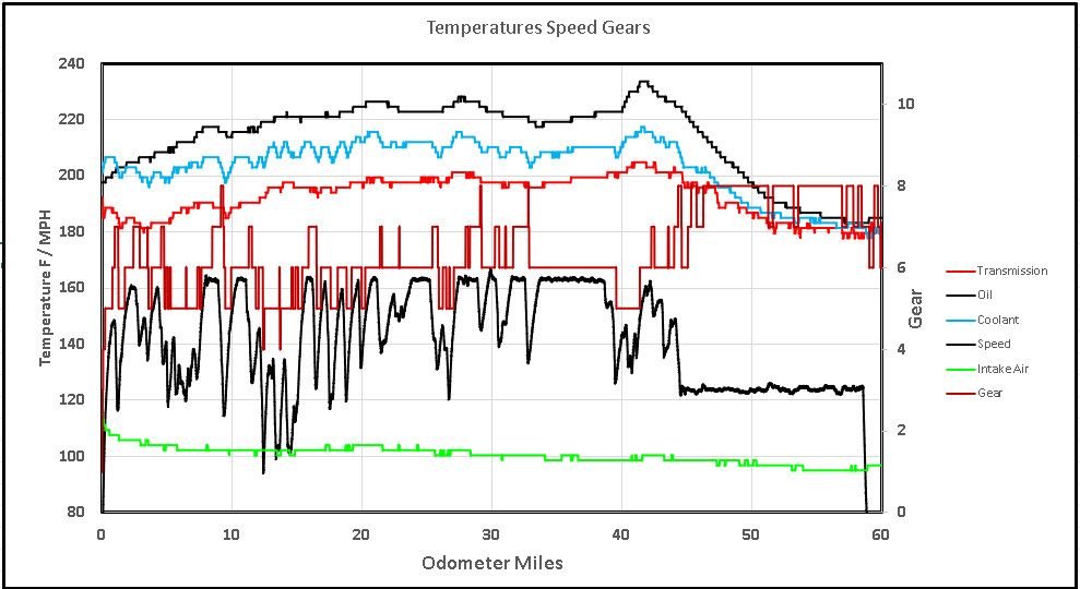

I drive my 2022 C8 Z51very fast in the open road races several times a year. This is the fourth Corvette I have used in these races. The C8 is by far the best above 150 mph. But my car has a problem that has shown up three times and cost me finishing well. No DTC codes ever show up. All the fluid and air temperatures are well within limits.
After 30+ miles of 150 mph driving on a warm day, the car slows down. Foot to the floor is 155, then 150, then 145. For the next 30 miles the maximum speed wanders around between 135 and 145 mph. No gear changing or mode changing makes any difference. It just won’t go fast. My dealer and service advisor are very good but they can’t find anything. This is a CND -Can Not Duplicate.
With Jeremy Welborn’s help (thank you very much), I managed to contact Corvette’s Chief Engineer, Josh Holder and Lane Rezek, Corvette Brand Quality Manager. Through several email conversations we tried to isolate the problem and eliminate false paths. I sent them PDR files and other diagnostic files from the road rallies. I use Cosworth’s PI Toolbox and already knew there was nothing in the normal OBD II at the ALDL that would help this problem. Josh and his staff concluded the same thing.
Before my last high-speed event in October, Josh had a field engineer meet me at the dealership. I left the car with Lee Williams for several hours. He installed a custom-made data recorder on the ALDL (OBD socket) and mounted it securely behind my seat. I had a button mounted by my right knee to push when the car started acting up.
Event day was cool and I was afraid that nothing would happen. I drive this car as fast as I can until I reach a finish solution, then I slow down as required. Well, the car decided to slow down first. I was in the middle of nowhere with no cell service or anything else. I had no idea if the recorder captured the slow down event data and whether it was able to upload it.
A few days later Josh emailed that the needed data had been received and his engineers were working on a solution. Today I got an email with the summary of his investigation and a simple solution. All this preamble to the solution is needed. There are going to be some people very surprised by his answer. But remember where this came from and his position. Here is his answer.
On October 27, 2023 Josh Holder wrote:
When you can schedule a visit to your dealer to return the data logger, please ask them to REMOVE 2L of oil from your transmission. The +2L fill was intended for “track” use as in “closed road course tracks” with sustained high G loading. You aren’t doing that in this event. Frankly most people would never see pressure drop outs even on a road course track at the factory fill level.
When the transmission has the extra 2L of oil, the sump level allows 6th gear (which you are in a lot) to spray oil directly onto a temperature sensor. When subjected to high load, like wide open throttle for long durations, the oil spray from 6th gear gets hot enough to cause the sensor to report to the transmission control module that it should begin to limit torque to protect itself. That is exactly what is happening to you. It’s a localized spray of hot oil. The sump average temperature is still quite low.
For the Z06 and all Corvettes built after July of 2023. The case and lube system have been revised so that the extra 2L of oil is no longer required for any situation.
That you very much for your willingness to help us out. We could not recreate the problem in our own vehicles because they were not track prepped for high-speed run (It does not meet our definition of track use), but I can completely understand why it would seem logical to add the 2L for your event. It just was not intended for that use case.
Drain 2L and you should be good to go.

This is an update to the thread from October 2023. My car would speed limit after driving at 140 mph + for an extended time. Per the recommendations above from Josh Holder, I removed the extra two liters of transmission fluid.
This event runs in two legs. The first leg is usually about 65 F ambient. I have not had a problem with this leg in the past. I ran this leg in April averaging 148 mph with no problems.
The ambient for the second leg is usually about 90 F. This is where the problem has happened in the past. After about 30 miles averaging 145+, the car would not go faster than 135-140 mph. No codes. No misses. Throttle down, 140 was all it would do.
This April, with the extra two liters gone, there was no slow down. I am course limited to 168 mph. I was able to run 168 as long as I needed to reach a finish line solution.
Is the problem fixed? For this event yes. I hope removing the two liters is the final fix.

Unfortunately I can't verify that this is a fix until next April. Not a whole lot of long track 150 mph opportunities between now and then.
I'm working on a way to get the two liters out without making a mess.
