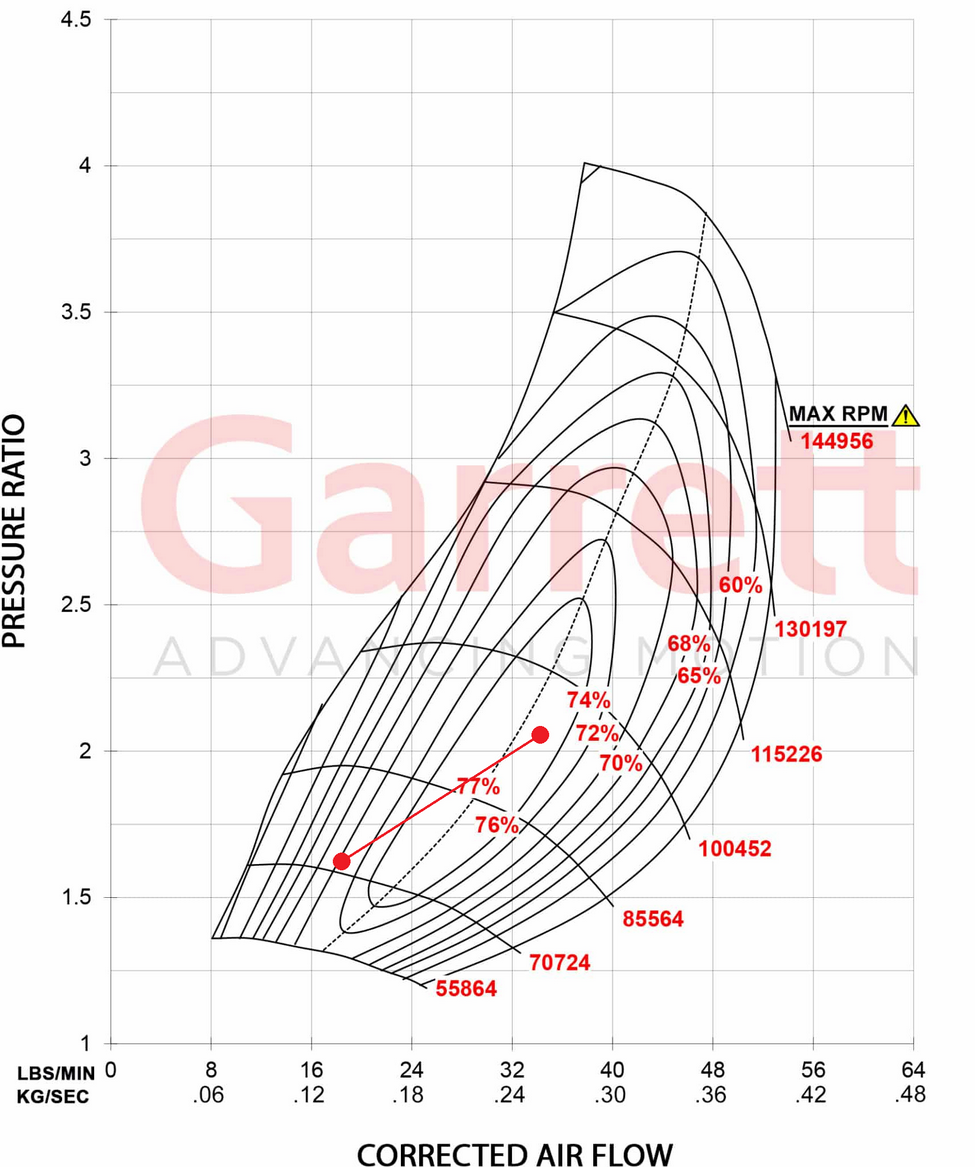

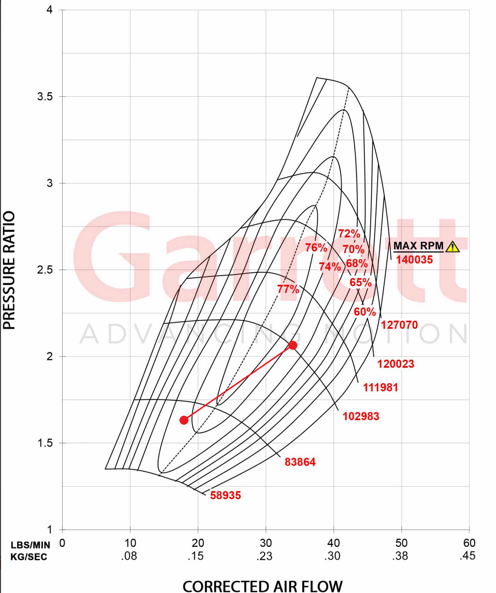

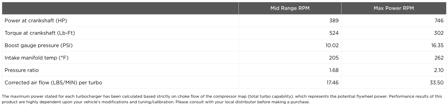

Looks like I partially answered my own question. Found access to the Garret Boost Adviser and they do the calculations for you.
Input targets
Based on this, it looks like twin 53mm compressors are most ideal
Garrett GT3071R
Garrett GT3076R
