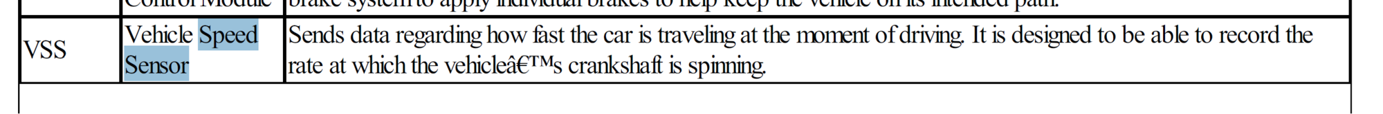

There are numerous "speed sensors" in the car. There is something called a "B115 Vehicle Speed Sensor" VSS. I think, based on a statement attached from the Service Manual, that the speedometer reading comes from the VSS. And, think, based on another statement attached, the VSS is actually coming from the crankshaft speed, then it must be calculated based on the overall ratio to the rear wheels. There are also Wheel Speed Sensors WSS, on on each wheel. These, I think, are primarily for the purpose of stability control. There is even a DTC that can be set if there is a discrepancy between the VSS and WSS sensors.
Different sized front tire should not affect the speedometer and odometer readings, but could potentially result in a discrepancy between the expected wheel speed and the vehicle speed. No one has reported any issue with that. It boggles the mind. But say the rear tires have not been changed, but the front tires are larger. Then the for a give speed (which is determined correctly by the rear tire which have not been change yet), the front tires will appear to turn slower than expected. But now, make the rear tires larger too. Now for a give vehicle speed as calculated from shaft speed, the car is actually going faster than expected. But now the front tires are spinning a little faster too, so it might be a wash when all the tires are increased in size proportionally.
As for actual vehicle miles - thats another interesting question. Yes with larger tires the vehicle will have traveled further than calculated when based on the engine RPMs. But as far as all the internal shafts, gears, every mechanical part, they "traveled" the same distance. As in your example, if the car reads 10000 miles, but the distance it went because the tire circumference was larger was actually 10480, all of the internals still went 10000 mile (though at maybe a higher load). Does that make the mileage inaccurate? Does it affect the maintenance intervals? I do not know.
Now, I mentioned there are other speed sensors in the car. There are a some internal to the transmission and the output shaft - probably more that I overlooked. But regardless, the speed of the car is going to be calculated based on an assumption about the circumference of the rear tires. The larger tire will cause the car to go further than calculated, and its actual speed will be higher than the speed on the speedometer.

Yes. The service manual seems to say its crankshaft rpm but its not real clear. And there is an output shaft speed sensor as well. With either source, its calculated based on gearing to the rear wheel, and includes an assumed circumference for the rear tire.
