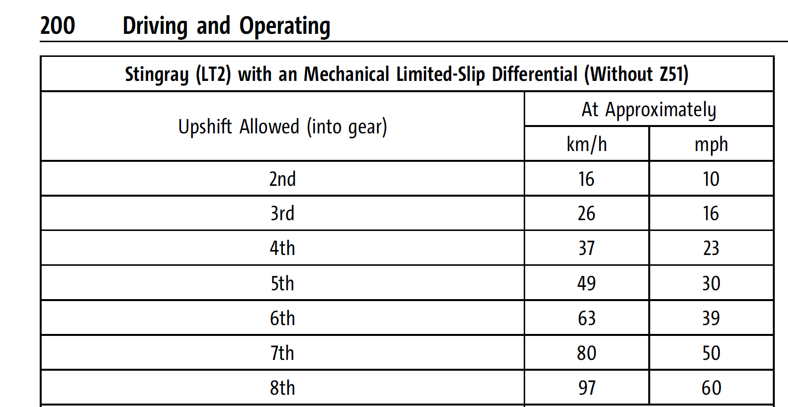

There is no slipping in a properly functioning DCT. If the speed is constant, and the gear does not change, the RPM should not change. If the RPM change you are seeing is coincident with a slight speed change, then its not slipping. In 6th gear, a 250 RPM change would be about 8 mph. I notice you siad 6th gear and 38 mph. That very close to what some would say is lugging the engine. I calculate about 1155 RPM give or take. According to the table in manual, an upshift to 6ht gear should not even be allowed until 39 mph. Are you sure its not shifting when you see the RPM change? You should not see an RPM change even if V4 kicks in unless there is also a speed change.
