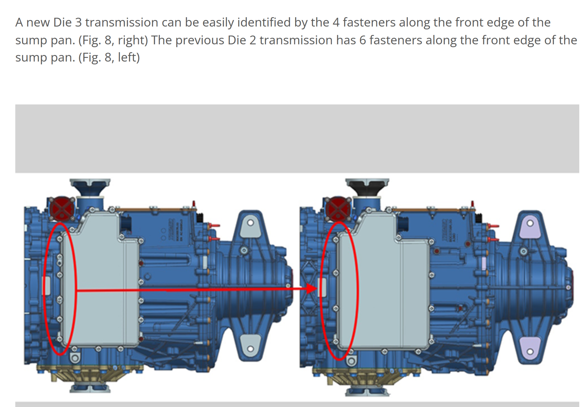

Don't doubt that you have it. But, its a new case and different pan, not just pan change. This can be seen for illustrations of the pan for what are called the die 1, die 2 and die 3 case. The new one is die 3. The bolt pattern on the pan is different, and the so the case is different too. You likely knew all that.
