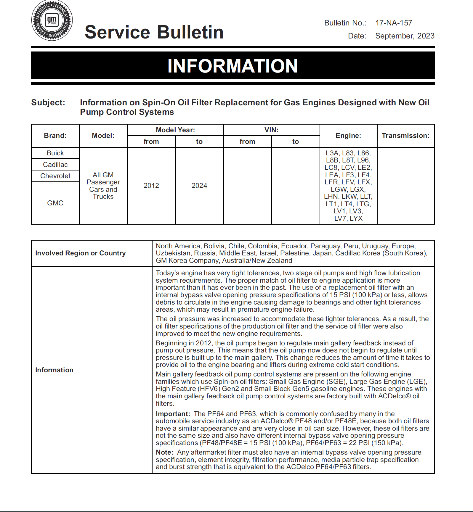

See this link, PF64 Only GM service bulletin on oil filters :17-NA-157
https://static.nhtsa.gov/odi/tsbs/20...42844-0001.pdf

I'm sticking with the PF64. But this statement in the bulletin is interesting.
"Note: Any aftermarket filter must also have an internal bypass valve opening pressure
specification, element integrity, filtration performance, media particle trap specification
and burst strength that is equivalent to the ACDelco PF64/PF63 filters.
Does equivalent bypass valve opening pressure specification mean "equal", or no lower?
Also, oil filter can fail, both Delco or aftermarket. Some have said that if an engine failure is caused by a failure of the correct filter - it would still be covered by the warranty if it is still under warranty. But, if an aftermarket filter fails, it might not be covered. I do not know if this is entirely accurate, but for me it is an additional risk factor.

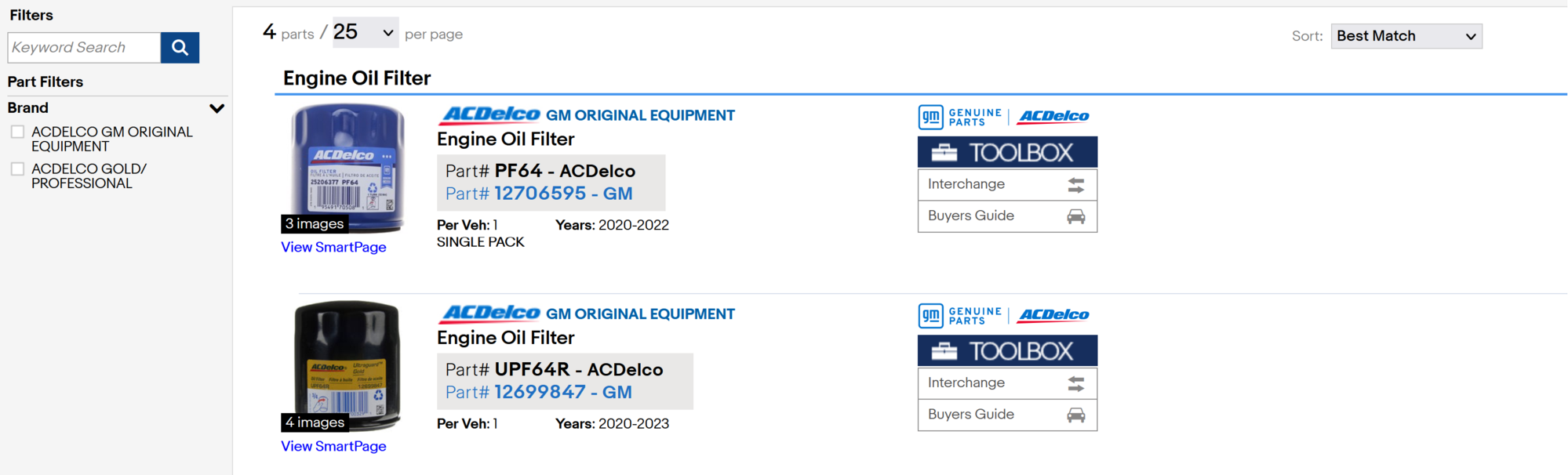

Nothing wrong with using the UPF64R filter in place of the PF64. Both AC Delco and GM list the UPF64R filter as fitting the C8. Even my local Chevrolet dealership uses this filter on C8's. It's a better filter in every way compared to the PF64 and the one I've been using for the last 2 oil changes on my 23. I actually prefer the higher flow rate, higher filtration and higher bypass to help prevent unfiltered oil from circulating the system and if GM/AC Delco recommend it I'm sure it's ok despite what the Karen's say.

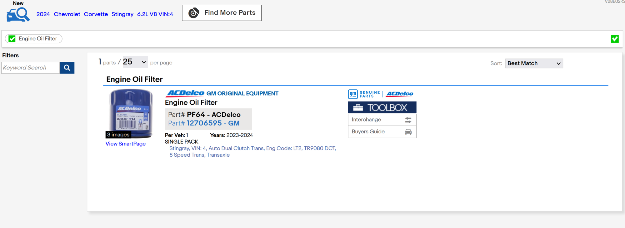

Although I plan to use the PF64, I did find that the Delco parts catalog lists PF64 and PF64R both as fitting 2020-2023. Interestingly, if you search for 2024 Stingray, it returns only the PF64 and says it fits 2023-2024. So, its inconsistent. Furthermore, that same site also lists aftermarket interchange brands. Does that mean GM or Delco endorses the use of those? Folks can feel free to do what they want. I plan to use the PF64.
What did you mean when you said you checked with GM - was that a different source from the ACDelco Catalog?
Does this bulletin even apply to the C8 which has the LT2 engine? It does not include LT2 in the list of engines - it goes from LT1 to LT4. It also says this:
"Beginning in 2012, the oil pumps began to regulate main gallery feedback instead of
pump out pressure. This means that the oil pump now does not begin to regulate until
pressure is built up to the main gallery.
This change reduces the amount of time it takes to
provide oil to the engine bearing and lifters during extreme cold start conditions."
And this seems inconsistent with position of the oil pressure sensor and oil flow for the LT2 engine, in the Service Manual.
The oil is pressurized as it passes through the primary pump and is sent through the engine block lower oil gallery to the liquid-to-liquid
(engine coolant to oil) engine oil cooler. Oil exits the engine oil cooler, past the engine oil pressure sensor, and enters the full
flow oil filter
where harmful contaminants are removed. A bypass valve is incorporated into the oil filter, which permits oil flow
in the event the filter becomes restricted. Oil exits the oil filter and is then directed to the upper main oil galleries.
In other words, in the LT2 the oil pressure is measured at the filter input, not at the "main gallery" as described for the applicable engines in the bulletin. I searched for evidence of another oil pressure sensor located further downstream from the filter - such as in the main oil galleries - but did not find any. The only oil pressure sensor is the one mounted on oil filter boss which is described as being before the filter.
Edit: Add - "After more reading I found this, that suggests a possible mechanical/hydraulic based regulation, rather than being based on the oil pressure sensor:
An oil passage at camshaft bearing location permits oil flow to the upper rear of the primary oil pump. Oil is pumped through this
passage and provides hydraulic pressure to the first stage oil pressure cavity in the primary oil pump. Hydraulic pressure in the
first stage pressure cavity regulates engine oil pressure and can help reduce the load on the engine during normal operating conditions."
This would be more consistent with the bulletin which says oil pressure does not start to regulate until there is pressure in the main gallery. So, maybe it would apply if it listed the LT2 engine.
I'm not sayin' that its ok to use a different filter - just pointing out that the bulletin may not be applicable to the LT2.

PF64 @ 22psi is directly from GM; they released a bulletin during the C7 years (see attached).
File Type: pdf
