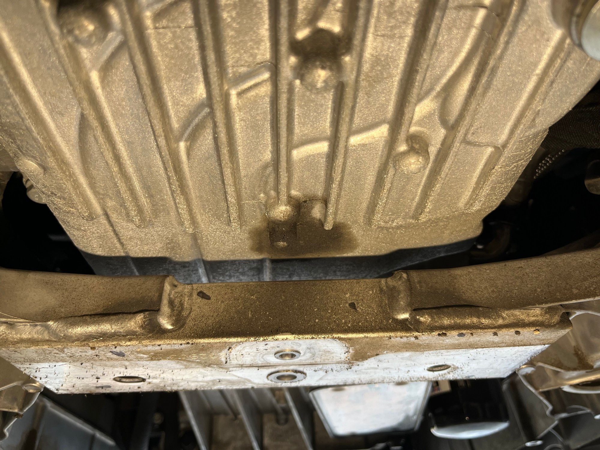

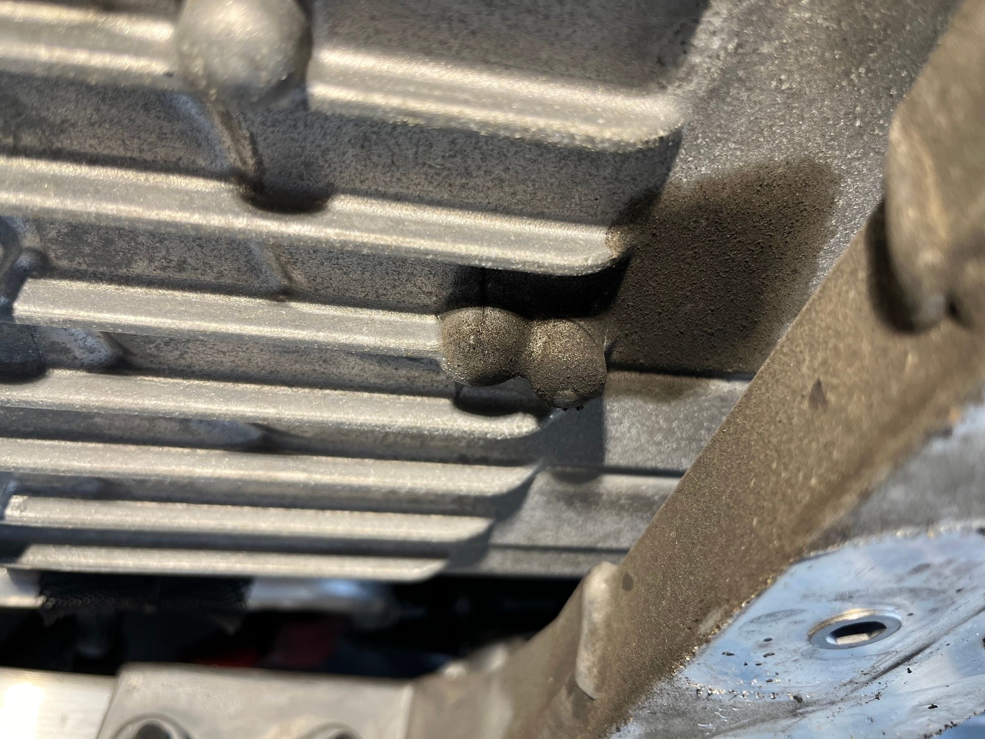

I was changing the DCT fluid and noticed this oily dirty spot on the oil pan. It’s odd, because it’s in the middle, with no signs of fluid running to that spot. It’s dry, but I’m not sure how it got there. That area looks like it has a seam from the casting, but I don’t see cracks.

Could be casting porosity.

That must be it, I can’t see any other reasons.

You can put some dye in the oil and verify. I wouldn't be comfortable with that.

What are those other dark spots? Is that anything. I'm thinking porosity as well.

Wash it off with soap/water, see if it returns... if it does, you have a porous casting that needs to be sealed/replaced.

I would take it to the dealer and let them handle it under the powertrain warranty before trying to diagnose, clean, etc. anything on your own, which could only mask the issue.

The dark areas on the cross beam are just dirt. I’ll take it to the dealer and hopefully they’ll replace it.

Update: the dealer agrees it’s defective and it’ll be replaced under warranty. FYI, it’s a December 2020 build.
