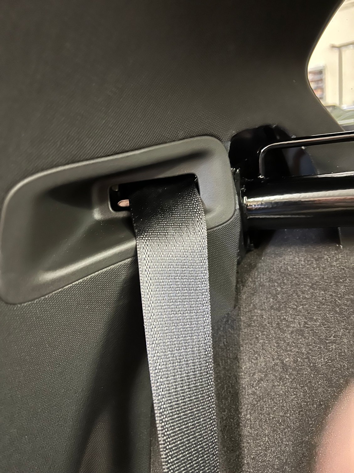

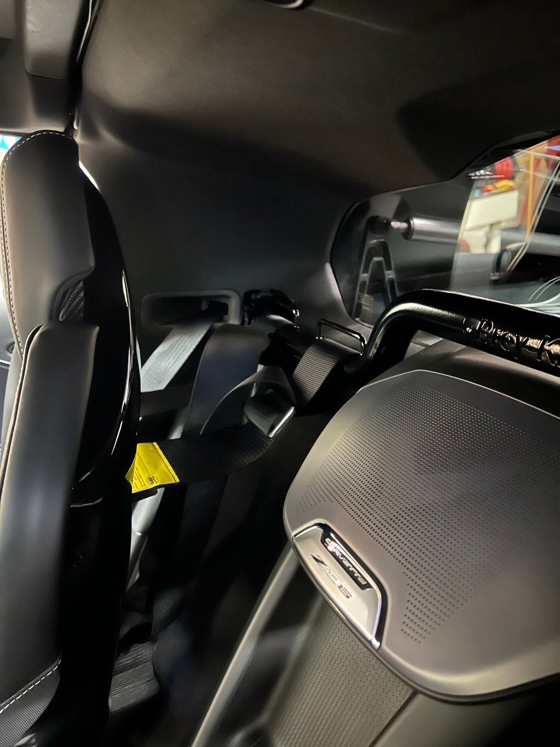

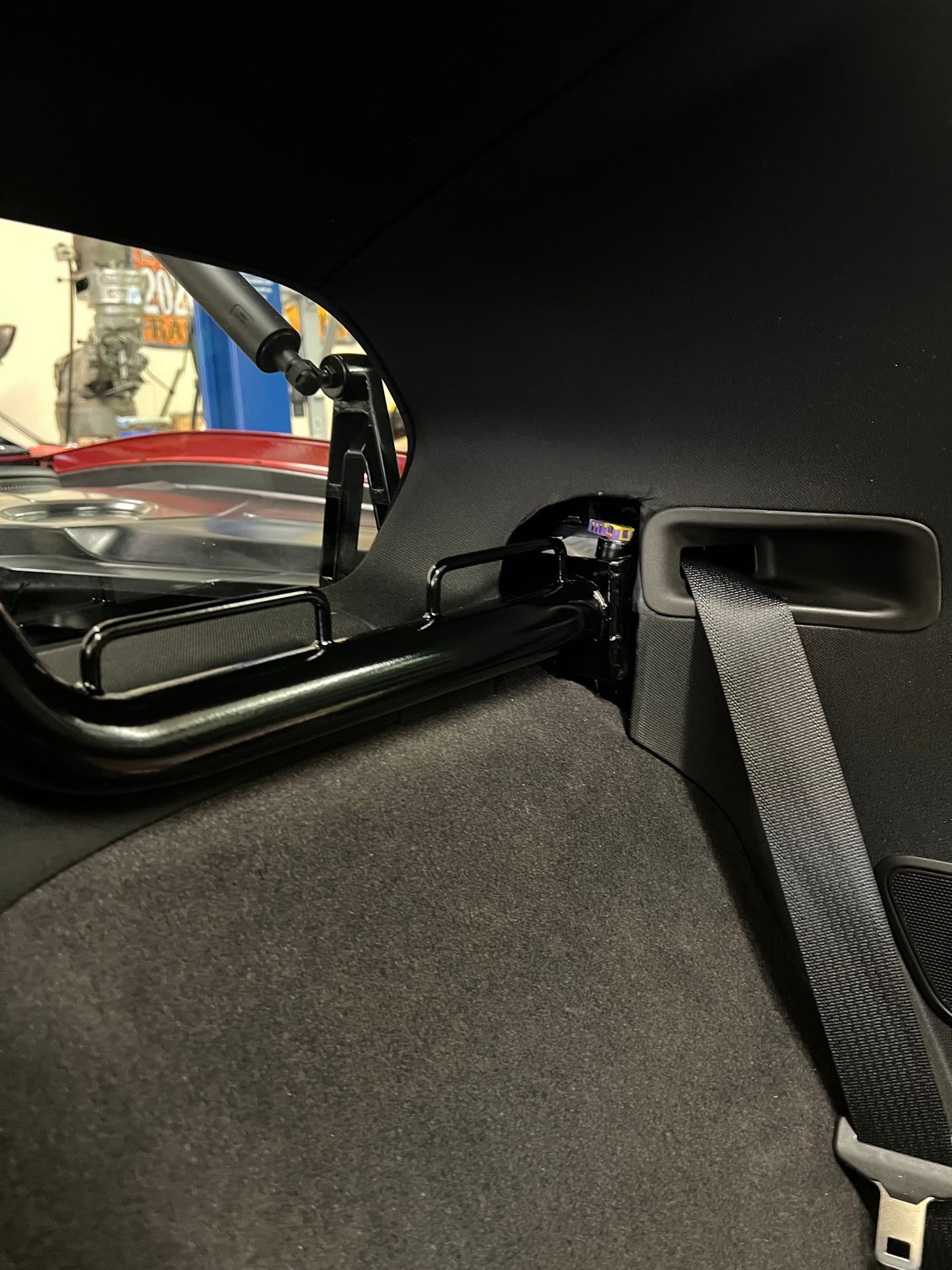

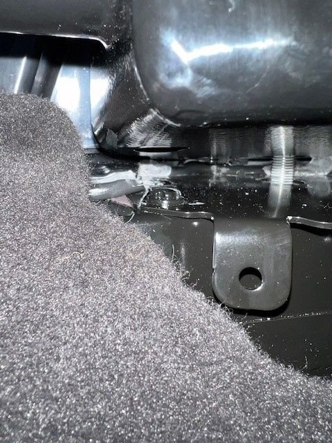

I am trying to install a Brey Krause Harness Bar in a 2024 Z06 Coupe 2LZ. I have removed the body adhesive per the instructions, but I would need to cut into the body panels to get the bar to sit flush as designed.
Pictures are hard to see, but the inside of each end would need to be ground (into body panel) significantly in order for the bar to sit flush.
You can hopefully see in the attached picture what I am talking about.
For those that have installed this bar, did you run into the same issues?

Maybe you could place shims on the underside of the harness bar base plate???

It was not a perfect fitment for me either, and it also caused me to cut the trims more than instructed to make things fit in the end. Good luck!

Update - I spoke with engineers at Brey Krause. Bar appears to be built to print (as designed). They did not question the interference, but not much they could do. Vendor I purchased from agreed to take back. Both companies were good to work with.
In the end, I decided to trim the body panels to make the fit work. On to the next challenge!

agree it should fit, but I had to trim composite panel that runs side to side (back wall). A little tip, have a shop vac running same time you are using dremel tool to trim, or you will have a large mess! As far as edging, you are better off separating the fabric from plastic panel, cut the plastic to size, but leave fabric larger to you can wrap it around cut edge. Watch the Paragon video for technique (cutout is different though). PM me and I can explain more if desired.
