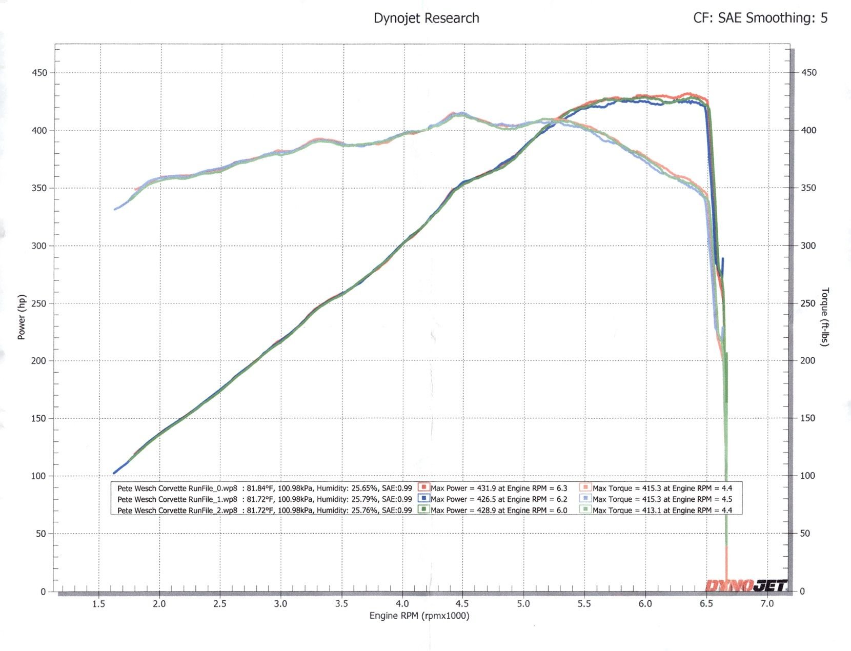

Looks pretty close to mine, bone stock, run at sea level at 82⁰F:
