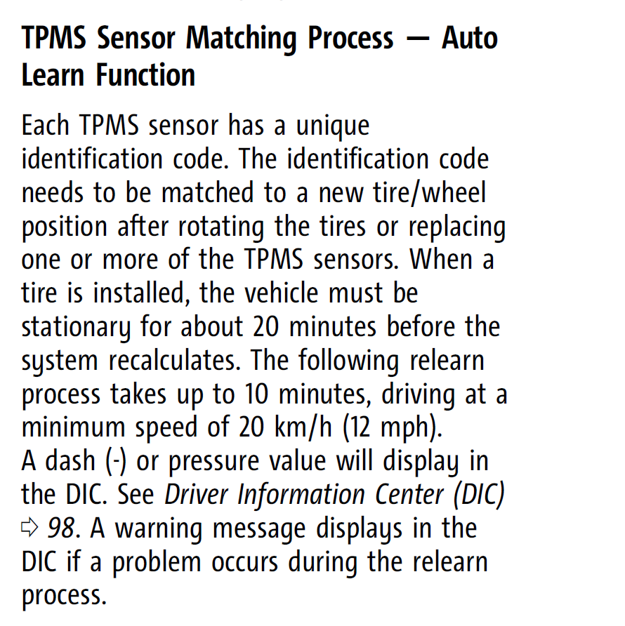

Of course it works, just like everyone else who has replaced the sensors. And, it does not say "registered" to the car - it says relearned. Which is true, and it is why the car has a relearn feature. The purpose of the relearn is so the car can 1)recognize the new identification code and 2) determine the location of the TPM on the car. No tool is necessary for that process to work. Some prefer to use the tool method, then it is ready before driving -but that's preference, not a requirement.
As for programming in advance, I have no basis to disagree, but generally no one has reported that being necessary - so it must generally be done before shipping if it is necessary (perhaps with aftermarket parts). The Service Manual discusses the learn feature but does not say anything about programming it in advance - presumably that's because it assume an OEM sensor is used.

The C8 will automatically relearn the sensors, generally within seconds, sometimes it takes a few miles. It relearns every time you rotate tires from side to side, or switch between summer and winter or street and track wheels. If it were trying to read the old sensors which are no longer near the car, it would show an error.
