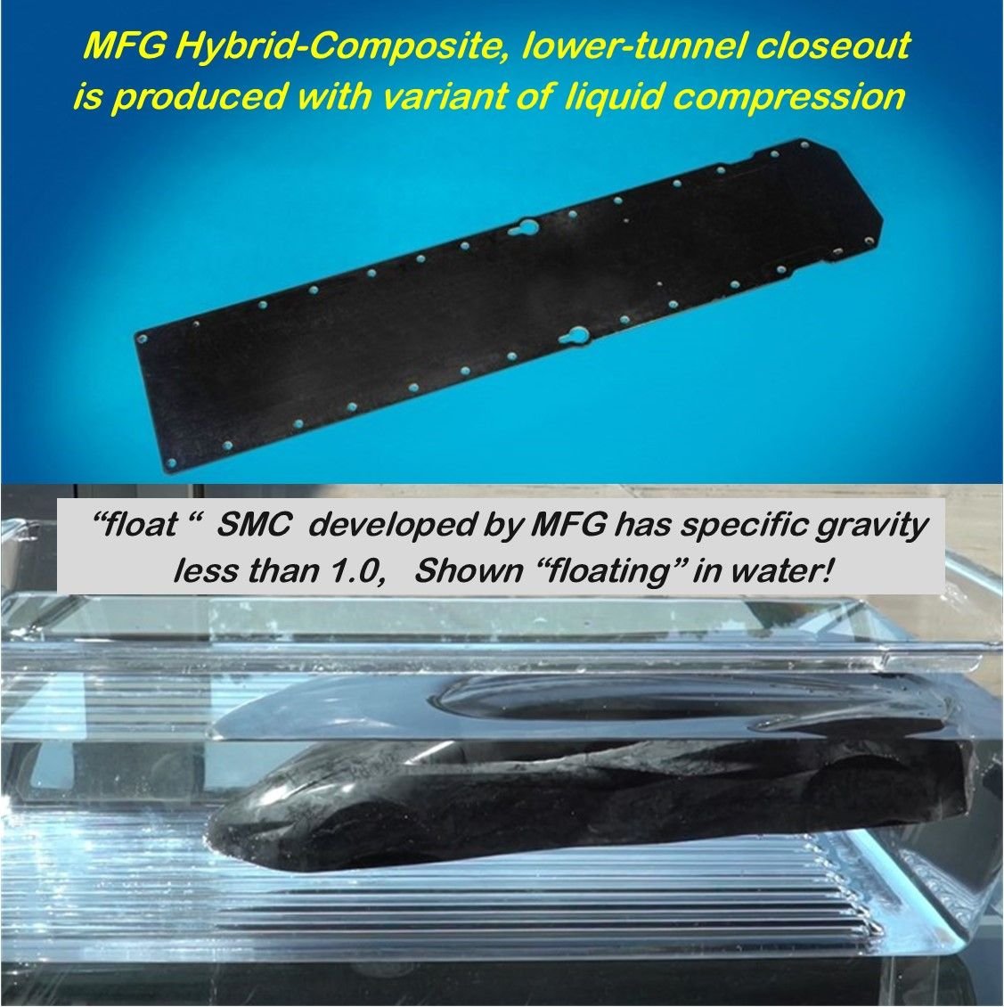

Yep, the SMC in Corvettes is very light. A very thin carbon fiber body panel would be lighter but not by much. Typical carbon fiber body panels have a density of 1.5 to 1.8 g/cc.
The Corvette body panels now include hollow glass beads and have a density close to water = 1g/cc!
Now if you need a very strong, very light body for a AA/Fuel Funny Car, very thin carbon fiber reinforced with Kevlar in critical areas is the ticket when going 300+ mph!
In fact, the original supplier of the fiberglass 1953 Corvette, MFG, still supplies some special SMC parts that have a density lighter than water. They float!
So, not impressed
