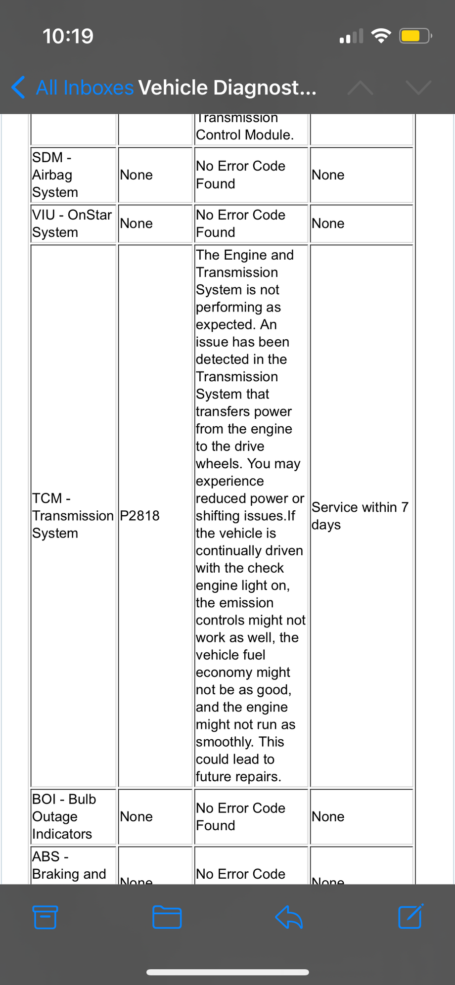

Is anyone documenting the transmission issues for the C8 corvettes?
Just bought my 2021 with 3100 miles on it, has 3500 now, and code P2818 popped off (solenoid 8 stuck open).
For me, this means that the transmission is shot if debris is making it past the filter somehow and clogging up the solenoids.
Taking it in tomorrow and I suspect they will warranty a transmission flush and filter change first.

So P2818. Solenoid 8 is stuck open.
The dealer told me my calibration was out of date and that was the issue. They charged me $200 and kicked me out the door.
My background: thermal systems engineer for a very big tier 1 supplier.
My GM engineer friend and other automotive engineering friends are finding it hard to believe that an old calibration made the #8 solenoid get stuck open. I agree. The only thing that could make a solenoid get stuck open is debris.

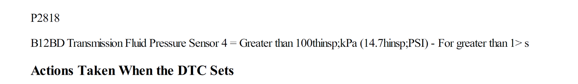

In the 2020 manual that I have, here is the diagnostic procedure for that code. It could have been revised. Where it calls for the "cleaning procedure", that may have been replaced with the Hydraulic System Flush procedure but I do not know that. Also, there could have been transmission software updates that would not be called out in this procedure. The procedures seems focussed on clearing debris, but you can see that if and when the DTC is cleared and does not come back, its done. So if they did update the software, and the DTC went away, they would be done.
Circuit/System Verification
1. Verify the following conditions do not exist: Low Fluid Level - Refer to: Transmission Fluid Level and Condition Check
2.
If a condition exists
Repair or replace as necessary.
3.
If no condition exists
4. Ignition >> On / Vehicle >> In Service Mode & Engine >> Off
5. Perform the following action: Clear the DTCs.
6. Ignition/Vehicle >> Off - For greater than 60 s
7. Operate the vehicle within the Conditions for Running the DTC. You may also operate the vehicle within the conditions that you observed
from the Freeze Frame/Failure Records data.
8. Verify the DTC does not set.
9.
{ Test failed 1> time(s) } If the DTC sets
10.
1. Perform the following procedure/test: Limited Slip Differential Clutch Hydraulic Control System Cleaning Procedure - 3> times
2. Repeat the procedure starting at step 3>
11.
{ Test failed 2> time(s) } If the DTC sets
12.
1. Perform the following procedure/test: Transmission Oil Filler or Drain Plug Replacement & Automatic Transmission Fluid Filter
and Seal Replacement
13.
{ Test failed 3> time(s) } If the DTC sets
14.
1. Perform the following procedure/test: Automatic Transmission Fluid, Fluid Pan and/or Filter Replacement & Automatic
Transmission Fluid, Fluid Pan and/or Filter Replacement ( Main )
15.
{ Test failed 4> time(s) } If the DTC sets
16.
1. Replace the component: T12 Automatic Transmission
17.
If the DTC is not set
18. All OK.
Repair Instructions
Perform the Diagnostic Repair Verification after completing the repair: Diagnostic Repair Verification
Automatic Transmission Replacement - T12 Automatic Transmission Assembly
For control module replacement, programming, and setup refer to: Control Module References

We can speculate, but when a DTC says a valve was stuck open, how does it know? It uses a sensor for that as noted. And it compares it to threshold that is exceeded for a time limit. Its possible that the threshold was adjusted, or the time, or some other software glitch or calibration actually did cause it. The car is so complex. Its not clear to me actually that debris would keep it stuck open, unless we think the debris is trapped where the valve can't shut. But maybe the solenoid itself just temporarily failed. Its why they reset stuff and see if it comes back.

exactly, you made me start thinking about it a bit more. The solenoids in these are very robust. So it is very possible that a cal could fix it by changing thresholds and limits. I wish they released notes for software revisions hahah
