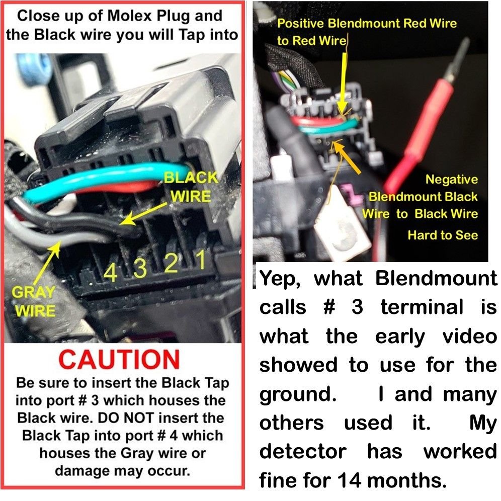

I've had my Escort MAX3 installed with a BlendMount + WireTap for 3 years and it's been flawless. The key is making sure you tap into the correct ground in the mirror harness.

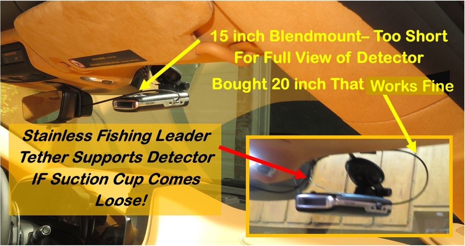

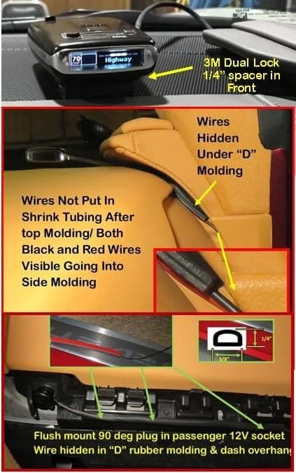

Just be careful when you put the Blendmount wires into the plug. These pics may help as will my PDF that covers what I did for 3 years then my current, used for a year on my 2020 C8 that I moved to my E-Ray. This is my PDF with many Pics covering all installs in C8 and E-Ray:
netwelding.com/Radar_Detector_Power.pdf
Be Careful. No Issue If Done Properly. Hard to see black wire. No way as clear as Blendmount Pic, especially when sitting backward on passenger seat! Easy to see Red Wire. My suggestion, from Red go down to lower row and over One place left- NOT Two
Had for 3 years in my 2020 C8.
For a year on my 2020 C8 used dash mount. Moved to my E-Ray in 5 minutes.
