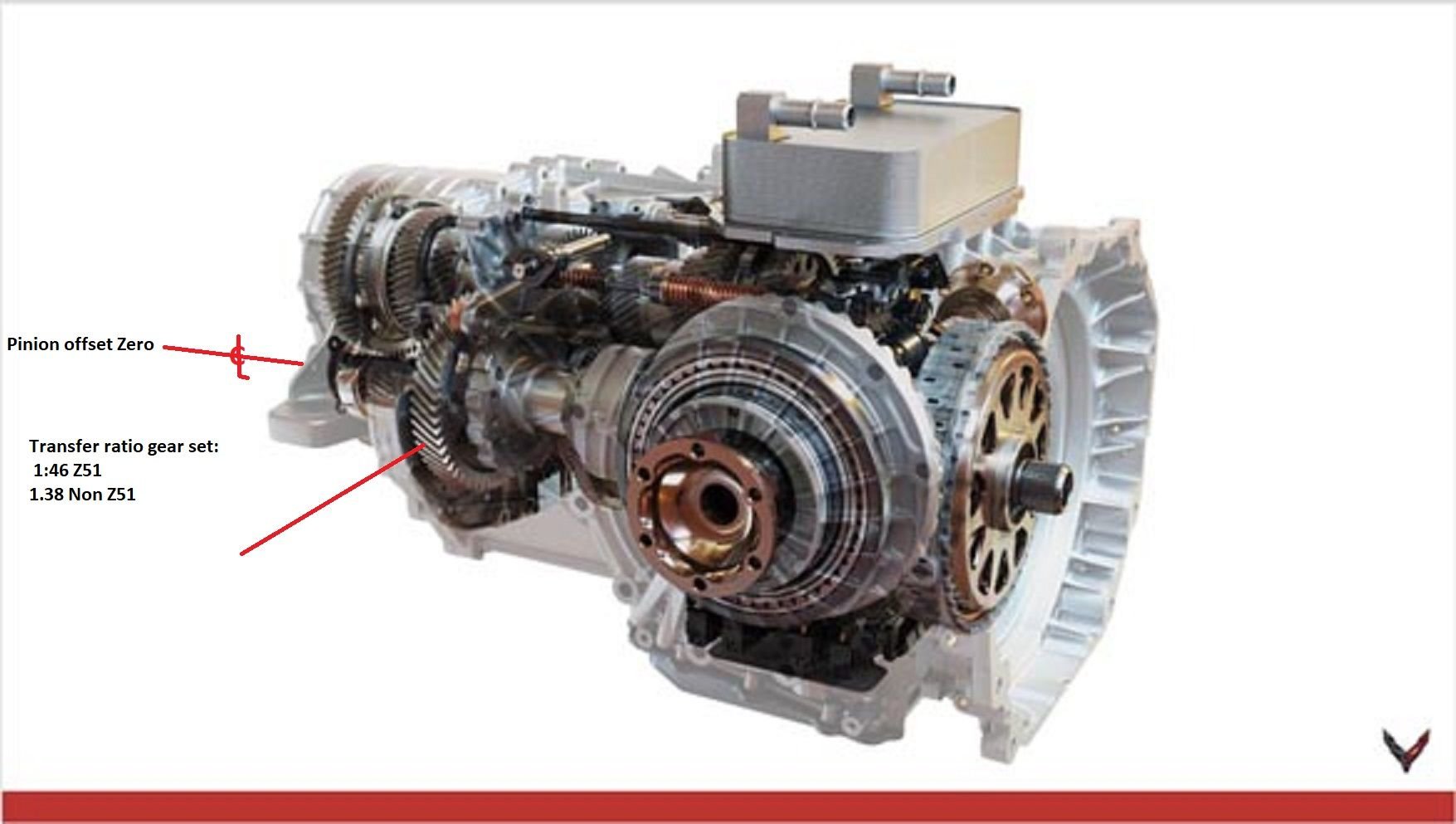

Originally Posted by combatninja
That's what I've been hoping but I don't think it is likely. We're basically 6 model years in and the TCU has not even been cracked. I'm not even sure if anyone is actively working on it. The ability for these cars to rev higher would give a lot of awesome options for NA builds. You'd probably see 650hp NA cars if they could just let them rev. On ethanol, you might see 675. That alone would be great but the real game changer would be physical changes to gears. All we need is a simple 1:1 4th gear and then the old 0.88 4th could be the new 5th and so on. We're talking one cog change and the ability to tune it. You'd see NA C8s in the 9s.
Why don't you get a shorter rear axle ratio? 1-3, for the price, match or exceed any car within $50k. And, for me, off the line is fun, or kicking it down to 2nd or 3rd. My M-4 Comp would beat any Corvette--including the Z06, at a 60 punch. That was great fun, too. But, for $82 K, the handling, performance and style are worth it. I won't go to a strip--and you are dead on about them, but a car that runs stock 2.8-9 0-60 is a quick car. Even falling off 80-115, it still is a low 11 quarter mile car. For the price, what is better? Do enjoy your comments.

There is no 'shorter' rear axle ratio. Remember this engine is in the rear so the diff and the whole thing is one unit (transaxle). Every C8 Tremec gearbox uses the same gears and final drive (3.55) The only change is the transfer gear (the bit that sits between the output shafts and the rear end as it were).
The only viable option would be the Z06 transfer gear that would give you an effective final drive of 5.56 as opposed to the 5.17 in a Z51 or 4.89 in a base Stingray. Not sure anyone is going to have their gearbox opened up for that experiment. Might be simpler to simply swap in a Z06 trans but without the TCU being accessible, that's another huge gamble. Would the car be able to run the TCU from a Z06 when the ECMs are completely different? I have my doubts. Then you'd have the potential issues of the aggressive rear end maybe overwhelming the traction/launch control of the Stingray because it has so much more low end torque than the Z06. You might well end up with a car that suddenly can't launch as fast as stock. This ain't 1965 anymore. You can't just swap in a new rear end on a Saturday and everything works because it is just straight mechanical systems.
