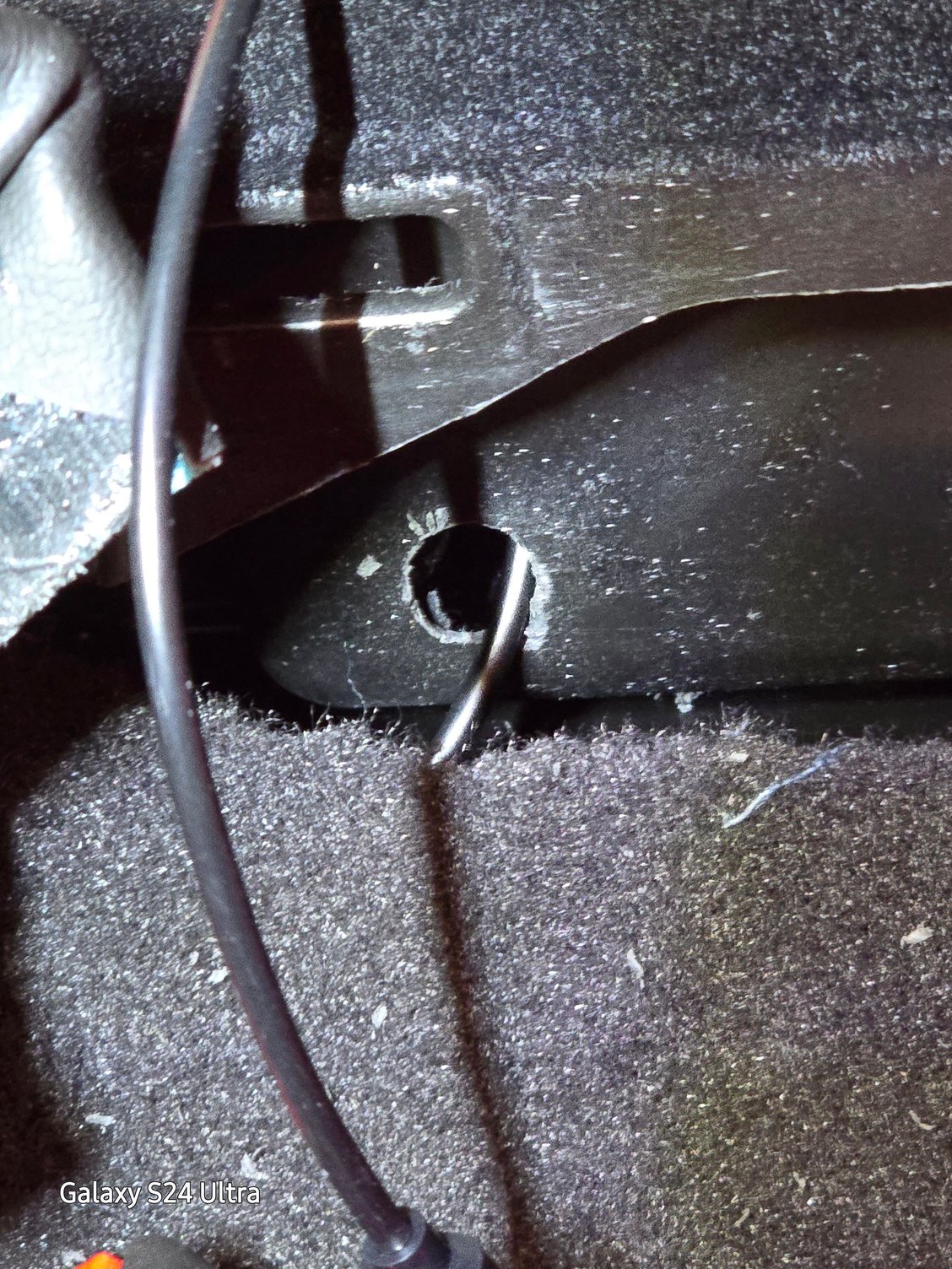

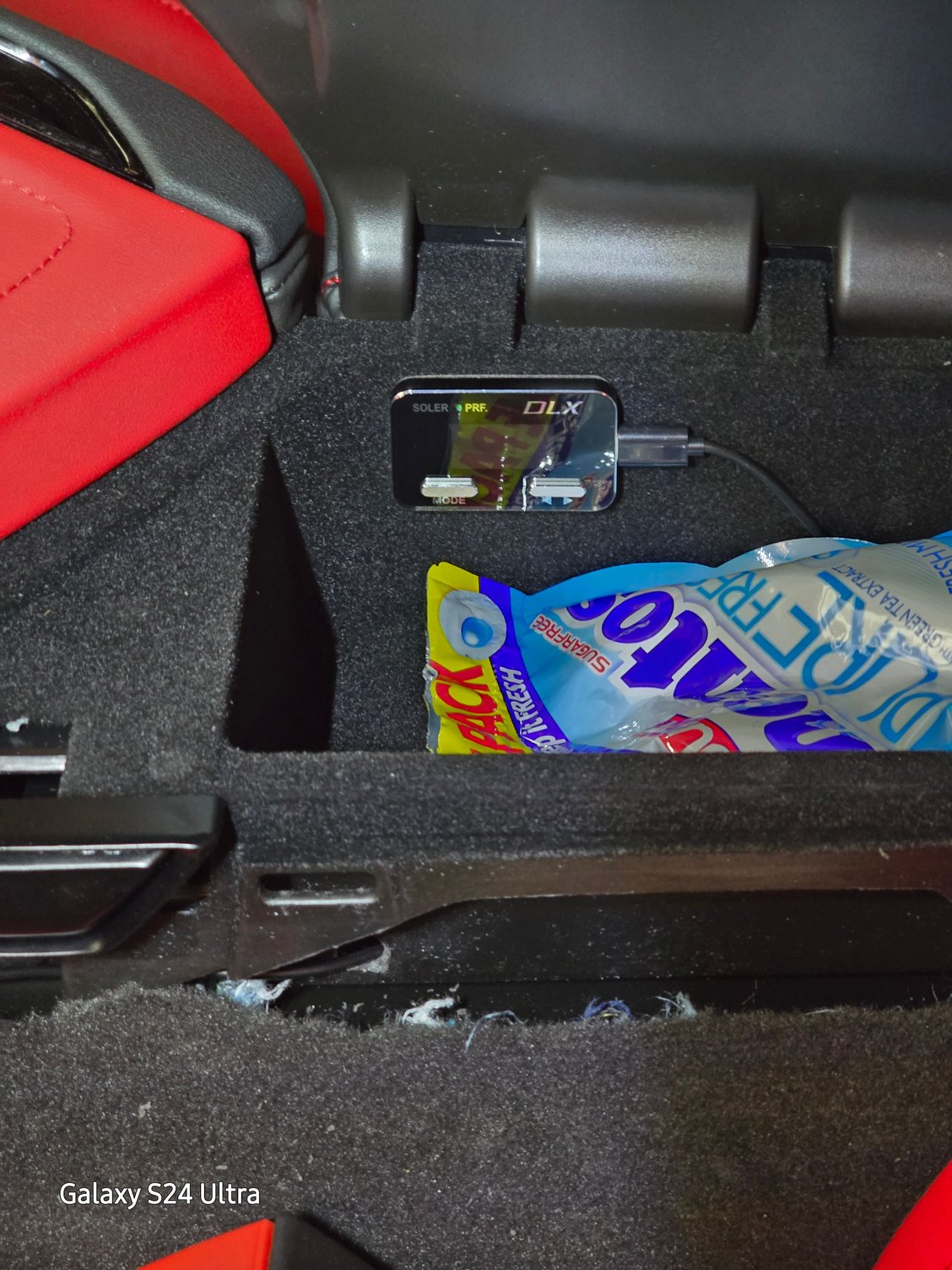

Just wanted to share my install of the Soler throttle controller. I located it in the arm rest console.
After removing the gas pedal and attaching the throttle controller. You can tuck all the wires underneath the carpet via hole/slot from factory.
Just unsnap trim along center console to feed wire to console.
Drill a 3/8" hole for usb-c end to fit through.
I unhooked battery instead of waiting for 10 minutes like instructions suggested.
All and all took around 20 minutes.
Hope this helps anyone who like me, didn't want to locate the controller in plain sight.
Cheers

Looks good.
I just leave my wires tucked under the carpet and controller is at home in a drawer. Only use my phone app connection through Bluetooth. 👍
