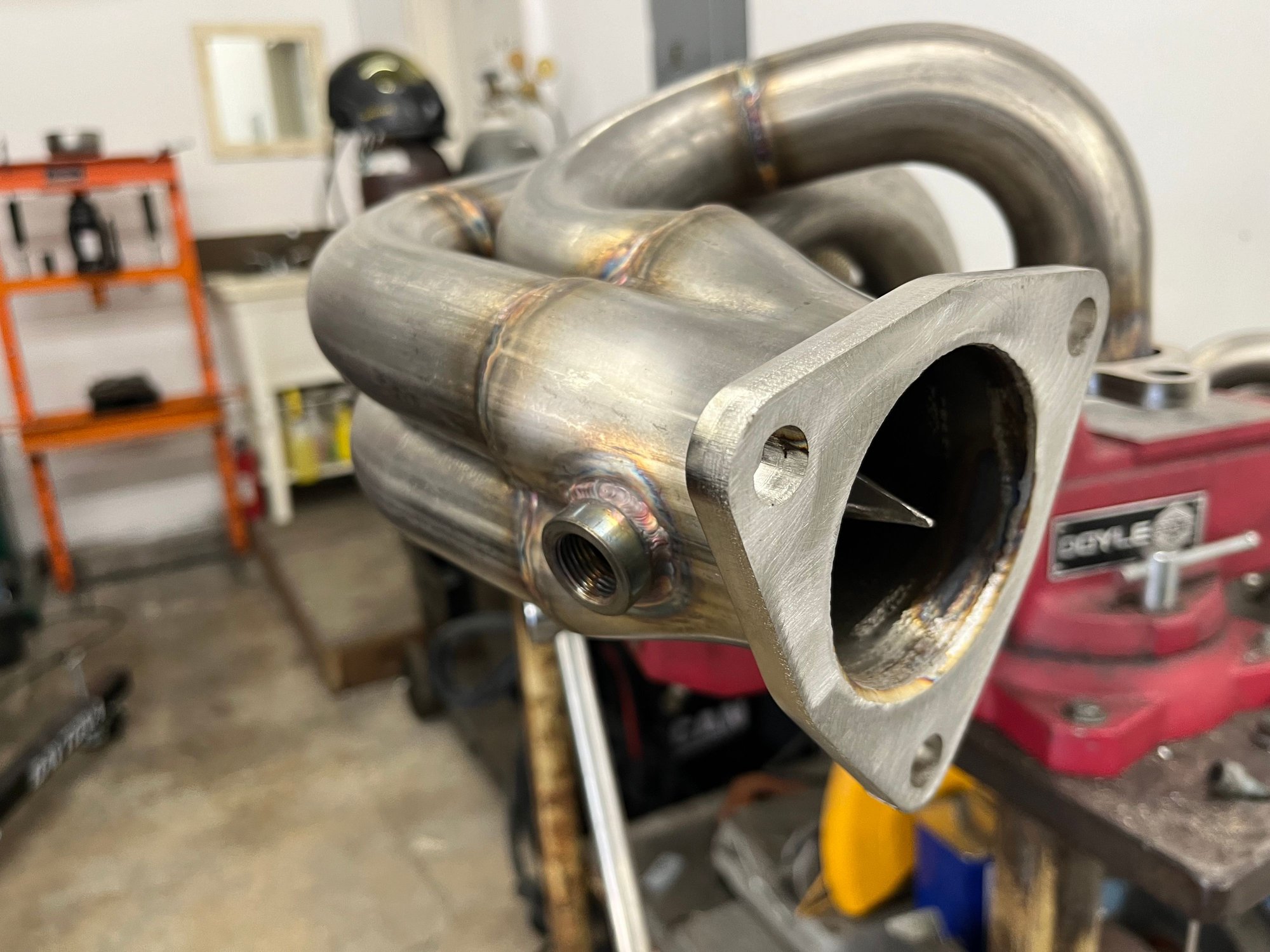

If you are installing a FI unit ie; supercharger headers will definitely improve hp, and performance. If you purchase the right headers. I’m impressed with the east coast headers comparing side by side to factory. I’ll post some pics to show the differences. The wider collectors w spikes will provide better flow.

Here a some pics of the east coast superchargers custom headers. The supercharger is on, and engine back in. Just waiting for ECU from HP.

Good looking headers! Nice merge. 4-1 for top-end over mid-range?
Glad you have thermal protection on them!

Thanks Kracka, they did a nice job wrapping the headers.. The shop is doing a great job, and are being extremely meticulous. Apex performance in Smokey point, Wa. Will keep updating. A big learning curve for me, and the shop are very good, and have engineering degrees. Keepin the faith. They rocked my Hellcat, earned my trust.
supposed to be bigger midrange gains, then top end. 30-35 mid, and 18-20 top end. I prefer the larger mid gains..
