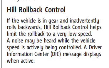

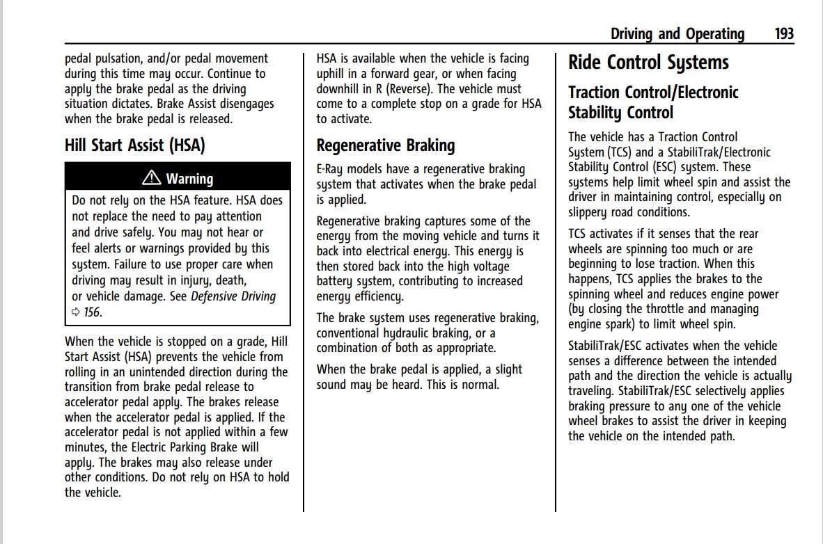

From the owner's manual

Renamed to Hill Start Assist in 2024 OM.
