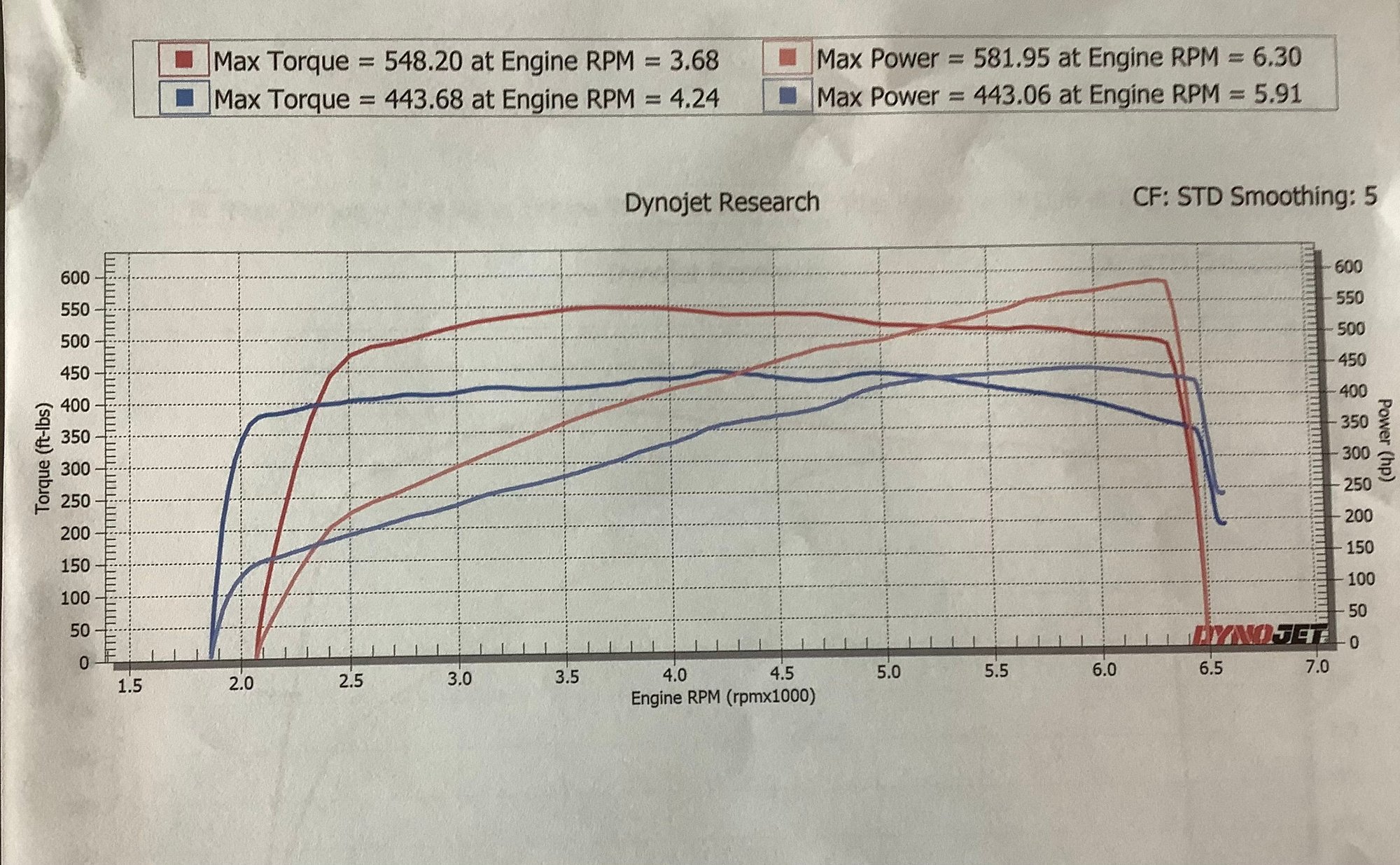

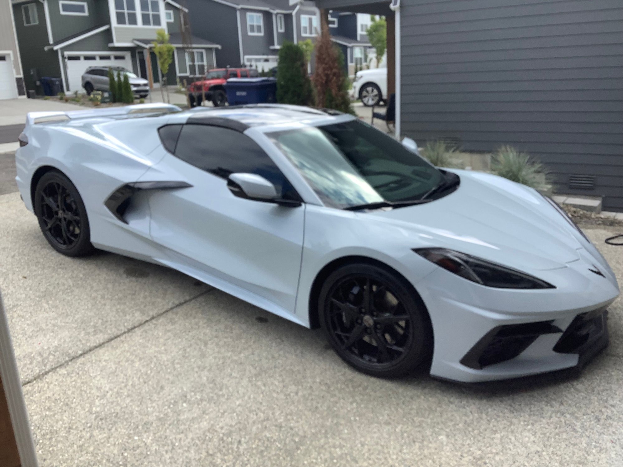

Hello all,, just an update.. I got my baby back today. The car runs like a rocket! It took about 30 days. Installed by apex performance in Marysville, Wa. Here is the final dyno sheet. Dyno tuning was remote from Paragon. I’m extremely pleased with the set up👍🔥
we saw 587 rwhp on one pull but this was the final.

If you stared out with 495 HP at the crank, it looks like you ended up with about 650 HP at the crank....don't they promise 700 HP?

Ended up 700+ crank.. I’m happy. Actually710. Using 20% for auto trans, 15% for manual

How did you get that number?
Let's assume your C8 engine made 495 HP at the crank. The dyno chart showed 443.06 HP at the wheels:
443.06 / 495 = .895 (drive train losses)
If you take the new wheel HP number, 581.95, and divide it by .895, you get 650.22 HP.
If you believe that 581.95 wheel HP number translates to 710 crank HP, that stock 443.06 wheel HP number translates to 540 crank horsepower. Do you think the stock C8 makes 540 HP even though GM says it makes 490 or 495?

Anyone here think the C8 Stingray with the uprated exhaust makes 540 crank horsepower?

chassis dyno sheets sure are cute
What would you like it to read…. Change this, change that…. Correction factor this, and that.

I am assuming same settings and correction factors. If that Magnusson supercharger setup makes 710HP at the crank, then the stock setup makes 540HP at the crank. Is GM conservative with the C8 Stingray HP ratings or are the Magnuson setup numbers optimistic by a healthy amount?

I’ll go with optimism on #2.

I think they are a little conservative, DCT's don't soak up as much HP as tradional auto's, but a ~10% power loss to the wheels is really efficient, you'd expect 420ish at 15%...i think the LT2 is probably more around 505-510 hp

I think they’re conservative as well. I gained closed to 150 rwhp with the Magnuson. I was running low 11’s before the install. Hoping for 10.7’s. I’ll be fine w that. Anything faster I’d be extremely happy. It’s a 91 octane tune which is obviously lower hp than the 93 octane they’ve been using for their advertising. I am running headers, and halltech CAI.. I believe the tune is very tame. Ie not aggressive. The car feels great, sounds like a mean beast. Hoping to run on October 5 at the strip. Wx permitting. Will post numbers good bad or ugly 🍻

As someone who has built a few cars and used A LOT of dynos for tuning those figures are incorrect but if it makes you sleep good more power to you.

This is closer to the truth. He probably has about 660 flywheel hp. You loose a bit more to the rear wheels the more power you make but you are just about spot on.
