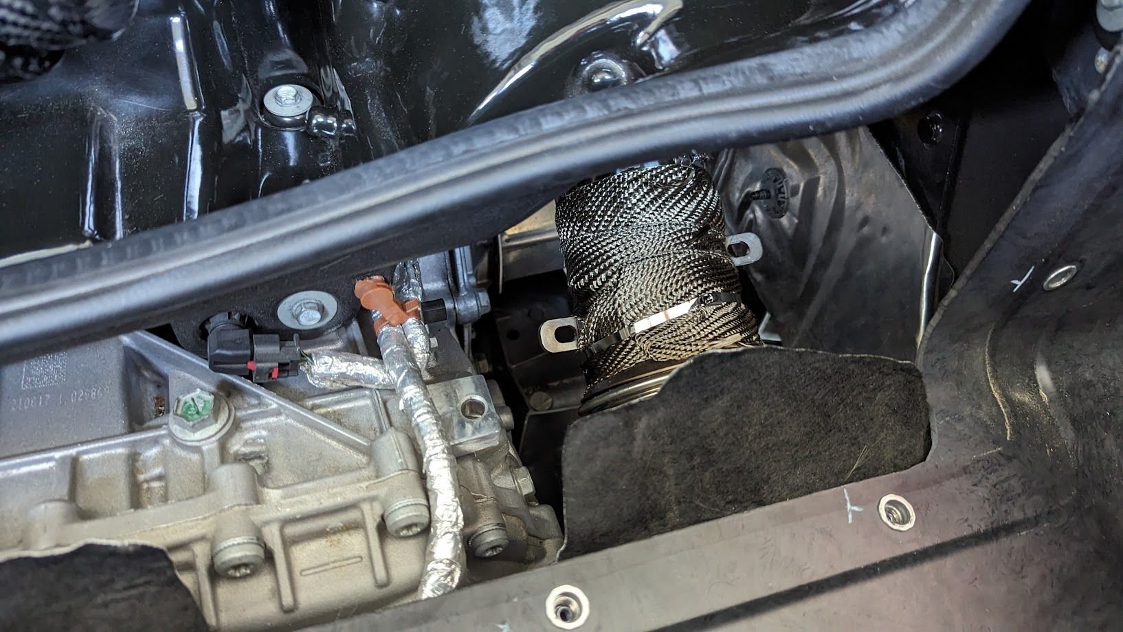

Back to your initial question though, the Borla has very good heatshielding as it is, but ceramic coating it would only help. I personally have Cerakote Titanium ceramic coating on my headers & cats, but did use DEI Titanium exhaust wrap on the inlets to the Borla to better protect my intake.
If you do go the ceramic coating route, I'd recomend an air-cure such as the Cerakote Glacier Titanium C-7900 (which is what I have on my Corsa cats):
