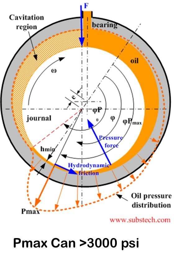

Worse thing for an engine is starting. ~35 psi oil pressure does nothing to keep crack and rod bearings apart from the crank. It's just an indicator there is oil available at the junction! And it takes a few seconds to get to ~35 psi after a start. BUT the key to long life is the hydrodynamic oil pressure that builds with rpm.
BTW 6600 rpm is not like a 10,500 rpm in a 500 cid NHRA ProStock or 15,000 rpm F1 Race Car engine! Both limited by rules. ProStock engines were hitting ~13,000 rpm. Recall hearing a 1 year old Michael Schumacher F1 car at Laguna Seca driven by a Ferrari test driver when max rpm was ~20,000 rpm.
Yep that oil pressure in the film that develops can be ~3000 psi!
