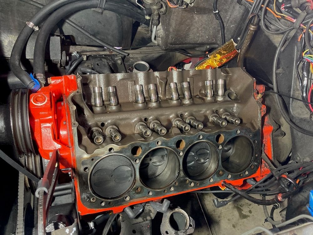

A couple weeks ago I wiped a cam lobe (#5 exhaust) in my 270hp/350 71. There was a Lunati cam in there and maybe it wasn't set up right. Simultaneously on the same day and on the same trip that I was almost stranded due to the failing engine, my TH400 also stopped shifting out of 1st. It seems like it might even try to shift out of first and then into neutral. Wow, such luck! Simultaneous engine and trans failure!?
The failed cylinder #5 in the motor is severely scored with cupped lifter, all intake valves are caked with piles of carbon and the inside of the manifold is wet/oily. Actually all cylinders are scored but #5 is the worst.
Working in my garage on jack stands, I will be removing the motor to drop off at the builder. I guess I should also remove the trans to drop off at the trans shop. I am seeking advice on how to remove the trans when on jack stands (I would love it if someone could inform me that maybe the trans is not shifting cuz the motor was failing and vacuum was messed up.... the simultaneity of all this is perplexing):
