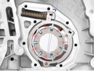

FWIW, It's actually a "variable oil volume pump." The result is variable pressure reading.
Pic is from the C7 but interesting way they vary the volume. All controlled with a micro based on a number of inputs:

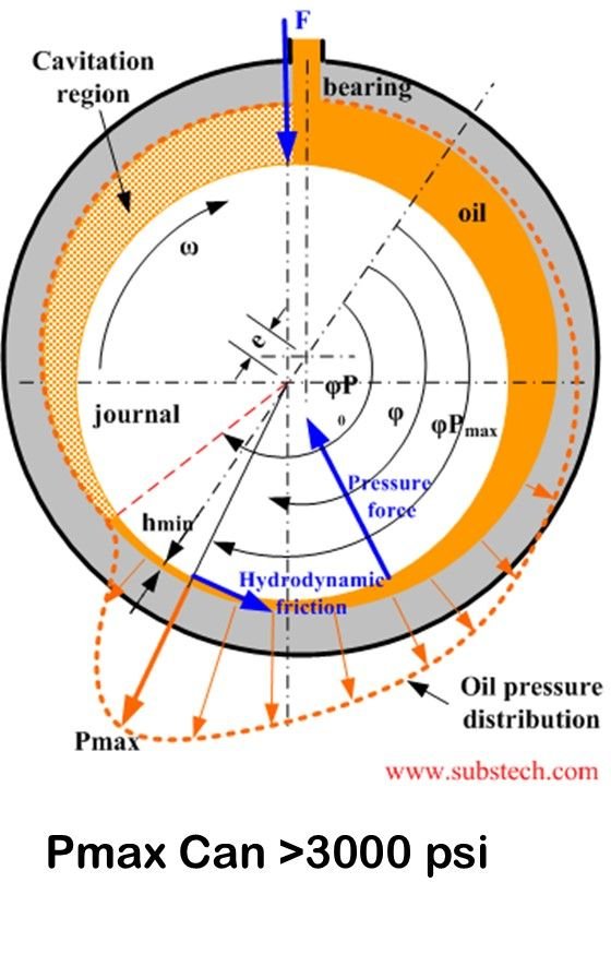

The actual "oil pressure" needed in sleeve bearing is much higher that the oil pressure reading. The key is the pressure you read only has to be high enough so oil is present at the rotating crack/rod journal to create the hydrodynamic pressure that keeps them from touching.
