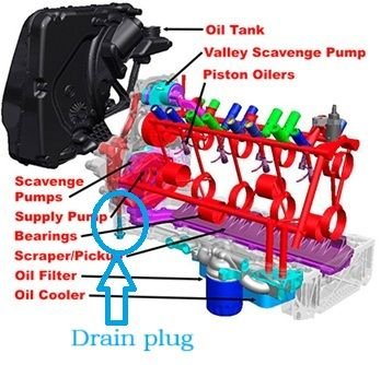

Based on this image, I am making an assumption that the small o-ring on the tip of the drain plug seals the reservoir and it segregates the sump (dry) from the reservoir/pressure circuit. When removing the drain plug the oil in the reservoir flows into the sump and then out to the drain pan.

When the engine runs, within 20 seconds or so, any oil in the oil pan will be returned to the tank on the front of the engine. There is almost no oil in the oil pan. When the engine is off, oil will slowly (very slow) seep down to the pan, and that is why we check the oil when the engine is running. The oil drain plug, when removed allows oil to drain directly from the tank into the oil pan, and then out of the oil pan. The upper gasket, if it is missing, will allow oil to drain from the tank into the oil pan more quickly. I don't know how much more quickly. But I think it could be a problem if there is excess oil collecting in the oil pan - since it is designed as a so-called "dry sump".
