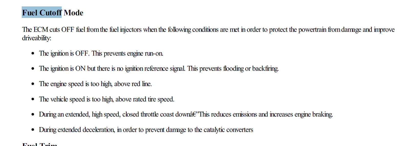

Default fuel cutoff mode
The car does have a fuel cutoff mode that may activate while coasting. I have seen on the forum some debate whether the so-called injector noise is actually the fuel injectors or the fuel injector pump. While fuel to the cylinders may cutoff during coating, I think (but I did not search throroughly) that the injector pump probably is still pumping to keep fuel pressure up.
To Lifter tick 2022 C8

The problem and misleading part of the shop manual there is "during an extended, high speed, closed throttle coast down". There is zero definition of those parameters. Is extended a 4 mile downhill section? Is high speed 90 MPH or 150 MPH? In normal driving it doesn't shut off fuel. Run one in manual mode and hit the rev limiter, you'll bounce your head off the steering wheel. The LT2 runs over 2,000 PSI of fuel pressure, those injectors tick pretty significantly.
If it was the injectors the tick would be louder under acceleration. They do shut off when coasting. It's how you go from say 15mpg to 99mpg while at say 5k rpm for example. The injector excuse is pure BS imo.
Mostly, I'm worried this problem will become bad like it did before after i go out of warranty in a couple of months.
