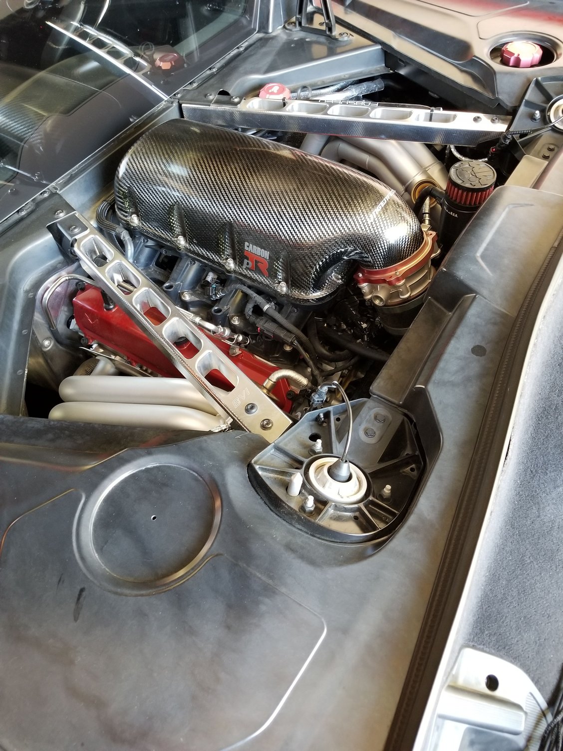

You have the AFE CAI, go with matching your Soler throttle body with a ported manifold or the even better the Carbon pTM manifold. Contact Mike at Soler, he will likely recommend swapping out your Soler 91mm with their LT5 95 mm and adding their very well appreciated C8 Soler Throttle Controller. This setup will bring out the very best of your AFE CAI and Borla exhaust. Read up on the C8 Soler Throttle Controller, probably the best mod for the C8 at a remarkably low price.

Pictured is my LT2 Carbon pTR Intake Manifold matched with a Soler LT5 95mm Plus Port Throttle Body.
