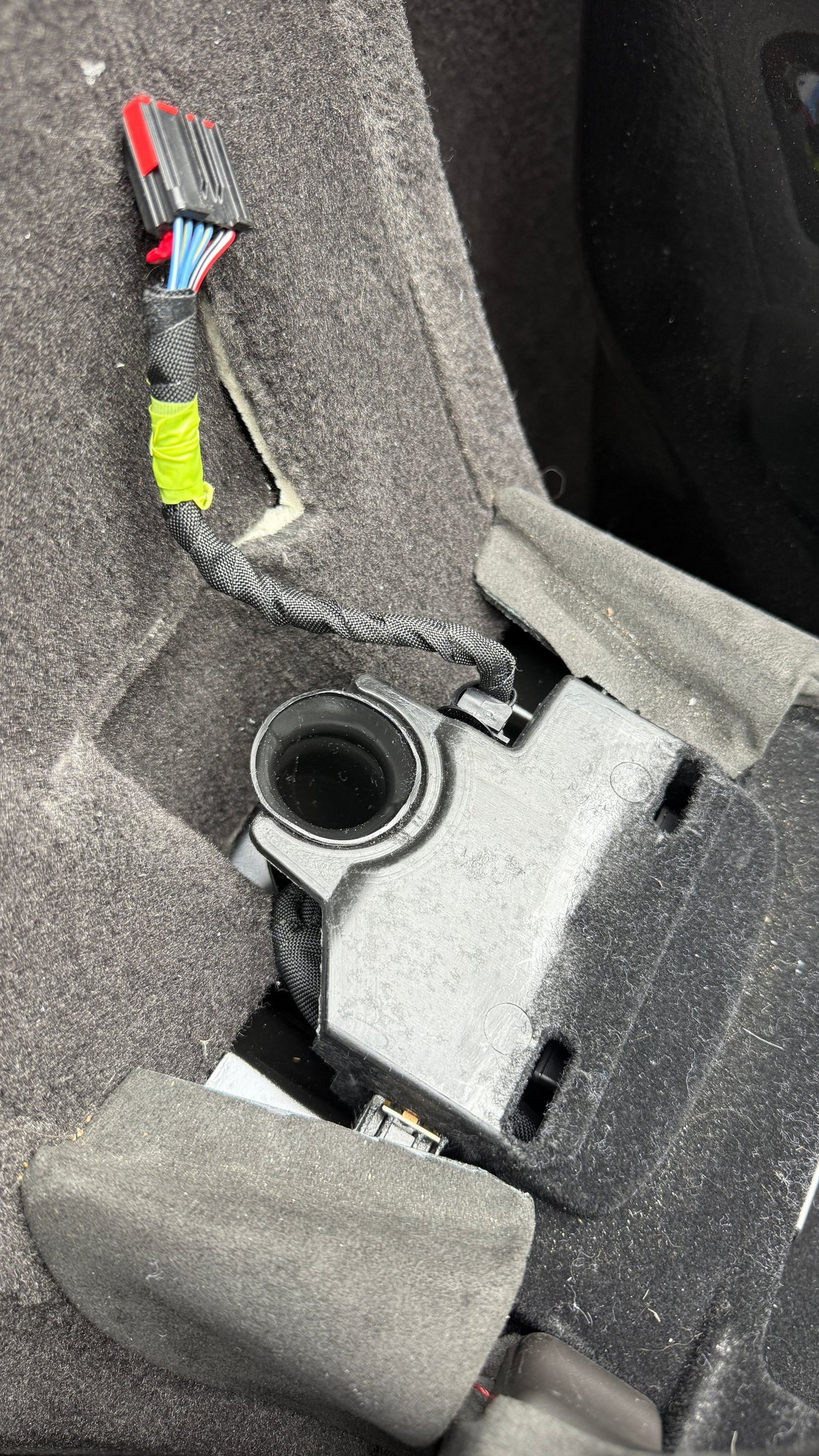

There seems to be some kind of drain under the center console fuse box.
it doesn’t hold much water and doesn’t seem to drain to the outside.
Once I cleared the water by stuffing a rag, the noise went away.

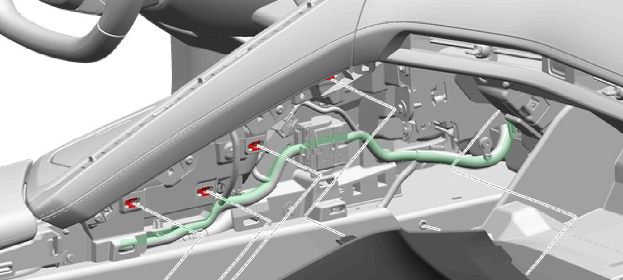

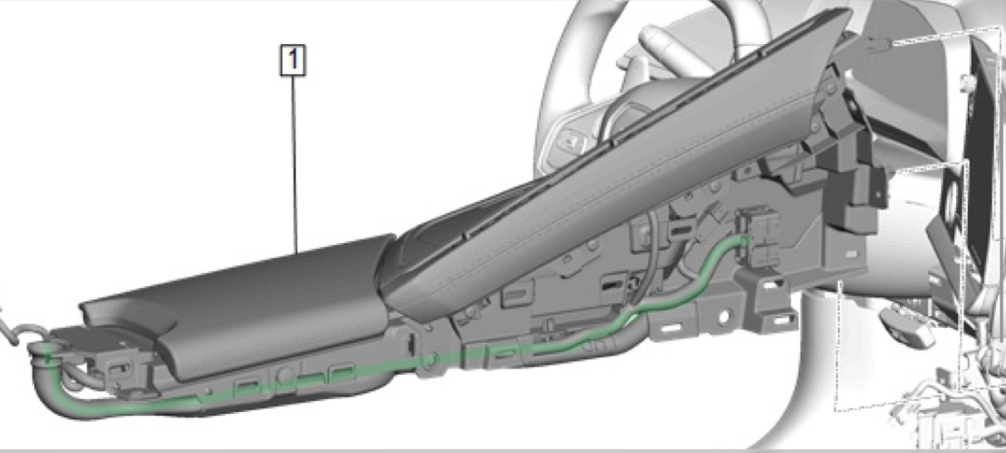

I don't think that is a drain, and it should not have water in it. I think it is a duct to provide cooling air to the inductive phone charger - but I'm not sure. I am pretty sure I ran across it in the Service Manual, but I have not found exactly what it does yet. In the meantime, here is photo that shows that opening and the tubing that connects to it, that runs toward the front of the car.
I'm still looking, but I doubt very much its a "drain" because of the way the tube runs toward the front and upward. Edit: I do not know if I am tracing the tube route correctly once is runs under the console assembly. I found other view that also show another pipe or tube running under the console - I'm not clear yet on the exact path.
