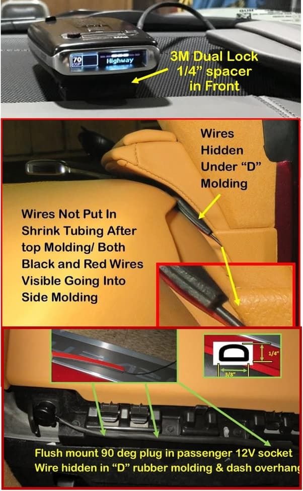

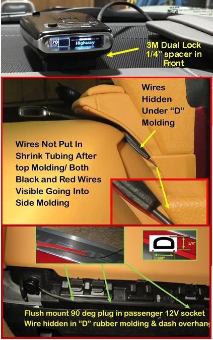

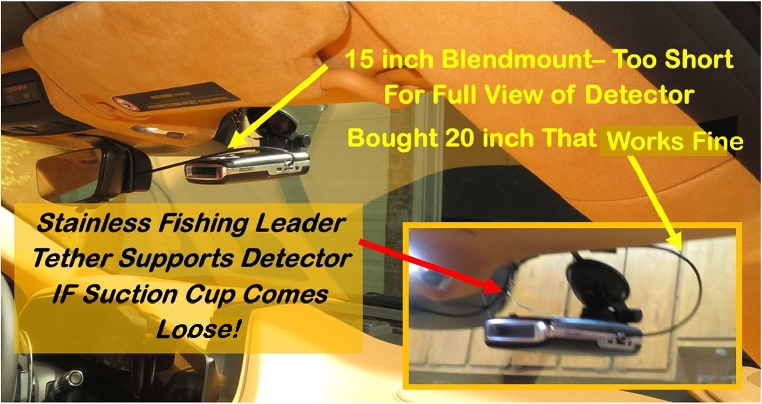

FWIW, I have a 10 year old Escort Passport Max. They have newer ones with additional features. I mounted it with their "Sticky Mount" single suction cup to the right of the mirror on my two C7's and for 3 years on my 2020 C8. Then switched to a Dash Mount I like much better. I use 3M Dual Lock, 4 times the holding strength as Velcro (It's my go to product for many things.)
Here are some pics including the Dash Mount on my E-Ray where I wired to the 12 volt receptacle under the passenger dash (automatically switched on when car starts.) The plug mounts flush with a 90 degree wire so no interference with the passenger legs etc. Wires hidden until they come out at the windshield. Easy to remove when and if needed. This is a many page Pic's Long Captions with full details: http://netwelding.com/Radar_Detector_Power.pdf
Switched to a Dash mount in my 2020 C8 and continued with my E-Ray. Note: mounts on black plastic section of Dash. Love it.

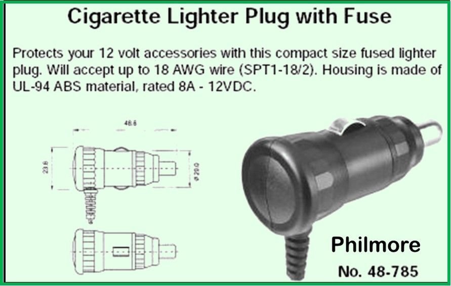

Much better (and far cheaper) to power from the 12 volt receptacle under the passenger dash. It uses zero power when engine is off. This 90 degree plug I use fits flush and no wire to interfere with passenger legs.
It's fused.
Can route the wire out of view as I did until it comes out at the windshield. Can place close to the windshield where it is not visible until it comes forward to wherever you mount the detector. Like what you describe, I use a phone plug that fits my Escort detector. This is a Doc that shows what I did: http://netwelding.com/Radar_Detector_Power.pdf
