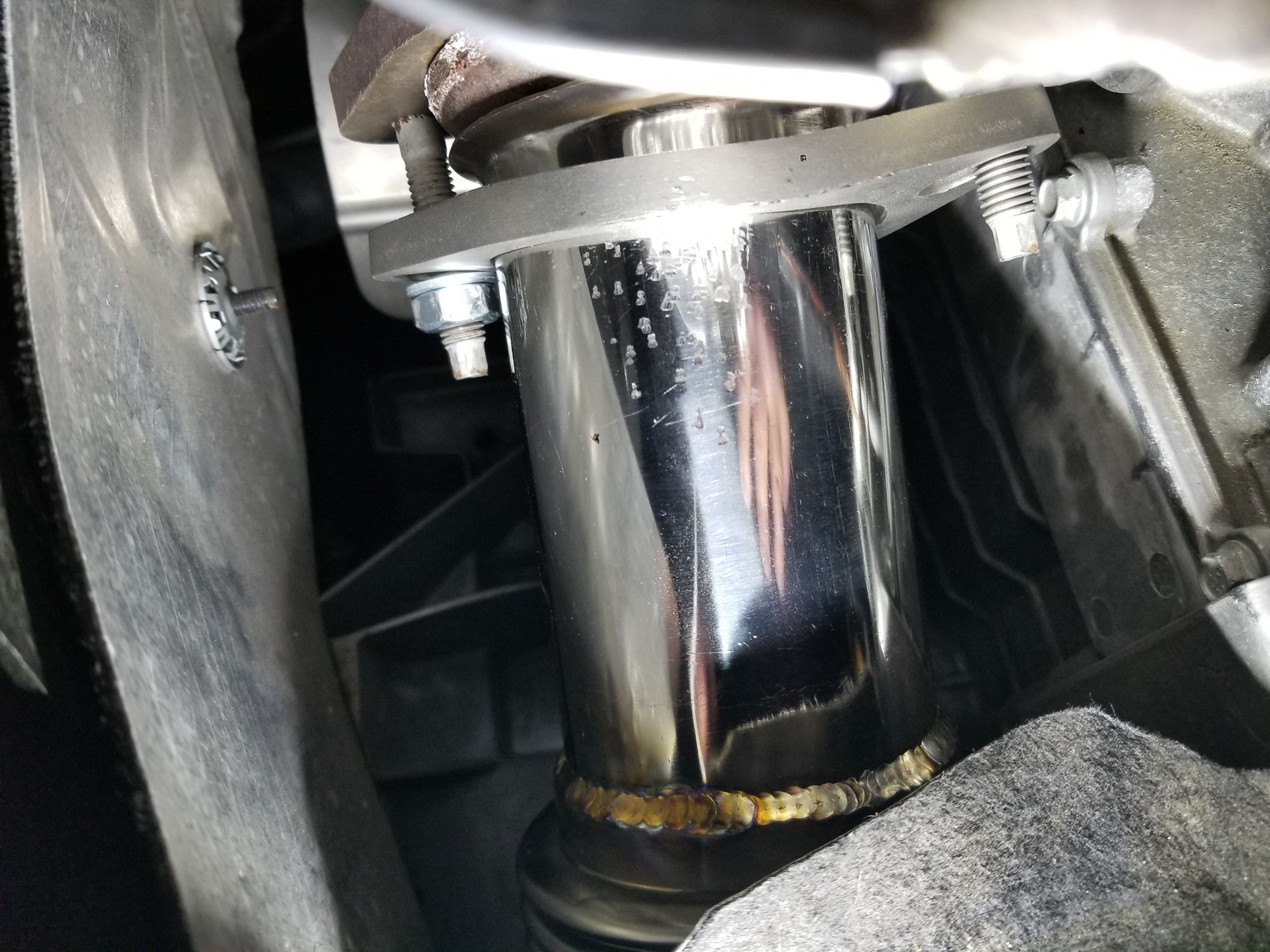

Well, I screwed up my catback installation and thought I'd share my experience while also seeing if anyone had anything to add before I get my X-pipe back with the flange fixed so I can put it on (hopefully the right way this time.
I put everything together and started the car. Nothing sounded wrong but I panicked after the install was done and got paranoid I did something wrong. I'm pretty sure now it was (maybe with a slight exhaust leak), but I noticed a few things:
  1. When I looked down I saw that the driver's side looked… not on all the way. The videos I watched didn't actually show a top view of the flange, so when I saw the driver's side spaced out and the passenger's side flush, I assumed the driver's side was also supposed to be flush. I later learned that this is not the case as the flanges are different for each side, but not before I took a hammer to try to maybe straighten the flange on the pipe and move it up so I could get it to sit properly... didn't work obviously, but I was panicking at this point. I took a picture and sent to a helpful Facebook friend (shoutout to Ciro Papi, he is a vendor here, Corvette Exhaust Systems) and he mentioned...
  2. … that the flange looked bent. And it was, after looking from the top. That was clearly not a good thing. Also…
  3. … one nut/washer were flush and the other nut was crooked. I used nut/washer combos because I couldn't find new M10 flange nuts at Ace Hardware, but have since found them at Lowe's for my second attempt.
I don't have a picture of when the nuts were tight, so it may have been on the donut all of the way.

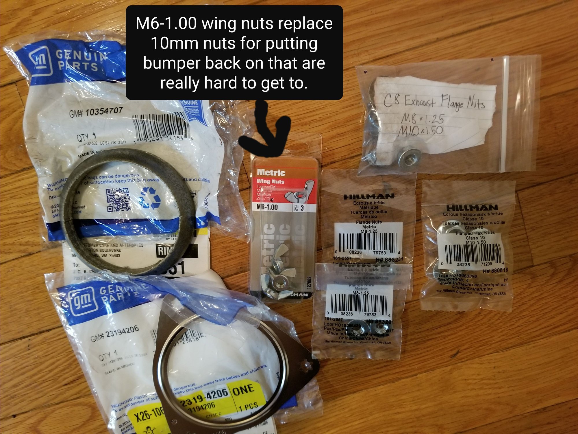

Further, Ciro asked if I remembered my new gaskets. Uh… what gaskets? At this point I tore everything down, bought gaskets and new/better (grade 10 vs 8) flange nuts, and dropped my X pipe off to the mechanic to get the flange repaired or replaced so I can try this again with a new OEM driver's gasket, new gaskets, and hopefully a complete understanding of what went wrong.

What may seem common to someone used to working on cars is that for something like a flange, you want to tighten down one side a little bit at a time instead of one all the way and then another. I thought I was being conscious of this but I may have been careless and tightened one side too much, too quickly. I have to be careful doing this again with a loose hanging flange like this driver's side to do a little at a time per side before the final torque.
Flange Torque
In Serhan's Garage's video on YouTube, he mentioned a torque spec of 35 lb*ft. I did this and my mechanic was telling me that honestly, he just snugs these down when he does them. Going from the bottom with a bunch of extensions and using this torque spec might have been too much and that's why the flange bent. I need to be careful not to over tighten as this flange can apparently be bent without even using impact.
Gaskets
Something that was not mentioned in the videos I was watching for instruction was that both connection points from the catalytic converters to the catback pipes have gaskets. The driver side is a "donut" style and the Passengers side is a thin piece of metal that sits between the two flanges. The donut on my car was there, but pretty beat looking and one should take the time to replace it if already taking this pipe off anyway. However for whatever reason, when I assembled the passenger side, there was no gasket there. Either it fell off and I didn't find it on the floor of the garage or my exhaust has been off before and there was no gasket out back on. Either way, I'm glad I had to take everything back apart because I could replace the driver's side donut and rectify what probably would have been an exhaust leak on the passenger side.

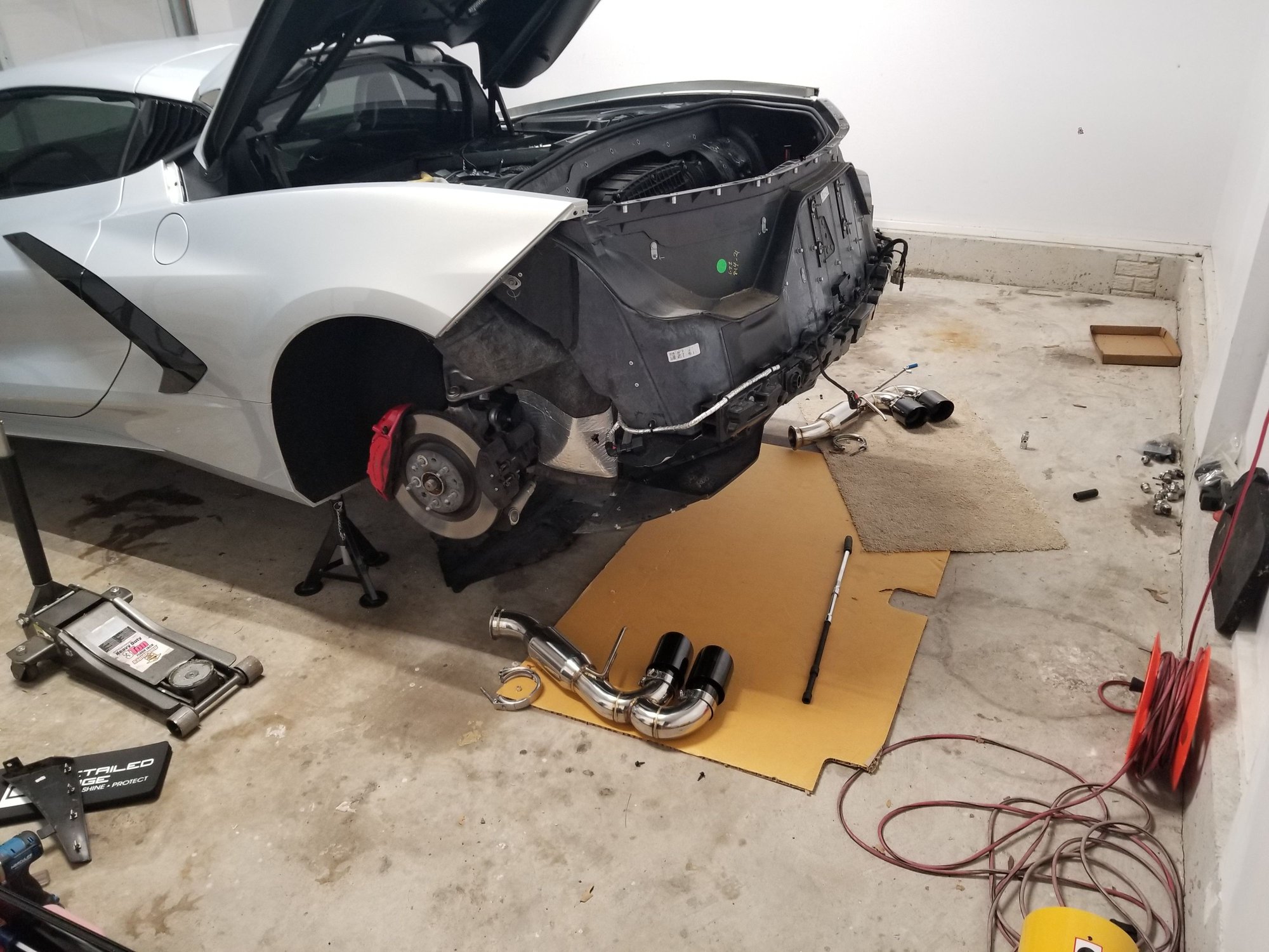

Warned? I was already done with the bumper back on before I realized it was leaking lol, I've already taken videos of how to get to all 5 nuts and my second time taking the bumper off was actually easy, minus a stubborn electrical connector I did myself a favor and took a video removing the second time around. I made a checklist of all of the torx and 7mm screws/bolts and the 10mm nuts (which are being replaced by wing nuts!!!), and it took me probably 20 minutes with an electric ratchet and a handle of vodka (because I was so pissed off I had to take the bumper off again, but don't work on cars drunk folks, you will wind up with a hammer in hand and not remembering why...). I'm absolutely ready with my extensions and ratchets to get this X pipe on tomorrow evening, already told my boss I'm taking a half day.
The fender liner peeled back and bumper off along with the panel in the trunk removed of course seems to be enough. Paragon made a video in which they reach over the axle and past the shock to get the bottom pass side M8 flange nut from that side, but it's hard without the fender liner entirely off. I may try tomorrow but I also have my own technique for that bolt. I use a ratchet with a ton of extensions and go from the left side of the pipe, reach my right arm around the right side of the pipe and align the socket and ensure it stays on while turning the ratchet with my left hand. The top two on both sides are easily accessible from the top on aftermarket exhaust because it doesn't have those bulky heat shields the factory exhaust has which severely limit ratchets from getting in there unless they have small heads.
