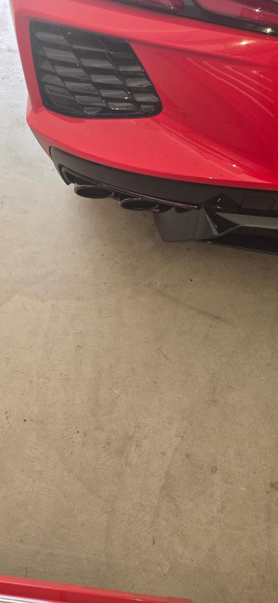

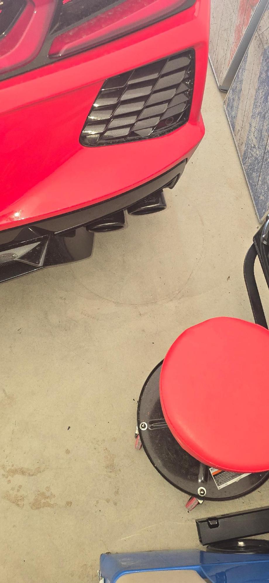

This exhaust system was a do-it-myself project, installed in December 2024. The alignment remains off and refuses to sit properly. Despite multiple adjustments, it doesn’t quite line up as intended. Looking for possible solutions to correct the fit. Definitely need someone with more skills than me. pics below

Update: I found a local shop—SC Motorsports here in Temecula. I was in and out within an hour, and the tips are aligned now.

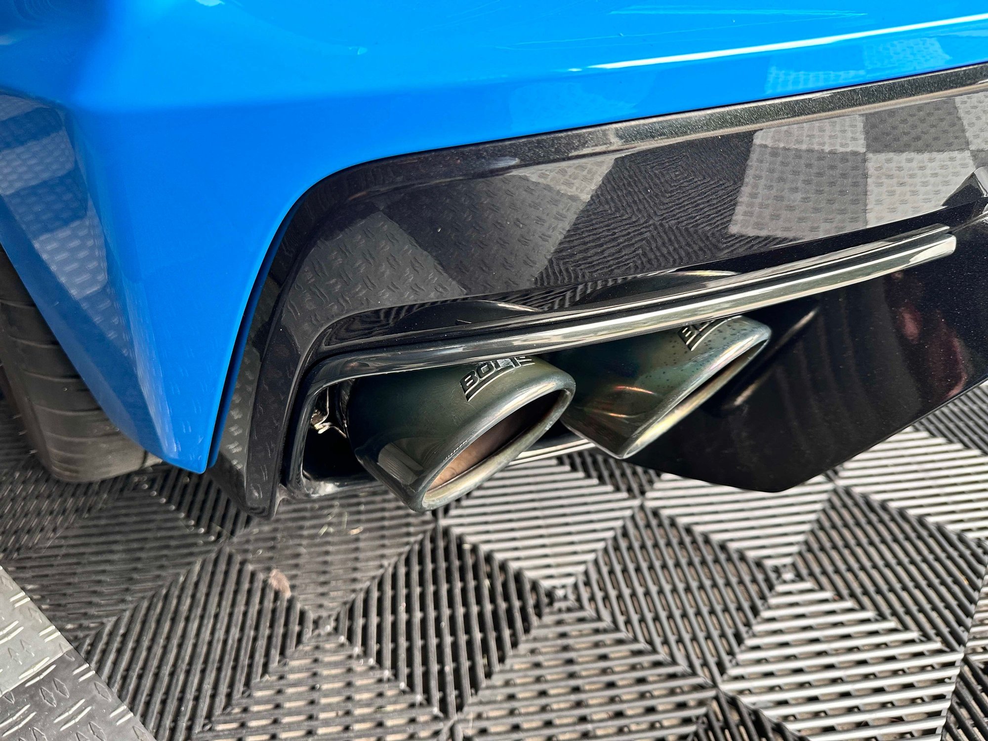

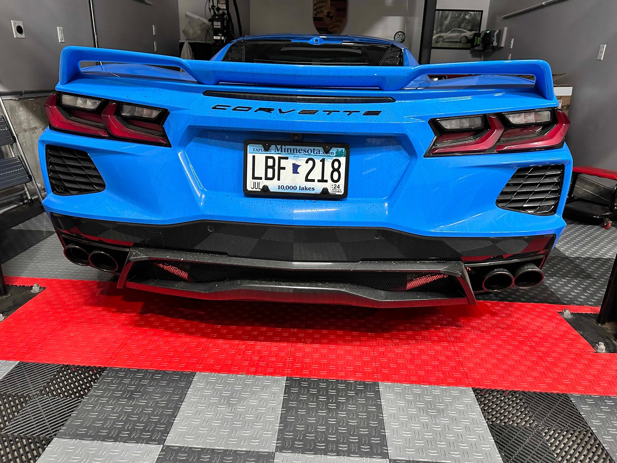

Can you tell me what they did? I have the same alignment issue with my Borla Atak exhaust. It's not super noticeable so I haven't done anything but if it's a simple fix I might try it.
Also, the black exhaust tips seem to discolor over time.
Thanks in advance.

I believe they adjusted the muffler hanger—they didn’t even need to remove my bumper. Like I said, I was in and out in under an hour.
That said, it’s disappointing to see the tips already starting to fade. I really like Borla, but I’m starting to question the overall quality of this system. I’ve got less than 600 miles on the exhaust and I’m already experiencing rattling on the right side.
It was suggested that the spring controlling the valve might already be failing. I’m now considering switching to a different system, possibly Corsa. I noticed their tips are replaceable, which might indicate a better overall design.
Thanks! I’ll take a look. Mine rattled too. The heat shield was the issue. It separated during shipping so something. Mine was bad enough that it interfered with the valves opening and closing. I wrapped the loose shield with a hose clamp and it solved the problem. Yes, I think given the heat shield and the discoloration of the tips the quality is an issue. Borla support though has been great.
for comparison the tips on my GT3 are still black like from the factory.
