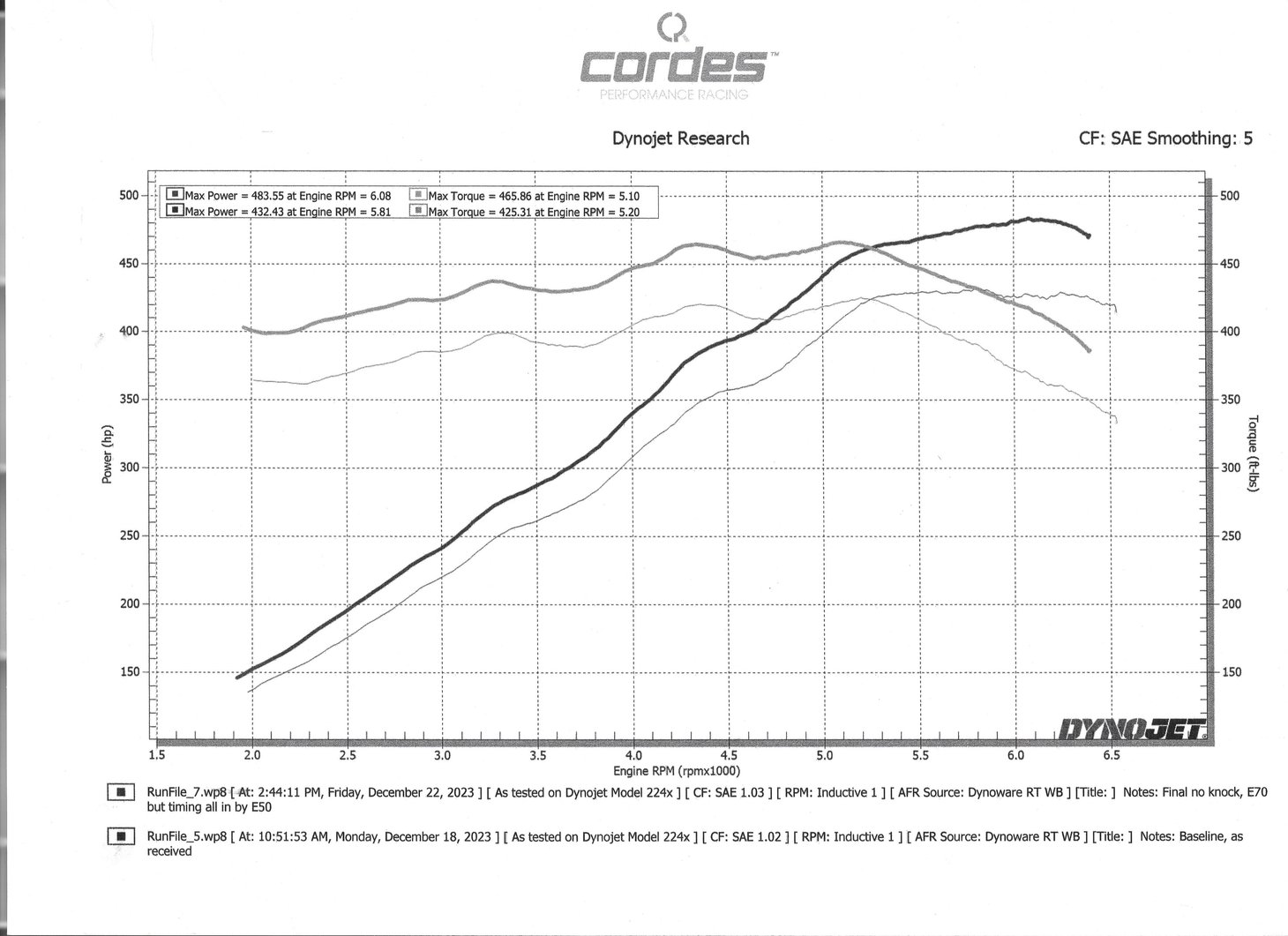

This is my C8 on E85 with only 91 octane. Would have liked to have numbers from 93 Octane but only 91 Octane exists in AZ.

Never seen a lower baseline but your right the baseline number doesn't matter when comparing for the increased rear wheel HP on a opened PCM that is Flex Fuel tuned to E85. With my prior C8 mods I was able with only 91 octane see a rear wheel HP increase of 51 and TQ of 41. Wonder what 93 octane would bring, which this car requires per my 2020 manual.
With an opened PCM, you can if you prefer, to Delete Stop/Start, Cold Start and AFM/V4, it's your choice. E85 does allow for cleaner injectors, valves and plugs which can especially occur from a DI VVT engine.
