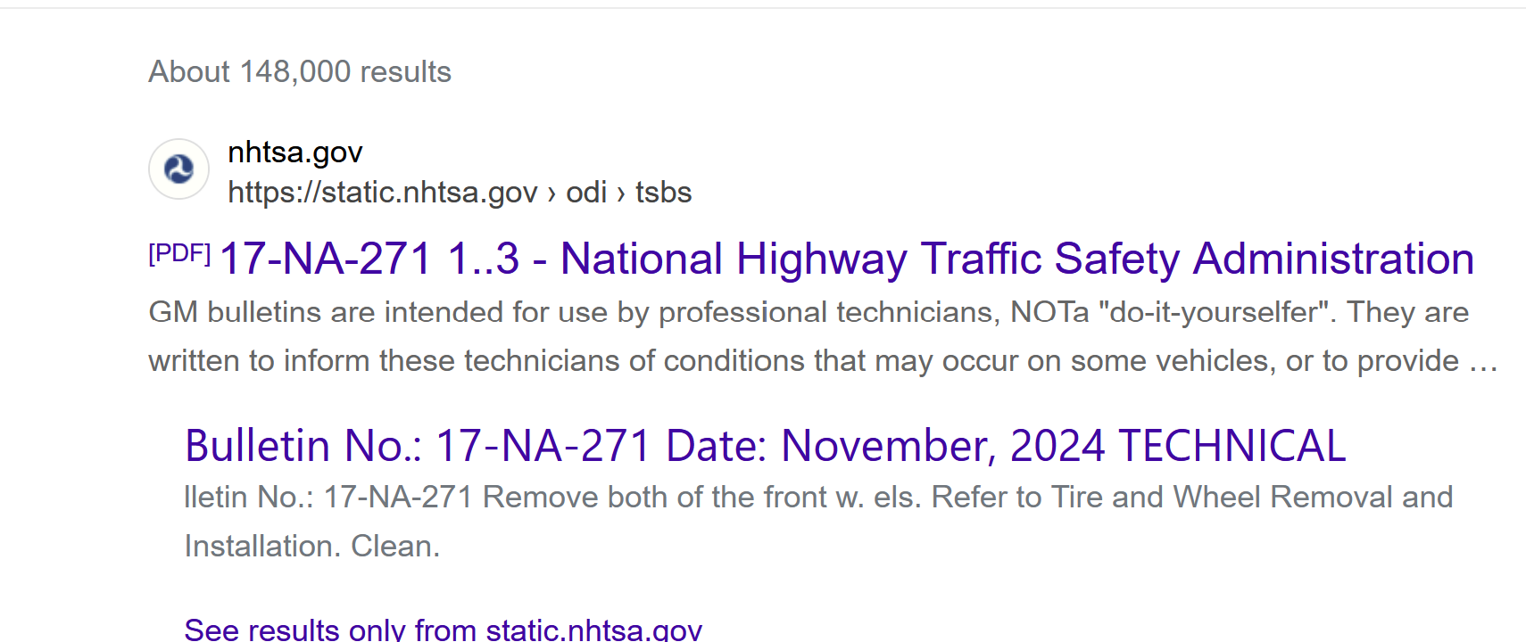

Default Fixed!
I thought I'd close this post out by saying I was able to get this fixed. Just to reiterate, in my case the sound seemed to be coming from the left rear, but I really don't know. Also, I was not going that slow when it occurred. It occurred when I was turning right at about 40mph.
The fix was GM Technical Service Bulletin 17-NA-271. It completely resolved the issue. In my case (2023 Coupe) the issue was covered under warranty -- which to me was amazing. I can't remember the last time I took a car in with an issue that was fixed, first time, under warranty.

I guess you're really lucky since that TSB doesn't include C8 Corvette at all.

It does. Covers Corvette 2014 through 2025.
https://static.nhtsa.gov/odi/tsbs/20...11990-0001.pdf
They revise the bulletins but keep the same number. This link is to a Nov 2024 version. And it is covered by the warranty if the warranty is still in effect. It has the labor code for it.

I'm aware of this.. So much for counting on Google to give the most relevant link upon a search since the top link is not the most recently released.

I use Bing. But it too did not have the latest one at the top. I learned this lesson a while back though when searching for bulletins - ya haf ta check em to make sure you have the latest one.
AI has similar screwiness all the time. I find it wrong as often as correct. But - it has those little footnotes that link to the sources. Often times (and I do mean often) it extract exactly the wrong thing. And sometimes, comically, its source will turn out to be a forum mss-statement. So, I find that AI is useful only as a way to find possible sources. The AI answers themselves are unreliable.
