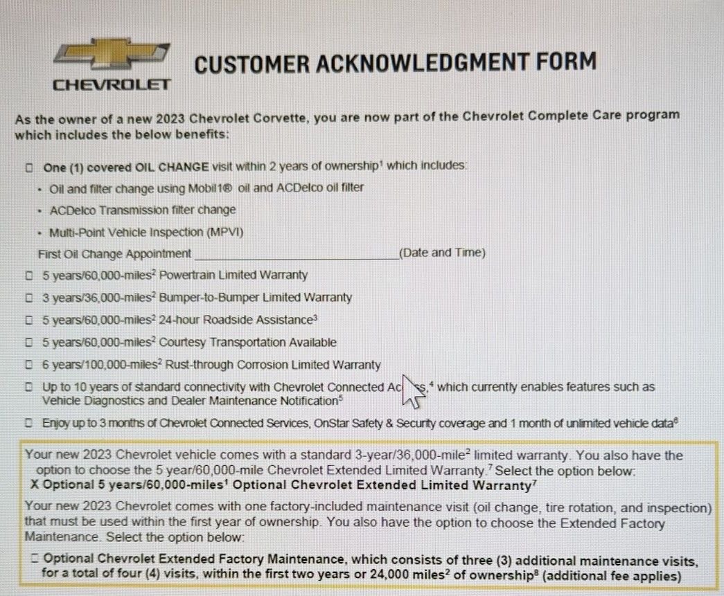

Old Jun 25, 2025 | 08:41 PM
wrecker3's Avatar
wrecker3
Joined: Nov 2003
Posts: 2,851
Likes: 1,871
From: NEW WINDSOR NY
Old Jun 26, 2025 | 07:20 PM
dharris45's Avatar
dharris45
Joined: Oct 2009
Posts: 861
Likes: 79
From: Clifton VA
Thanks, Wrecker3.
This looks like a form that should have been in the package of documents when I purchased the car. It is not.
May I ask where you got it?
Don
