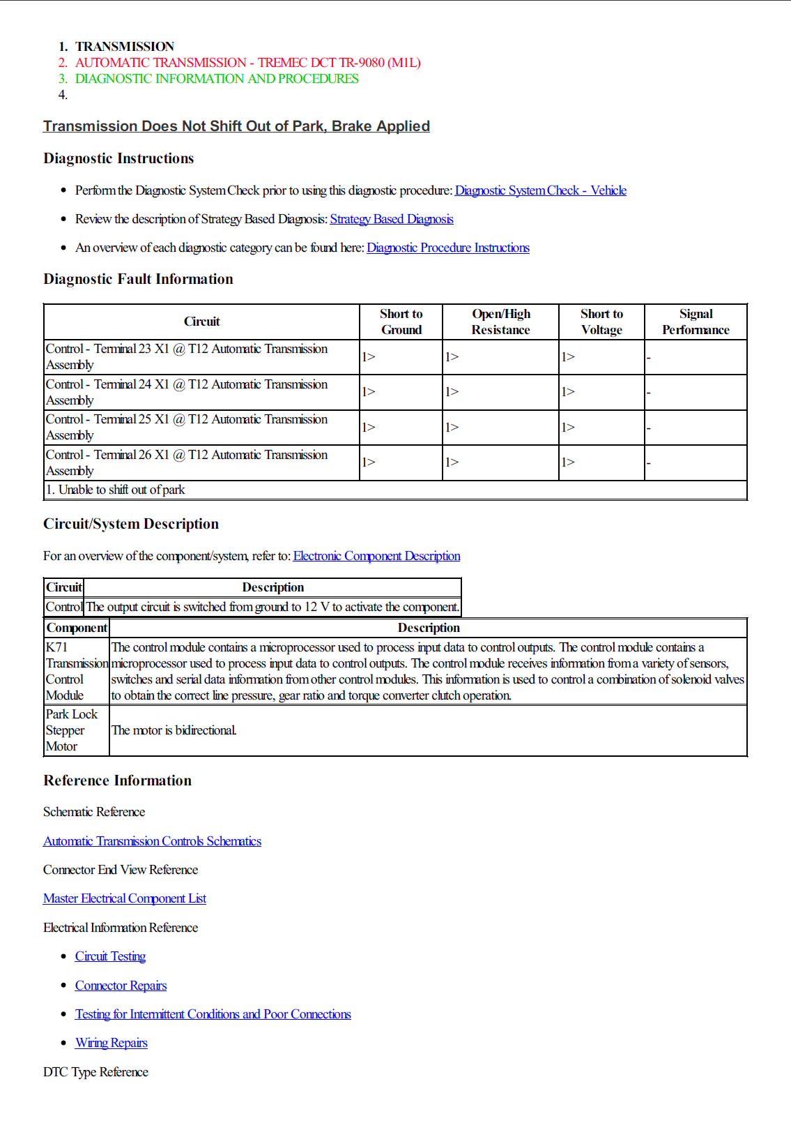

Never saw that part before, and the older version of the Service Manual that I have does not have a replacement procedure for that. It does, however, have some procedures related to the code that you have. And there may be other issues that are easier to fix. If you do not have a Service Manual I recommend you get access to the latest version. That will be your best bet for diagnostic procedures.
But here is what I found:
The code P07E6 does indicate stuck in park. The procedure for diagnosing it is bundled with several other codes. One of the first steps, if you have that code and only that code, is to check the transmission fluid level "Transmission Fluid Condition and Level Check" procedure. The next important step (again if you have only that code set and no others) is If "DTC P07E6 set
Refer to: Transmission Does Not Shift Out of Park, Brake Applied". So that goes to another different procedure. And that procedure includes checking for certain other issues - with possible remedies including repair of a harness, replacement of the TCM, and finally replacement of the transmission. It does not include a step to replace the park lock mechanism - but later manuals have added more procedures for repair of some of the internal transmission components. I'll attach that procedure I found - but recommend you get a later version.

That other code is Transmission Park Valve Stuck Off. And yes P0700 is just a request to illuminate the MIL. And there is a different procedure for that. The procedures take you down different paths depending on which codes or combinations of codes are set. But there are lots of things to check before replacing the transmission or the park lock unit.
I'm really surprised to see that part available. Looks like it comes from a salvaged transmission (says removed from a new transmission). Amazing!

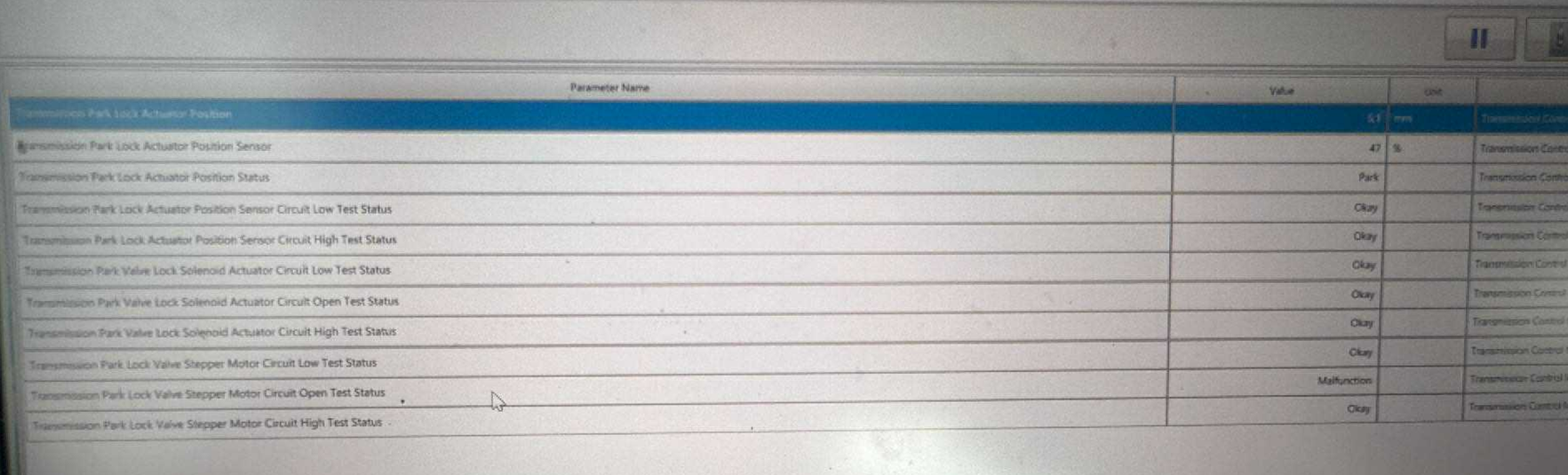

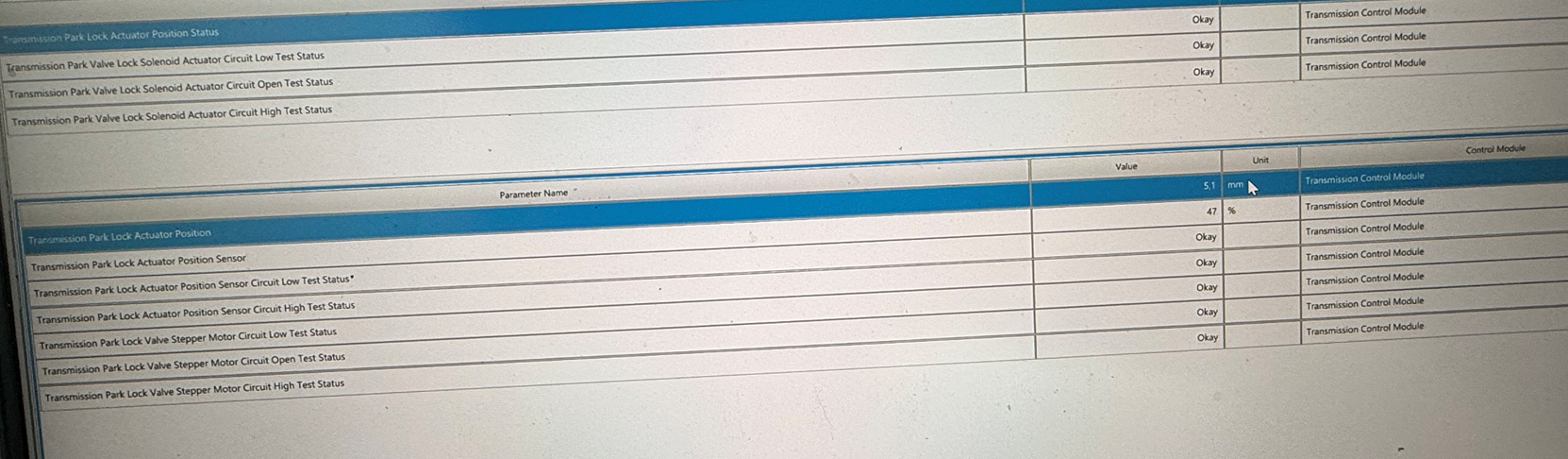

I have been looking little more into it, and i see this (sorry for the quality)
the first show 5.1 mm in tolerance anyone know if it is to much
second thing i found (dont see any dtc for it), say malfunction in park stepper motor
