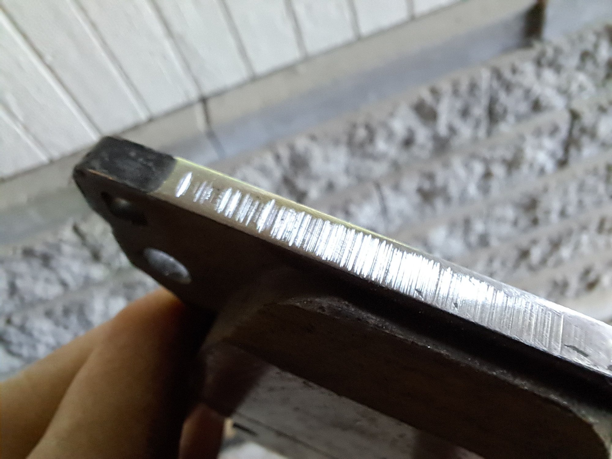

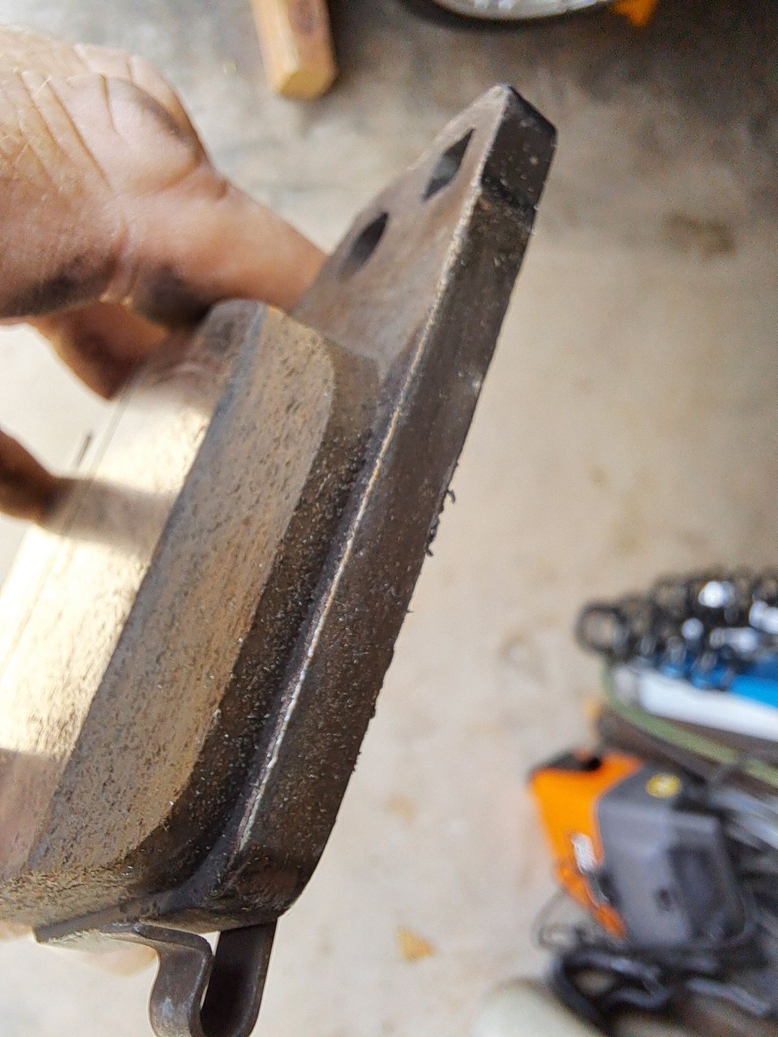

PROBLEM SOLVED: Thanks to everyone for your input.
I kept listening and hearing this scuffing noise, not all of the time, kind of unpredictable.
I am thinking it is not the rotor, or it would be making noise all of the time. It has to be a sticking brake pad, or sticky piston in the caliper.
It seems to be coming from right front, sometimes I hear a similar noise left front. Z51 with Powerstop pads.
I removed the front pads to see if there was any reason they would be sticking.
The pads are extremely close tolerance to the opening in the caliper. I was surprised that there is very little gap on the ends.
Usually pads have room to rattle around, these are very precise, and a close fit.
There was a small burr on the end of the steel plate. You can see when the steel was stamped and it left a small burr.
Is that what is making this pad get stuck in the caliper and not retract?
I hit this with a file so you can see it, but the burr is still there.
After. No worries about taking off too much metal. There is an anti- rattle spring at the top of the caliper
I just cleaned it up so there is no sharp corner for it to hang up on. Basically took off the paint and a little bit of metal. Put on a generous corner radius.
Test drive. BINGO. No noise. I'm back in the race. Can't wait to get out and drive while there are good days left.
These pads are manufactured to such a close tolerance that one little burr on the edge caused the pad to stick in the caliper. I'm surprised that this has not happened to more people.
Maybe the drilled rotors make more noise so this stands out on my car.
