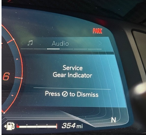

I have been getting the "service gear indicator" on my dash, has anyone had this experience?

I don't believe so, but it's possible.. not sure why it's saying to service it.. just wondering if anyone has had this indicator pop up. There are no performance issues.

"Service Gear Indicator"..

Yes, everything seems fine. It shows where the "change oil" notification displays..

Never heard of it. I searched the Service Manual I have for "service gear" and "gear indicator". Neither one appears. To clarify, you are talking about a written text message on the dash that says that right - and not s symbol? The manual sometimes spells out messages that may appear on the DIC, but not all of them, and not this one.
Its not clear what a gear indicator would be. There are displays on the HUD and DIC that will show the currently engaged gear.
The transmission has position sensors for each of the 5 shift forks - to detect any issue with fork positions deviating from the commanded position. There are trouble codes generated when a discrepancy is found. I don't think those sensors are "serviceable" at this time.
As suggested already, you'll need to have dealer check for codes or find a way to check for codes. But then you will still need to have the dealer fix it. The diagnostic procedure I found for the shift fork position errors (different codes for each of the 5 forks) is (unfortunately) quite simple. Clear the code(s) then see if they come back. If one does,replace the transmission. My manual is a 2020. Later versions have included some (but very few) additional repair procedures for internal parts, but its very limited. Its not easy to get to those sensors.
If you are not having driveability issues, you probably have a different issue. Maybe even a message that.s not supposed to be there. There are rare reports of items on a display that are clearly for a different car. That happens because some shared software will include items for multiple models.

It only shows a written text message, no symbol. And it clears once it tells me to use the "check" button on the steering wheel to acknowledge the message.

It might help if you posted a picture of the message.

There’s no codes that appear, so maybe it’s just a notification that needs to be reset. My code reader shows all clear.

When you say no codes, do you mean the CEL is not lit, or did you check with a scanner? There are DCTs that do not cause the CEL to light.
Anyway, I could not find a reference to that specific issue or DTC associated with it. There are shift fork position sensors - and DTC associated with them. They are type A DTCs and as I read it, they would have caused the CEL to light. OK - I see you did get a scanner.
