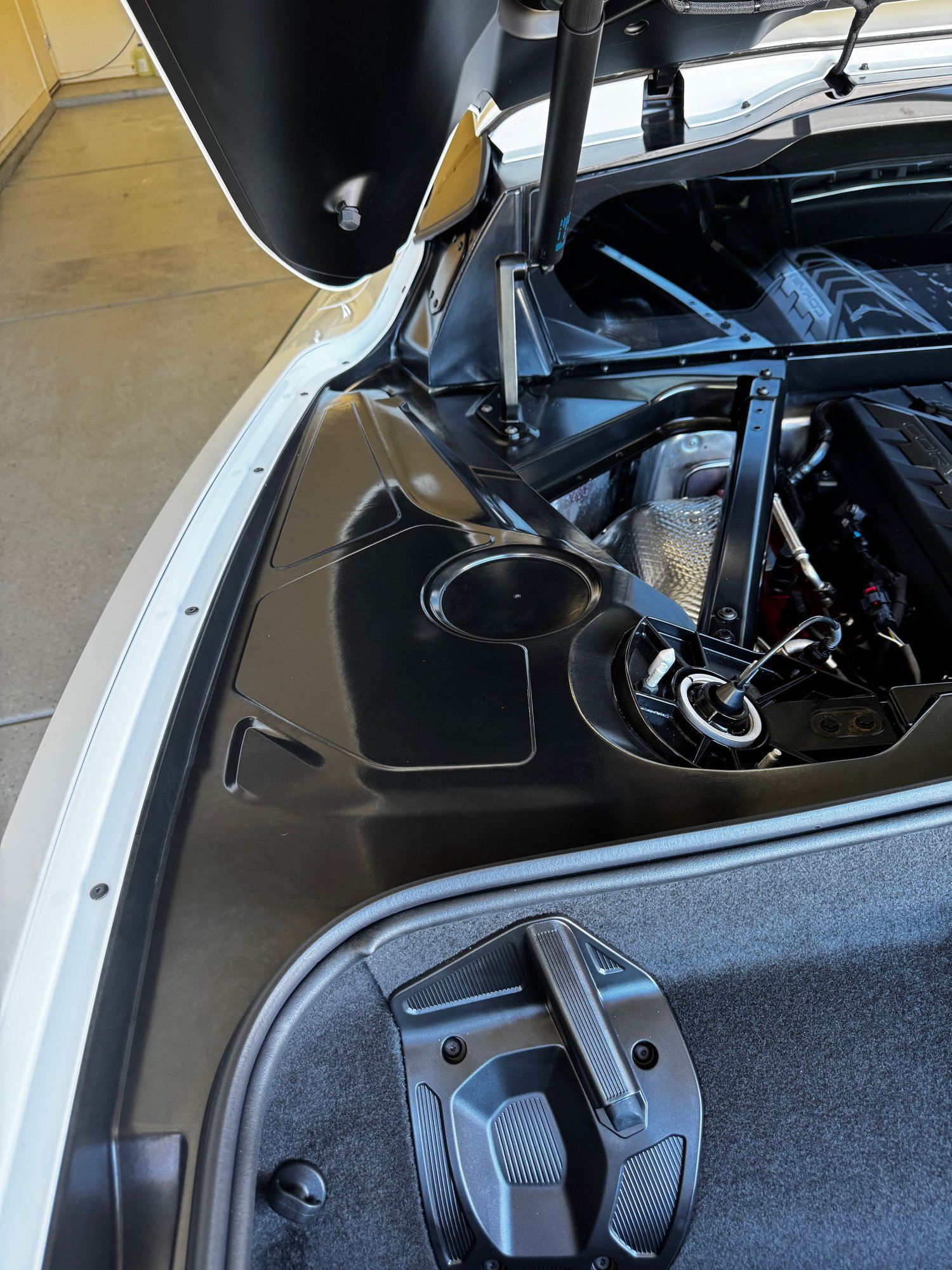

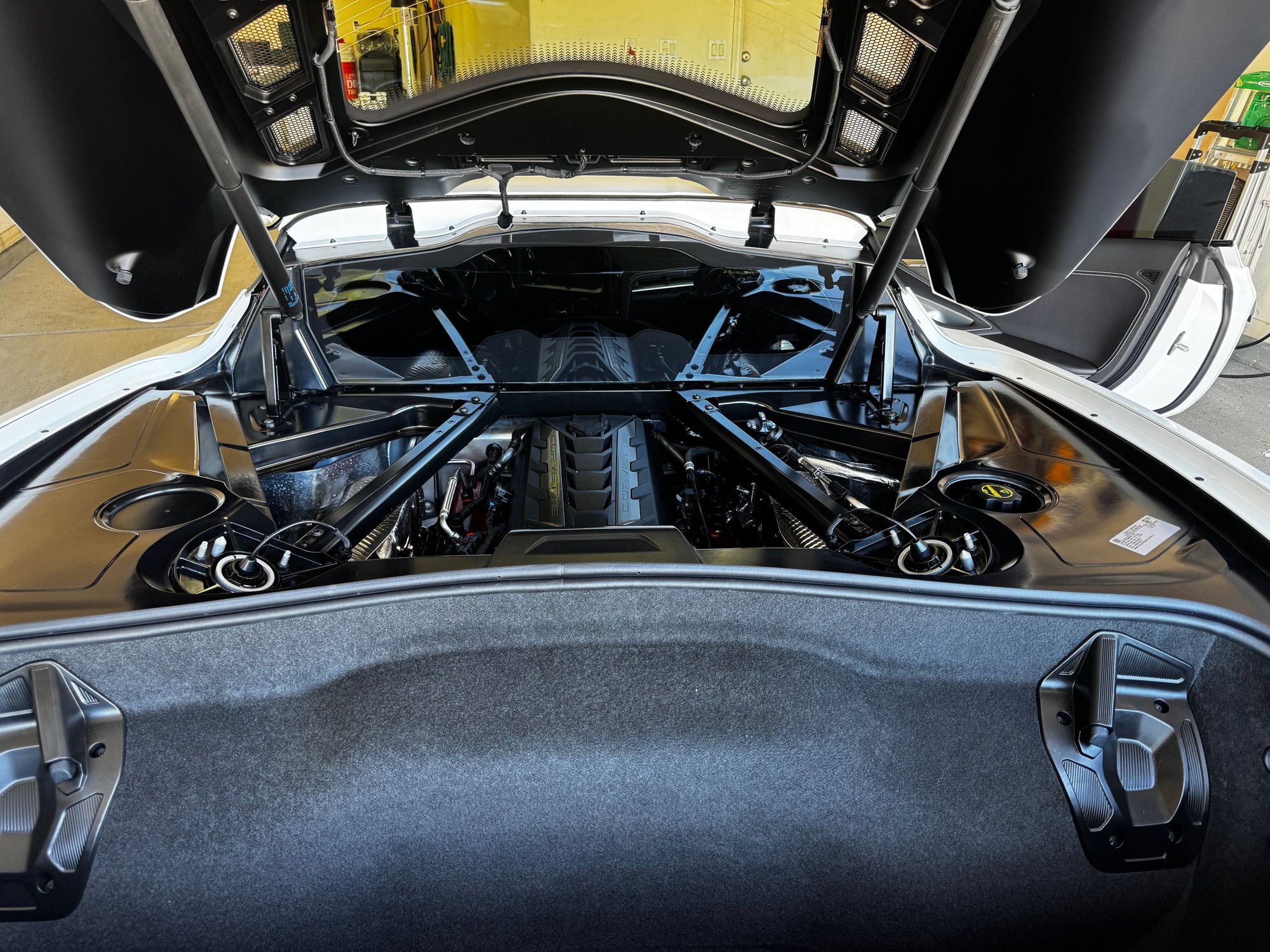

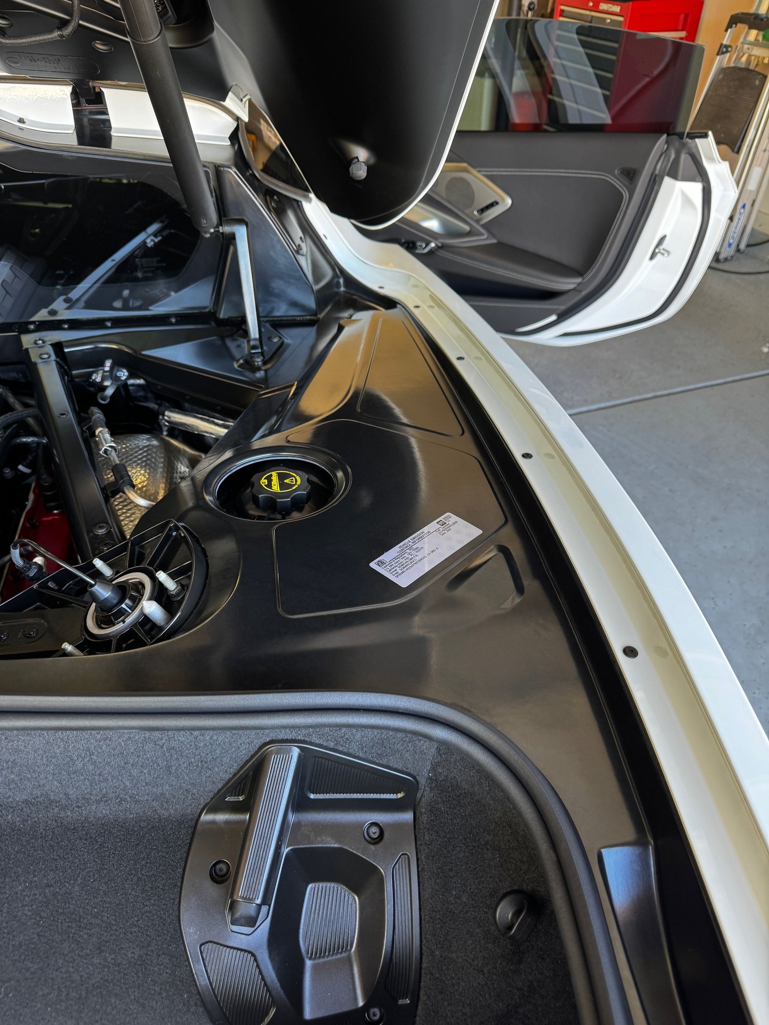

I've seen a number of posts about cleaning up the Engine Bay black plastic (technically a fiber) and wanted to share my success working on my today. I'm very pleased with out it all turned out. I used the Meguiars Ultimate Compound with an Orange CCS pad with my polisher. Had to do by hand in some of the tighter areas where I couldn't get my polisher. I then did a pass with a finishing pad and Polish. Lastly, I coated with GTechniqu C4. Happy with my results and hope it helps some others.
