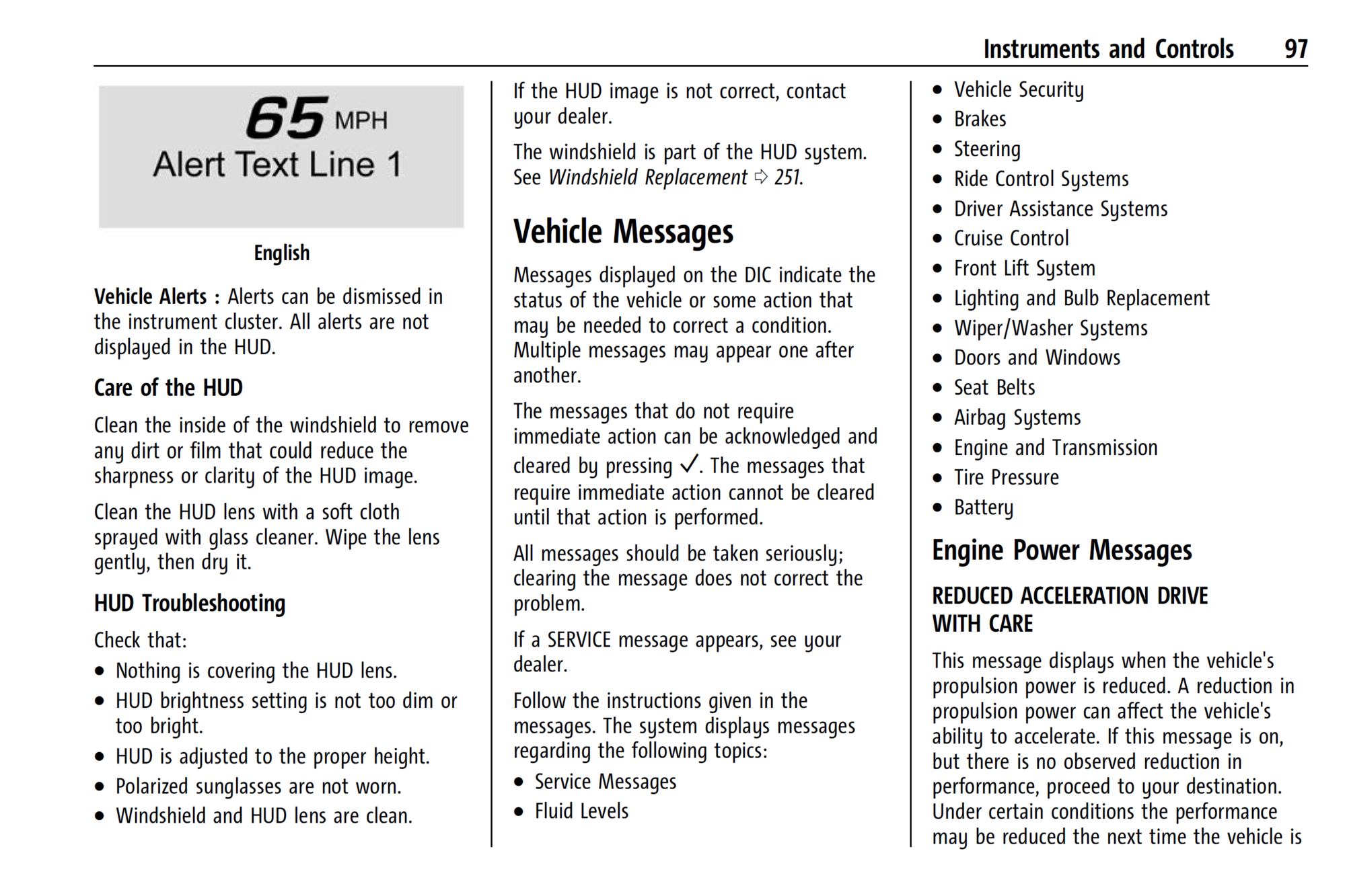

It already keeps a running estimate of the SOC of the battery, so it could provide a display of that. The Owners Manual claims that it will display "Service Message(s)" regarding the battery.
