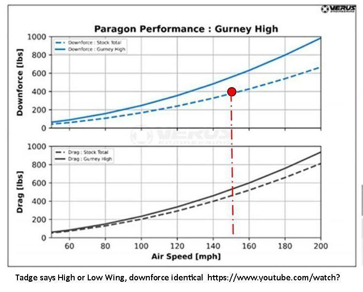

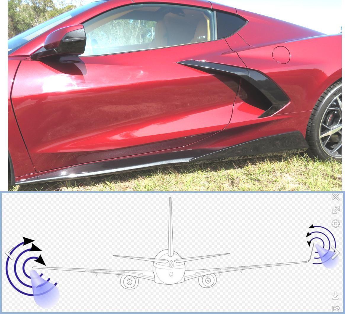

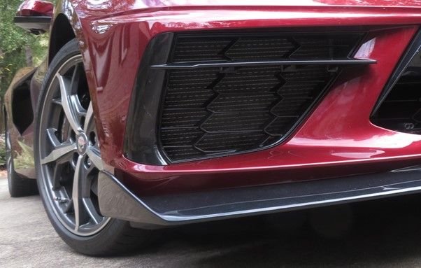

Sure the 5VM side skirts and splitter are functional, IF TRACKING, WHEN AT Speed.
There was a very good article re the C7 Aero by the GM Chief Aerodynamicist, called Like a Knife. Bednarchik points out that while shapes for improving fuel efficiency typically begin to have an effect at highway speeds, lift and drag components become critical from 150 mph to maximum velocity. BUT aero is NOT intuitive, why F1 teams pay big bucks for specialist and millions on computer programs and actual wind tunnel tests all season long!
The above video is good but surprised it did not comment on the front 5VM versus the standard Z51 splitter it discusses (it did say longer would help but no mention of Winglets.) Winglets, which are on almost all passenger jet airplanes are on both the 5VM Splitter and Side Skirts (not for looks!) They help increase downforce without adding drag. On a Splitter they essentially increase the wing length as the high pressure area on top otherwise spills over to the lower pressure underside making the wing less effective. Side skirts increase the low pressure underside area, the C8 underside aero panels help create. On both that have some help directing air around the high drag, open wheel wells.

Effectiveness is all dependent on speed. These are downforce and drag numbers from Paragon for the OEM Z51 wing and theri Gurney Flap add-on. Their info is usually pretty good.
Some think GM, Ferrari etc add Winglets for looks-nope they are functional. The first patents were in early 1900reds for bi-planes! They essentially make wings longer by not wasting the ends that dump high pressure air from the high pressure top to low pressure bottom. Airlines quote 3.5% better fuel economy! Nope they are not added for looks!

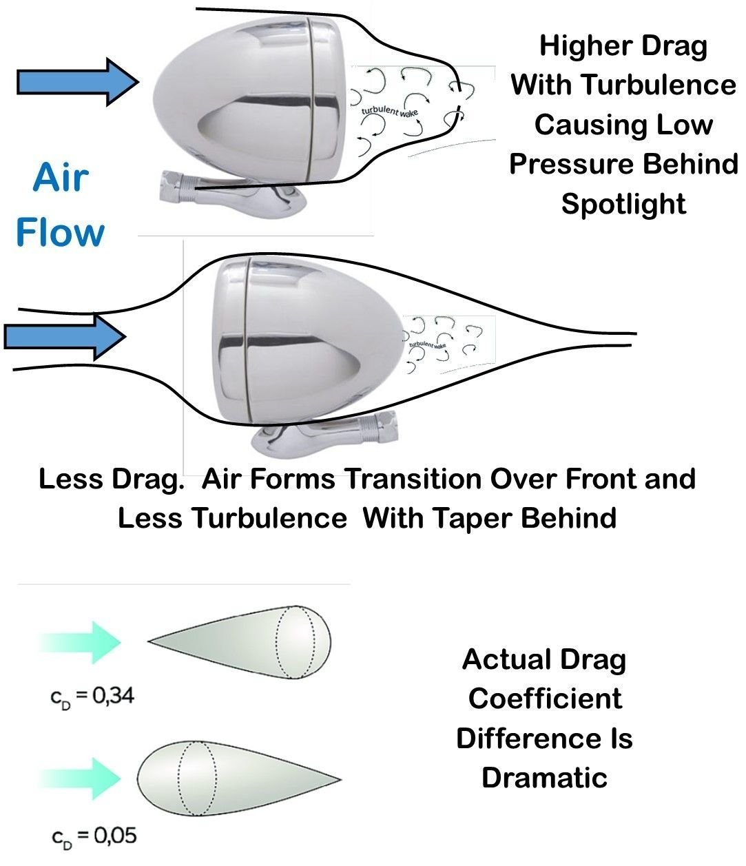

Aero is NOT intuitive! Recall many years ago in a fluid flow class being surprised that facing spot lights with bullet shape forward (as we did in Custom Cars/Hot Rods was more drag (can be considerable) then with flat front facing forward!
