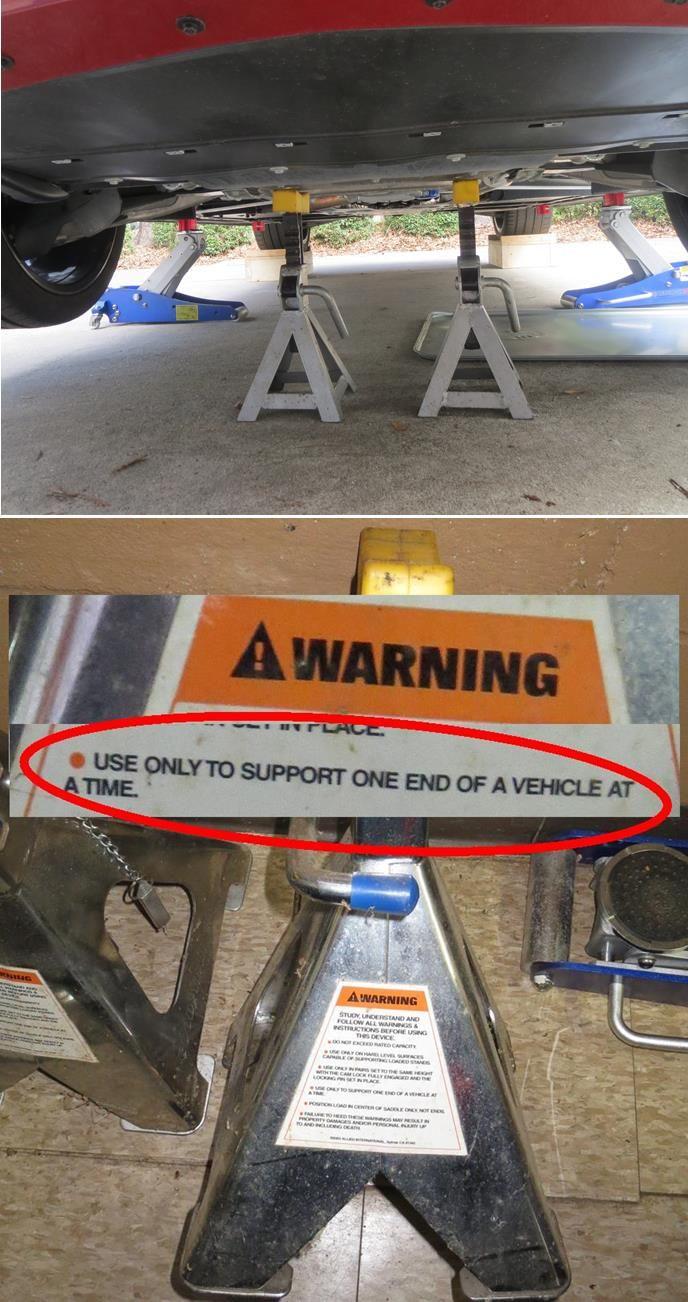

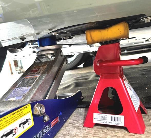

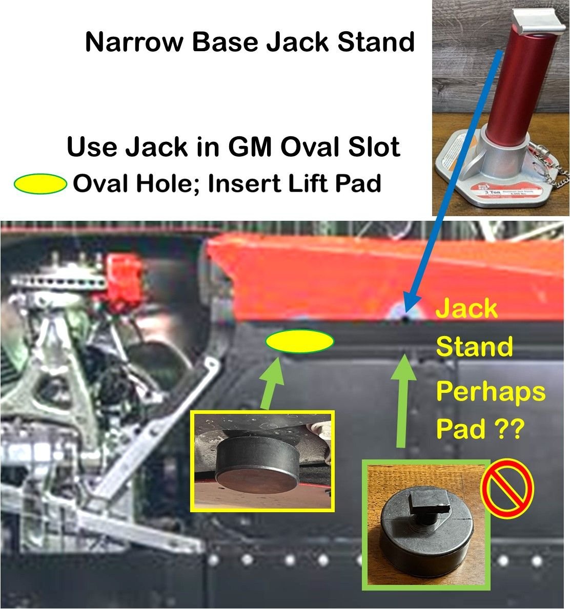

Here are ways folks have done. including me. BUT I would never get under a car on 4 jack stands. In fact have a warning on a pair i have! Would not fit what my Dad made me do from when i was ~10 when we worked on cars. Had to put the frame on our equivalent of Jack Stands (in the 1950's)and he made me hit it hard with my shoulder. he would say IF it's going to fall NOT with you or any part of you under! Here are some pics:
Note Warning! Only use Jack Stands on one end of the Car at a time! Smart!
This works fine for the front as no Teeter Totter balance issue.
This has worked for me when changing the rear tires on my E-Ray. Just be careful jacking and only rear to avoid. Place small base jack stand close to GM Oval lift slot with jack. Be sure you are on frame.
Have changed brake pads on my 2020 C8 Z51 BUT only one end at a time.

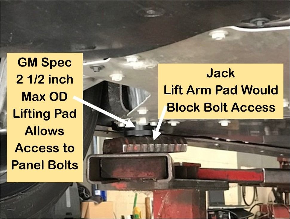

Have been concerned with C8 falling and posting info, like others, and saying can't use jack stands from when I got my 2020 C8 Z51.
All started with this Pic of a 2020 C8 that fell!
Even occurred a few years later with this C8 Z06
After considering the Pics of fallen Vettes and where the average tech might place their post lift arms with large pads IMO it's as likely they tried to lift on what looks like a good spot. The large area I marked with the Red Triangle. It's NOT the frame. Heck even a Pro Tech like Chuck (where Conti is a salesman) is not putting his head on the ground to find the Oval Lift Slot! Why I give the Tech who works on my cars my 4 jack pads so the very large pads on his center post lift don't just contact in the Red Triangle Area! He always uses!
Good example where my Jack Pads help my tech gain access to the 4 outer bolts on the aluminum aero/shear plate!
